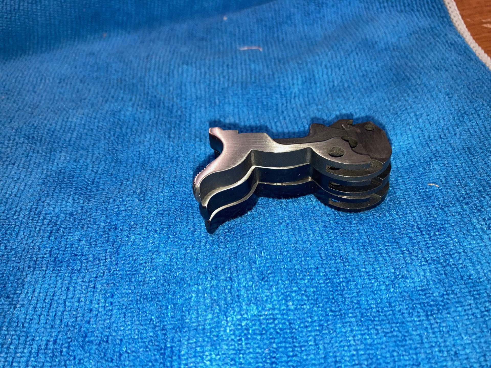

I can't remember where I read it, but it said all conversion kit hammers were the same size. I have a BH conv kit and a SBH kit. let me go check and I will be right back with you.
Apparently they were right. Bottom is out of kit marked SBH, middle is out of large frame kit, top is out of mid frame. Beats me.
What would be correct for a 1972 .357? I've got one not converted and plan to keep it that way but maybe should get a kit and have on hand for whatever reason down the line. How do I find out what I should get? And what should it cost me? Thanks!
Unless the BH kit is a mdi frame kit (you can tell by comparing the lengths of the cyl pins), the hammers will be the same.
Well, Hondo, page 94 of Jerry K, Ruger SA manual says what you said, all large frame conv. hammers are different from med frame. They also have a different part #. The misinfonet strikes again.... I apologize about the misinformation. So now I need to figure out what hammers I actually have with the kits.
