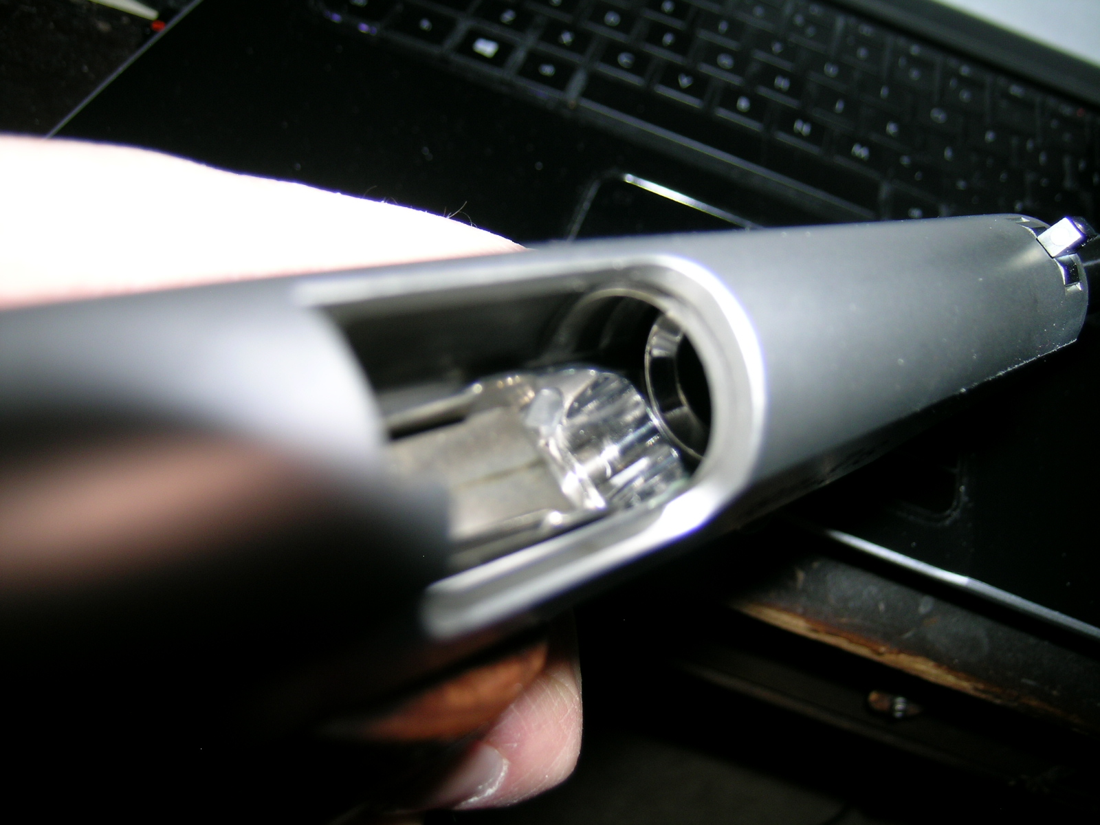

I am putting this tip here in case some owners never look at the gunsmith section. If you semi auto shooters have jams once in a while check felt tips like the photo. Hand drill, some polish like Flitz, felt tips and a little time. A lot of YouTube videos on how to.
I have a much loved Glock 36 that very occasionally would not feed a hollow point. About 20 minutes of my time to polish ramp it is now 100% reliable
(After 600 rounds so far)
Good advice, I have had customers bring their gun(s) to me and tell me they don't feed reliably. I first look at the feed ramps/chamber area for any maladies and most of the time I find things that they never see. I clean the ramp and such and then polish them. They've never had a problem after that. But, many people just do not want to do maintenance like that to their firearms because they've never been "shown or trained" to do that or they know they just do not have the ability or the tools.

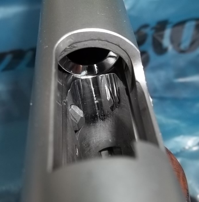

The problem with using a rotary tool is you are going across the ramp. The same direction as the factory tooling marks.
You might make it shine like a mirror but the factory lines are still there to some extent. You polish the highs and low spots and make it wavy instead of sharp lines, which is an improvement, but not perfect.
If you want it perfect and are patient you can do it by hand up and down the ramp. So any microscopic lines are in the direction the bullet travels.
Best practice when polishing metal is to go in the opposite direction with each grit change. You go until the old lines are gone, then change grit and direction. This gives you a flat surface.
My point is the rotary tool is the good enough shortcut. It is not the best way.
Sometimes the hobbiest can take their time and do things right and achieve a level the factory can’t achieve.
Your elbow grease is free, paying for someone else’s elbow grease is expensive.
This knife blade shows the principle. The factory lines go across. My lines go the long way. The blade appeared flat until I went the opposite way, now you can see it wasn’t
Again I’m not dissing the rotary tools, I just don’t think they should be viewed as the best method.
