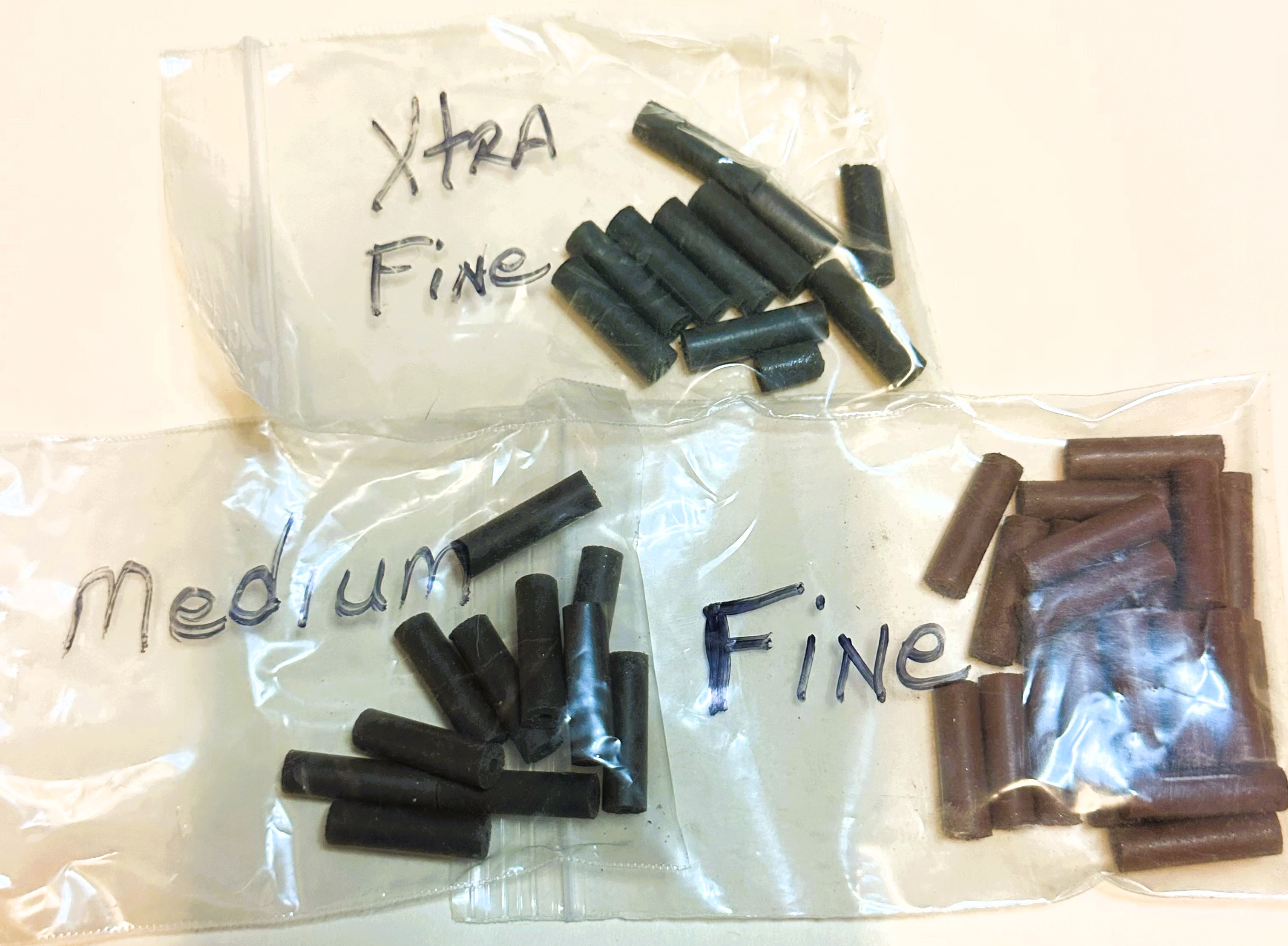

I have been polishing ramps on M1911's for 40+ years. I learned a long time ago that the stone tips for dremal tools are to abrasive. Much better are the rubber polishing tips. The accompanying pictures show these. The screw onto a mandrill for a dremal tool. These will polish the feed ramp to mirror bright in just a few minutes. Have polished several hundred guns for folks with all being "Happy Campers" when I finished their ramps. Have a couple of hundred stones stuffed into a junk box that I have accumlated over the years in different kits, they wont be used on any guns.
