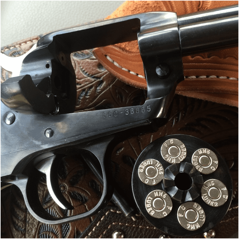

You'll need to slightly enlarge the bottom of the loading notch for the larger .32 case to line up with the chambers for loading/unloading. Installing the Free spin cylinder pawl from the Ruger Wrangler .22 Or Power's Customs pawl will really improve ease of loading. I just modify the regular pawl to free spin on all my new model .22s and .32s.

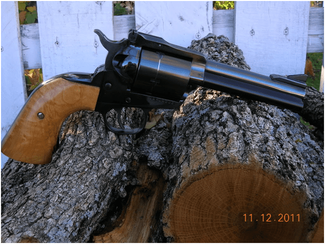

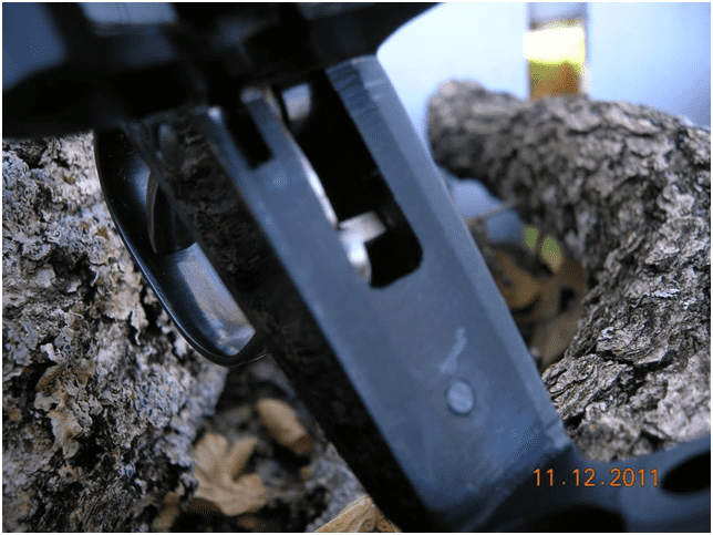

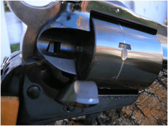

A friend wanted a 32/327 mag old model. The old model .22 cylinder diameter and cylinder window is about .008" smaller than the new model .22. The .32 cylinder rubbed the bottom of the frame window so it had to be filed/stoned for clearance.
I also reamed the cylinder to chamber the .327 Federal Mag. After speaking with a few custom builders, they had no concerns about the 6 shot 32 H&R Mag cyl strength reamed 1/8" deeper for .327 use. It is true that all the 'professional' 327 conversions use a longer new made cylinder that fills the cyl window with no barrel protruding thru thru the frame. If you can find a Ruger 7 shot .327 cylinder so much the better. Just adjust the barrel cyl gap.
However, the 32 mag cyl reamed to 327 will work: Factory loaded .327 Mag cartridges are only ~.003" longer than the factory 32 H&R cylinders. So originally I thought I'd have to run the factory loads thru my seating die and seat the bullets a couple of .001" deeper in the case, but didn't have to. Believe it or not they function perfectly by taking advantage of the barrel/cylinder gap spacing. I know it might be counterintuitive but as they say, truth can be stranger than fiction. Even though the .327 Fed mags in the 85 Gr HP Hyrda shock and 100 gr HP loads are longer than the .32 H&R Mag chambers, the ~ .005" bar/cyl gap is sufficient for the loaded cyl to rotate w/o interference.
I agree with the Professor, Just buy a .32 mag. The only reason I made the conversion was because my friend wanted an Old Model in .32/.327 Mag. He doesn't like the new model actions.

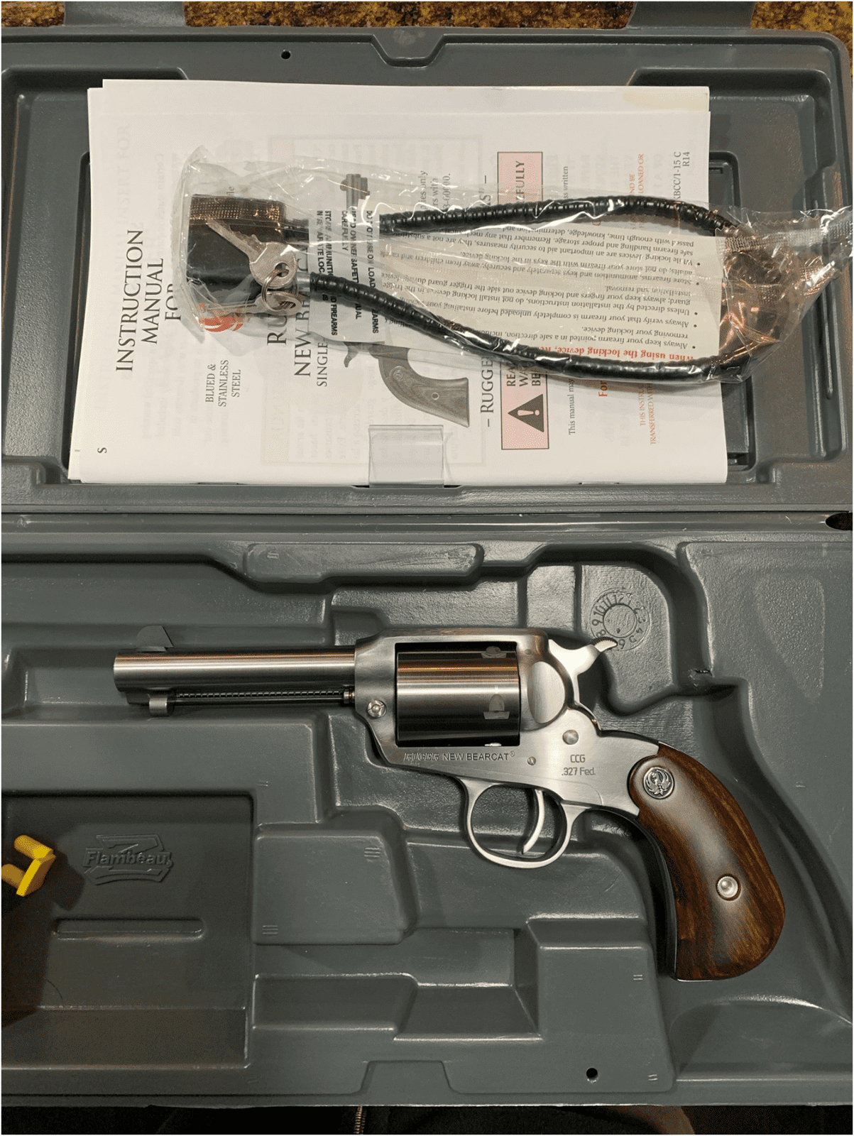

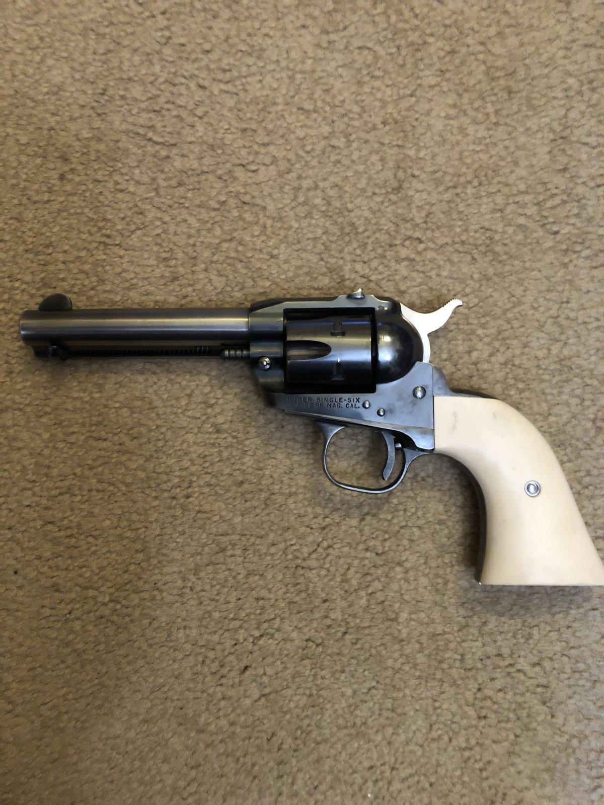

Yes I have been asked. Those conversions have all been done by well known Ruger smiths. I'll post photos next time I'm home of single six/Bearcat .38/.357s.
They're not difficult to do but require machining and making custom cylinders. The set up for machining, making jigs, etc., requires a lot of time. So making conversions like that are too time consuming to just do one or two guns. I have to leave that to the professional smiths who will do several of those and can charge enough to be reimbursed for their initial time investment. I only build guns for friends and not charge them except for parts.
So I stick to parts changing, barrel/cylinder swaps and sometimes require only small modifications or micro welding to adapt Ruger parts to old models, etc., like Bisley triggers. Things gunsmiths don’t or won’t do.
