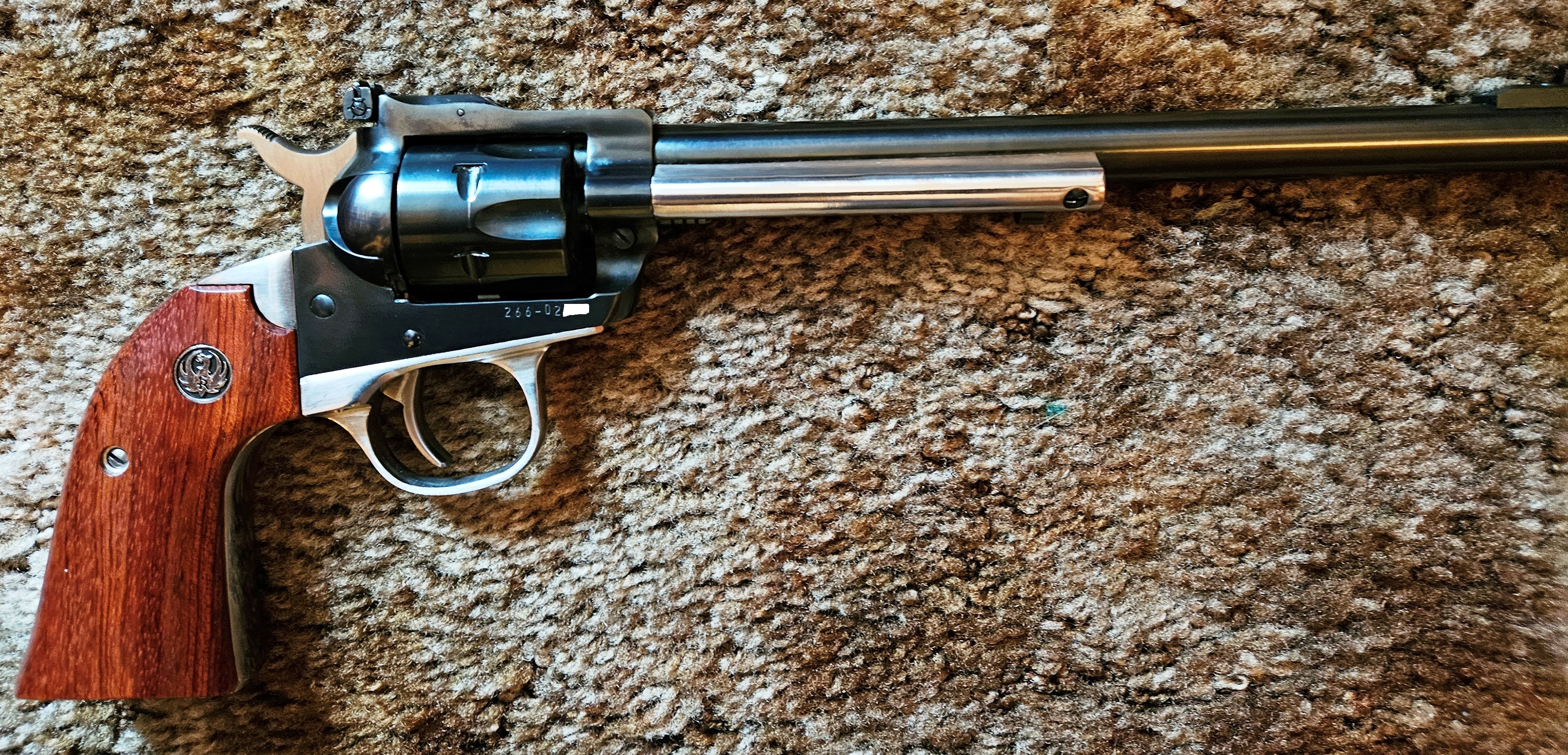

Here's a recent Bisley conversion of a Mew Model Single Six Longneck.
Thanks to RatCat454 for the grip frame.

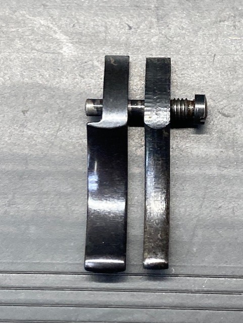

YES, as posted above, what you want to do works fine. Have you considered using a wide trigger?
Also just FYI: You can use a wide trigger in a Blackhawk grip frame with narrow trigger opening (which is an old model grip frame) without widening the slot.
-The old model wide trigger is not wide all the way up into the frame.
-just trim the wide part of the trigger a little lower from the narrow top to where the narrow part extends down thru the trigger slot.
-round the edges on the back edges of the trigger where it was thinned.
-before installing the grip frame, install the trigger spring and plunger in the hole in the rear of the trigger guard as usual.
-install the trigger sideways thru the top of the trigger guard slot,
-then turn the trigger 90 degrees to its proper position, install the grip frame, and install the trigger screw.
Used an Old Army trigger to replace a Single Six skinny trigger in a New Model (wide slot) Birdshead gripframe.
Did that because I dislike those skinny (and offset to the left of center) factory OM triggers. (I blame Colt for such nonsense.)
