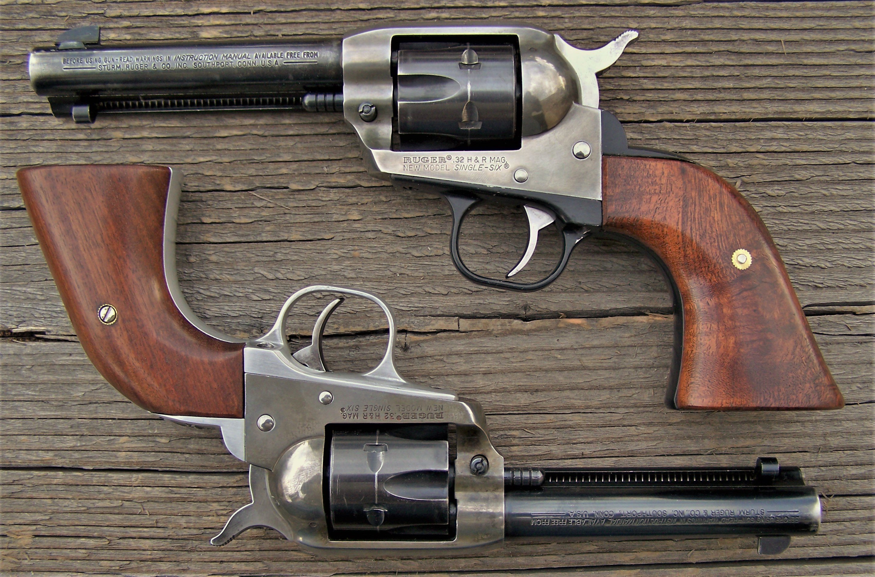

Welcome to the Forum! I polished the alloy frame and ejector rod housing on my Single Six. It was drilled and tapped for a scope so any collector value was already gone. I like the two tone look. And then there is the factory "reverse" two tone, Blackhawk .327 Pinto which I had at one time.

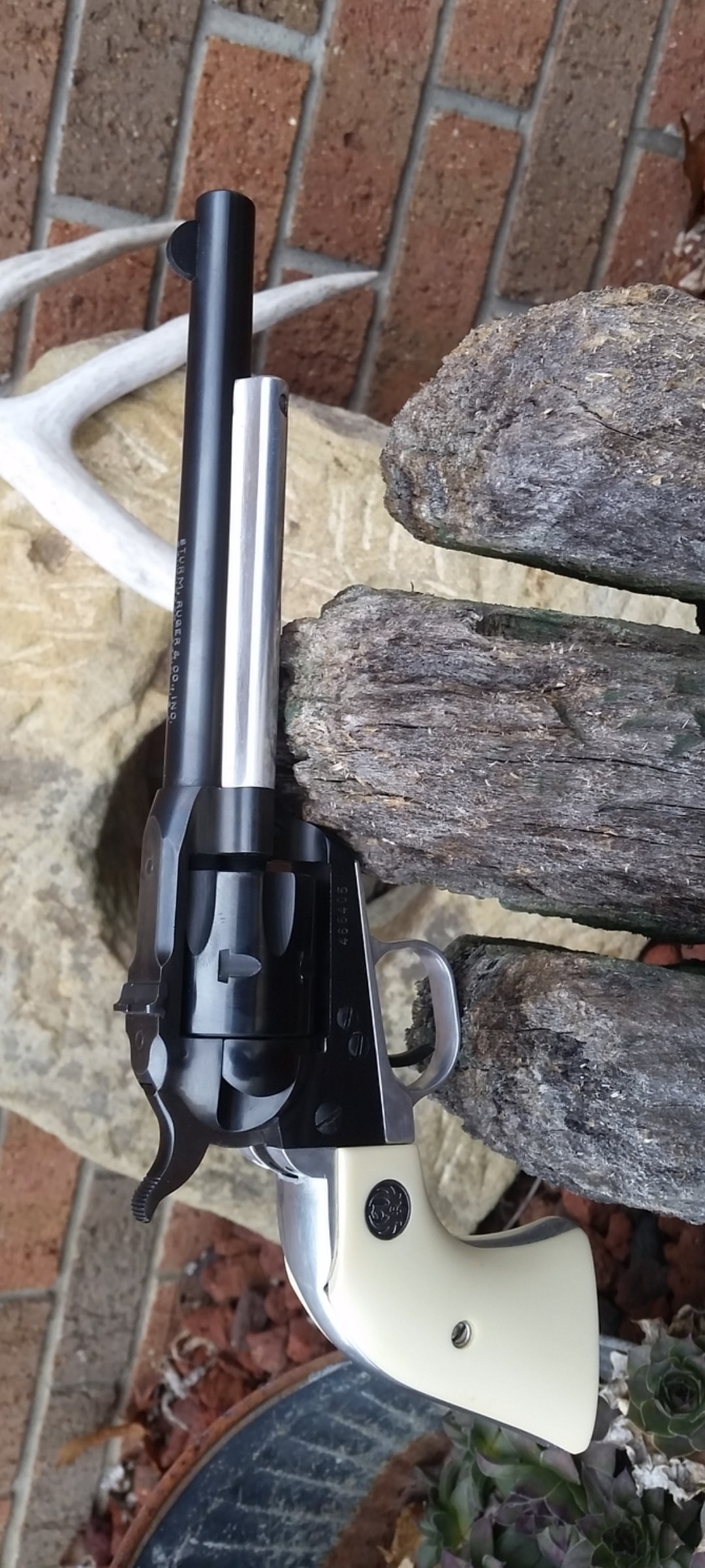

This Blackhawk started life as a .357 Mag. stainless 4.62" plow handle New Model.
I bought it used, it was cosmetically flawed with some rust pits. (stored in a wet holster or gun case or perhaps blood spatter)
I wanted a "tractor" revolver, and what it looked like was of no importance to me.
If it got wet or muddy, it simply didn't matter, it isn't a "safe queen" or even close.
Mechanically, low round count and great timing, end shake, and b/c gap. (with both cylinders)
I sourced the used blued 9mm cylinder and the used pre-fitted Birdshead hi-polish grip frame here on the Forum.
The pictured grip panels are factory black micarta.
I installed the two used parts myself here at home. The cylinder required a visit to my metal lathe for proper fitment.
After fitting the cylinder, bare steel was evident and I shipped it out for Mil-Spec Parkerizing.
I haven't had the .357 Mag. cylinder in the revolver since fitting the 9mm cylinder.
If I need more "power" in a revolver, I will grab one of my .44's.
I do like the Birdshead grip frame for the "tractor" revolver, the rear/lower corner of the grip frame doesn't dig into the tractor seat unlike the OEM plow handle grip frame.
IMG_20250326_123900903_HDR by cee_Kamp 32ACP, on Flickr

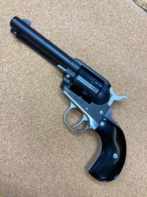

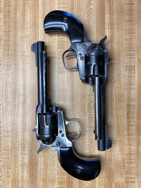

When the Wrangler came out, I got one for the daughter. She preferred the birdshead grip (I installed one on my OM Single Six). So, I modded a Wrangle for her. Stainless grip frame, with stainless pins, ejector rod, and base pin latch. Just enough Bling without looking gaudy.
She eventually bought an OM Single Six and had me build her a clone of MY GUN and gave me the Wrangler back. What to do with it now?

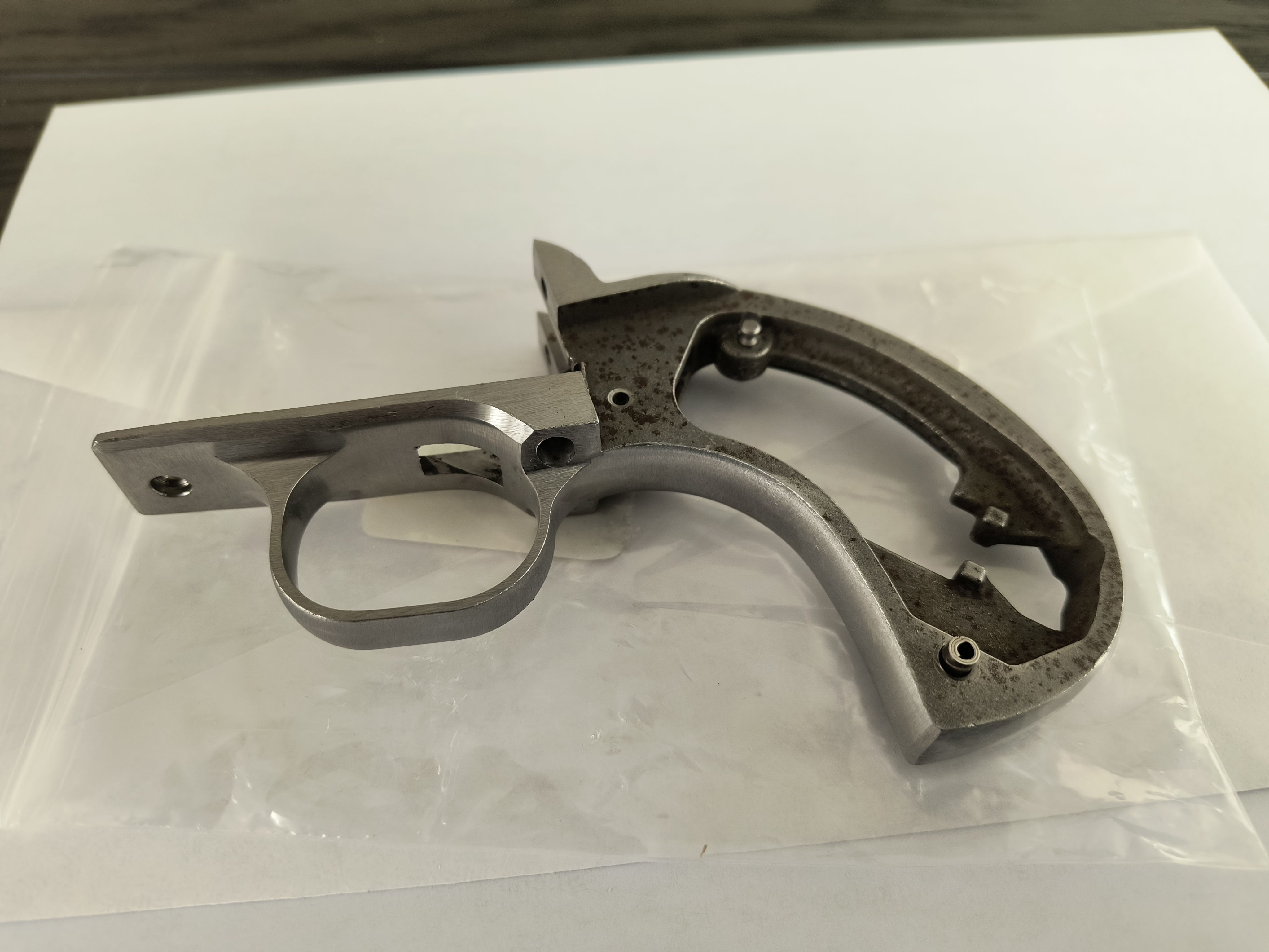

I ordered the steel in the white grip frame

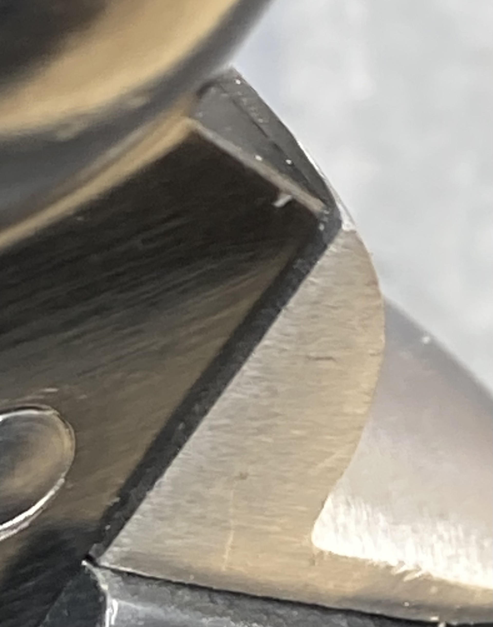

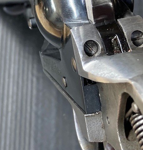

I'm undertaking a "new" gun project, and I'm installing a birdshead (the same as you) for a shooter grade blued NM (early '70s vintage). I don't know if you've fitted a grip frame to gun frame before, but I've done about a dozen or so. I hope you're aware that the grip frames from Midway are rough castings and not finished or fitted to your particular gun frame. The mounting holes should line up but the sides of the grip frame and tops of the "frame Ears" probably won't. Example is in the attached photos. So, with some patience, attention to detail, and some draw filing and sanding you should be good to go.

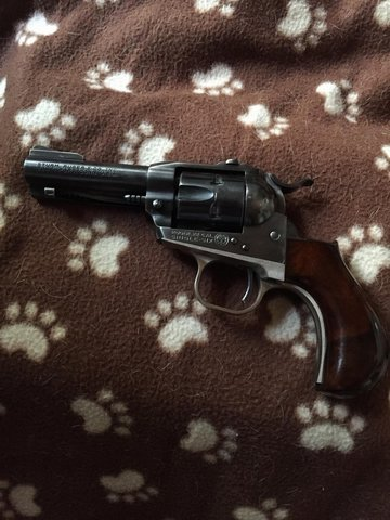

I just finished a Single Six conversion to stainless Bisley. I think it looks cool, but that's just my opinion. You'll have to decide for yourself.
It was a new unfinished part. The fitting and polishing was not too bad.

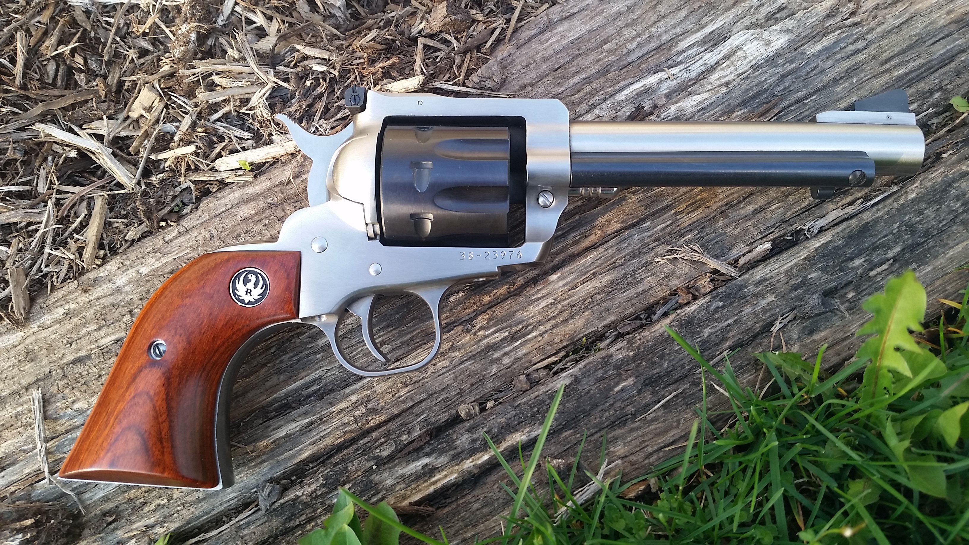

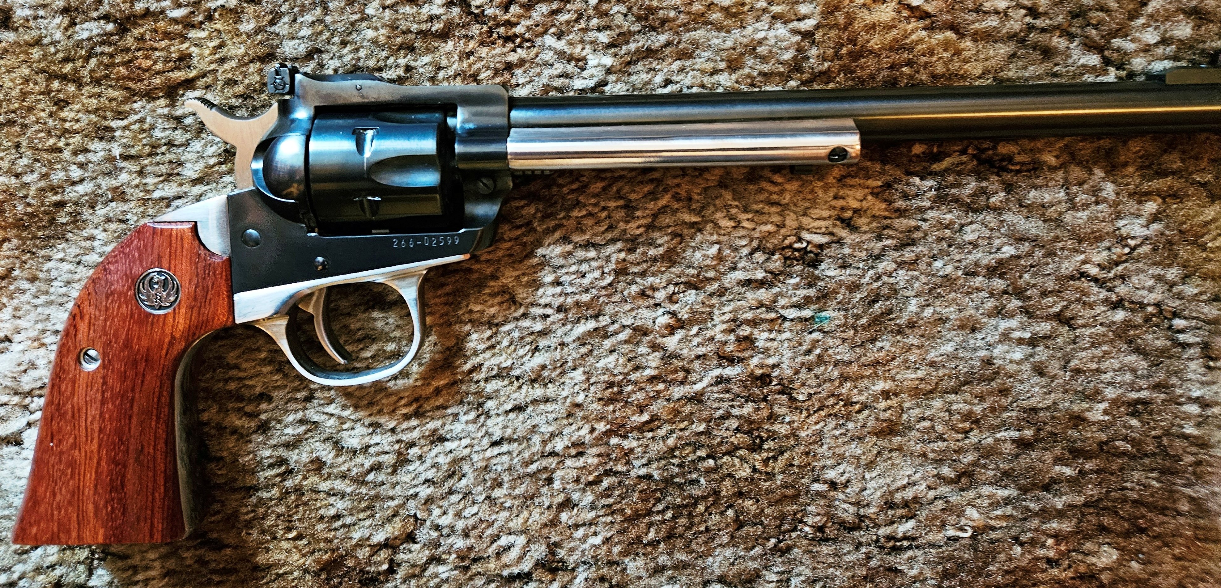

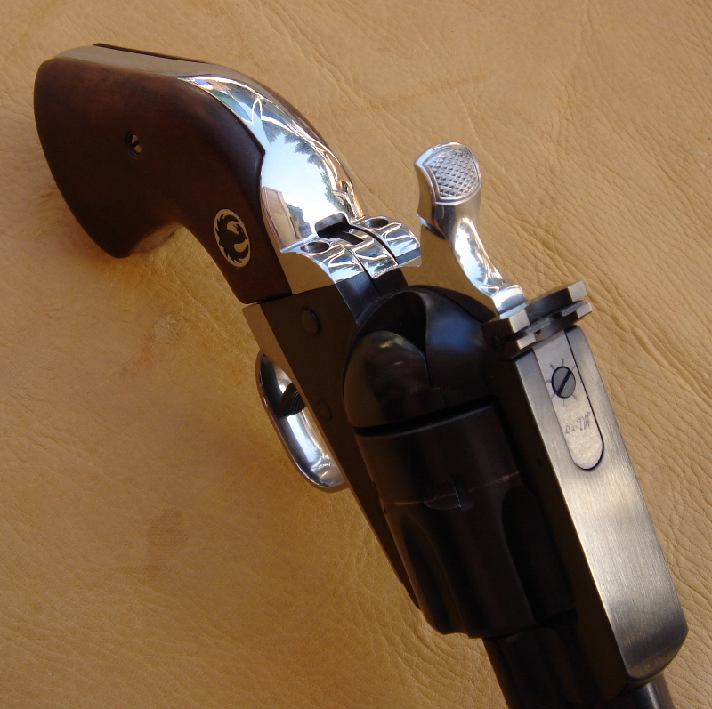

Buy the carbon steel, fit it and polish it bright. It will look exactly like polished stainless steel. Then you have the choice to blue it or or just leave it! It will never rust.

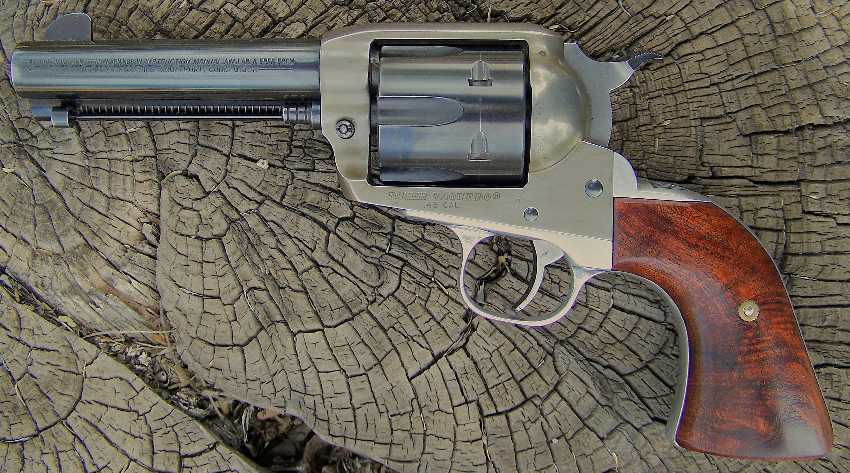

Carbon steel frame polished bright 10 years ago:

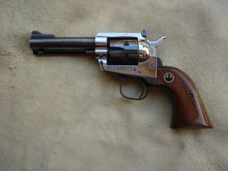

Carbon steel grip frame polished bright 6 years ago:

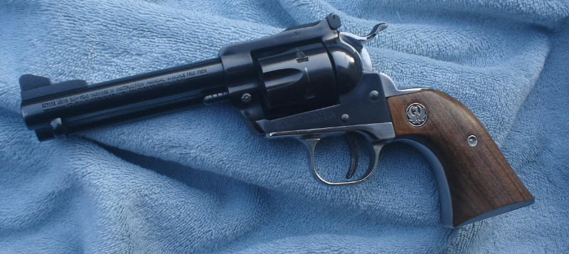

NM Flattop .44 with polished carbon steel grip frame 5 years ago:

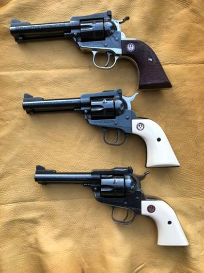

3 NM Single Six 32 Mags; top w/polished carbon steel or it might be stainless, can't remember (8 yrs ago) w/o taking the grips off:

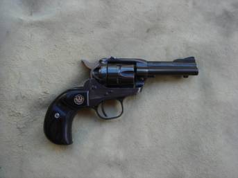

OM 3 screw, blued steel Birdshead:
