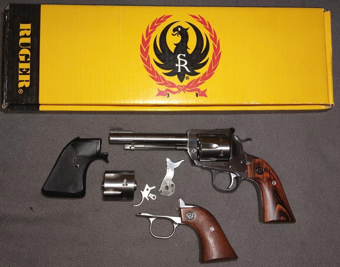

RW is your answer with what ever you want to use,,, Gripframes, Triggers, Hammers, he now has ALL the bases covered and you know the quality!
Here is a NM configured Bisley Grip Frame, made by Qualite, ONLY in NM configuration and no longer available but,,, RW can get you one very similar and way better accurate manufacture…. with a Super/ Bisley hump Hammer in OM configuration, with a OM Trigger using a NM a Trigger Return Spring,,,, and this gun has never been as smooth/ crisp, a pleasure to operate.
I really like this,,, a OM Bisley, well curved, wide fully fill the trigger window of a NM Bisley GF, with the spur to be able to use a NM Trigger Return Spring. Really well manufactured and finished. The Trigger used in the gun pictured.
To answer your questions,, yes, you have options.
And as several have mentioned,, Ronnie can supply you with whatever you desire.
OR,, if you prefer a Ruger NM g/f in stainless,, as noted above,, a very simple trigger return spring adapter can be easily made. I can show you how if you wish.
Of the Ruger OM g/f's,, the Super BKH is steel or you could get an OM brass g/f as well.

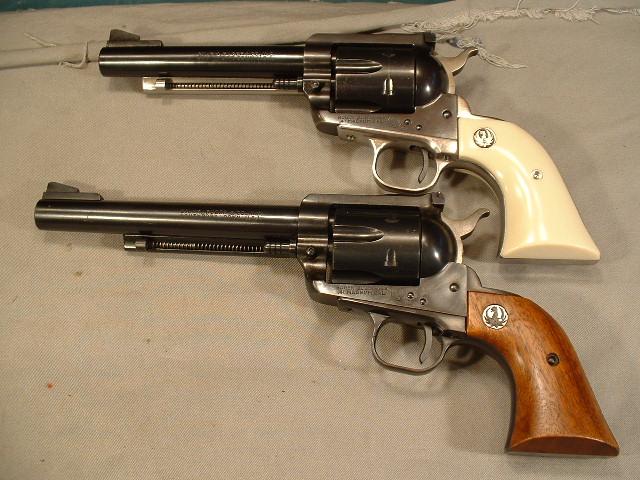

Grip frames/grips are highly personal and what works for one may not for another. I think we all know that. I really like the aluminum XR3 and have them on several of my OM’s. Trading a 9mm of any type for an OM 41 mag would be a no brainer for me.
