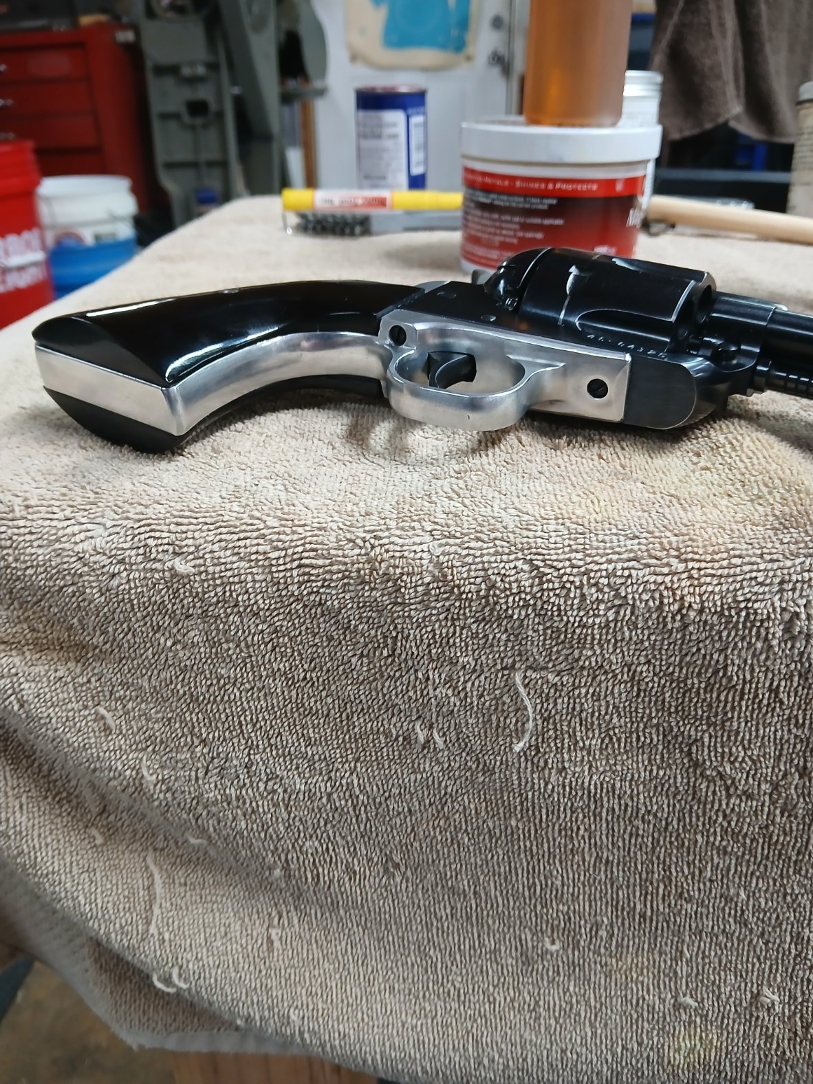

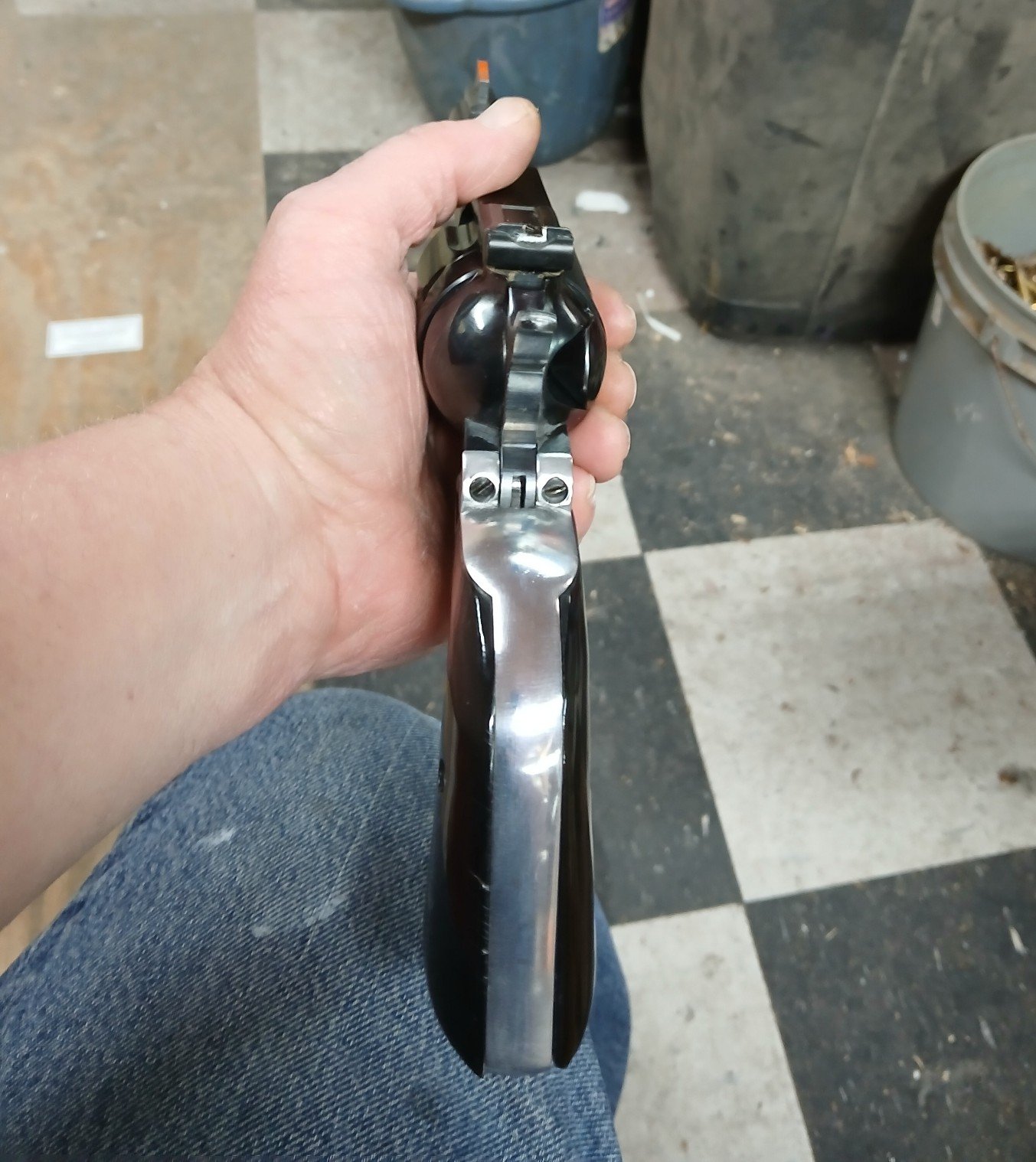

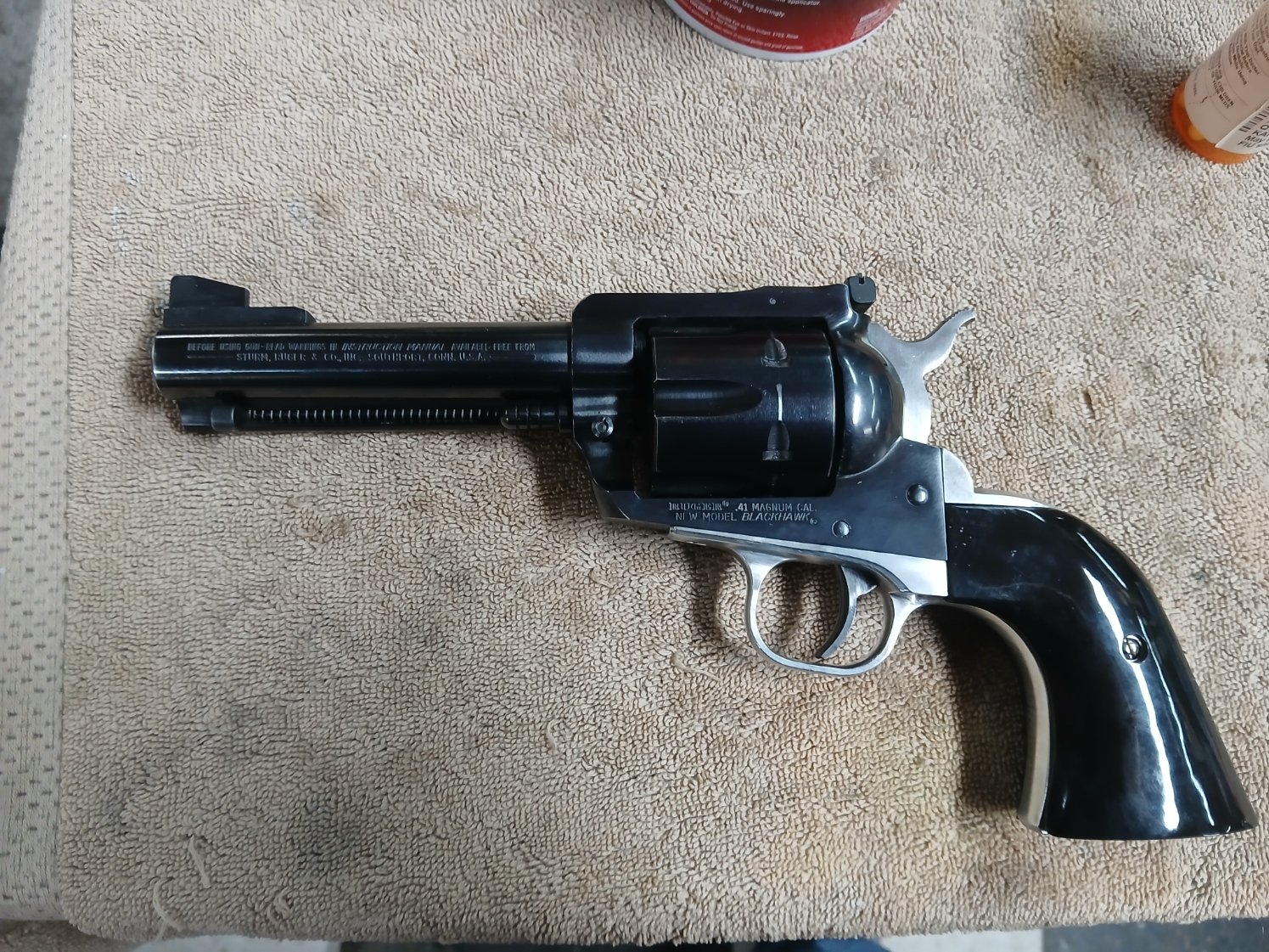

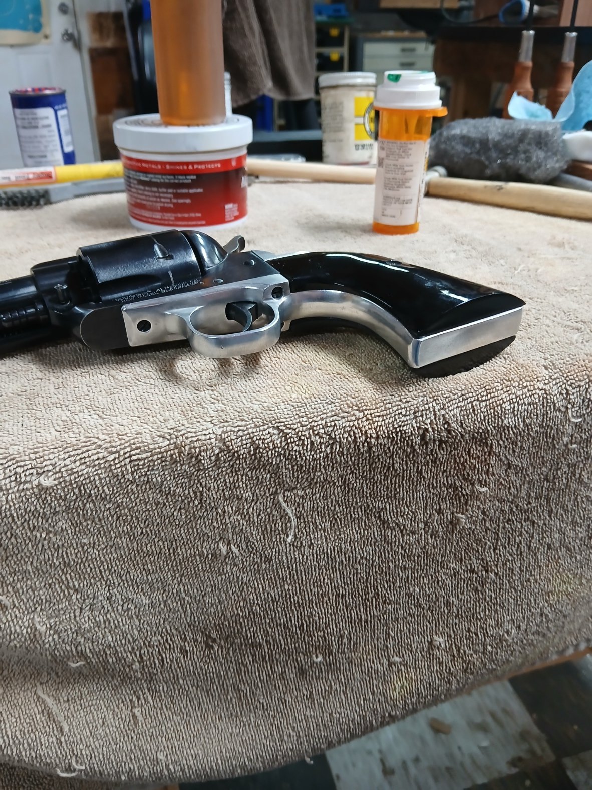

I have always liked the look of a two tone gun and so I had these buffalo horn grips, so I did my first strip and polishes. What do you all think?

I polished it with mothers aluminum polish time will tell if that works. But it sure made the grip frame shine.
