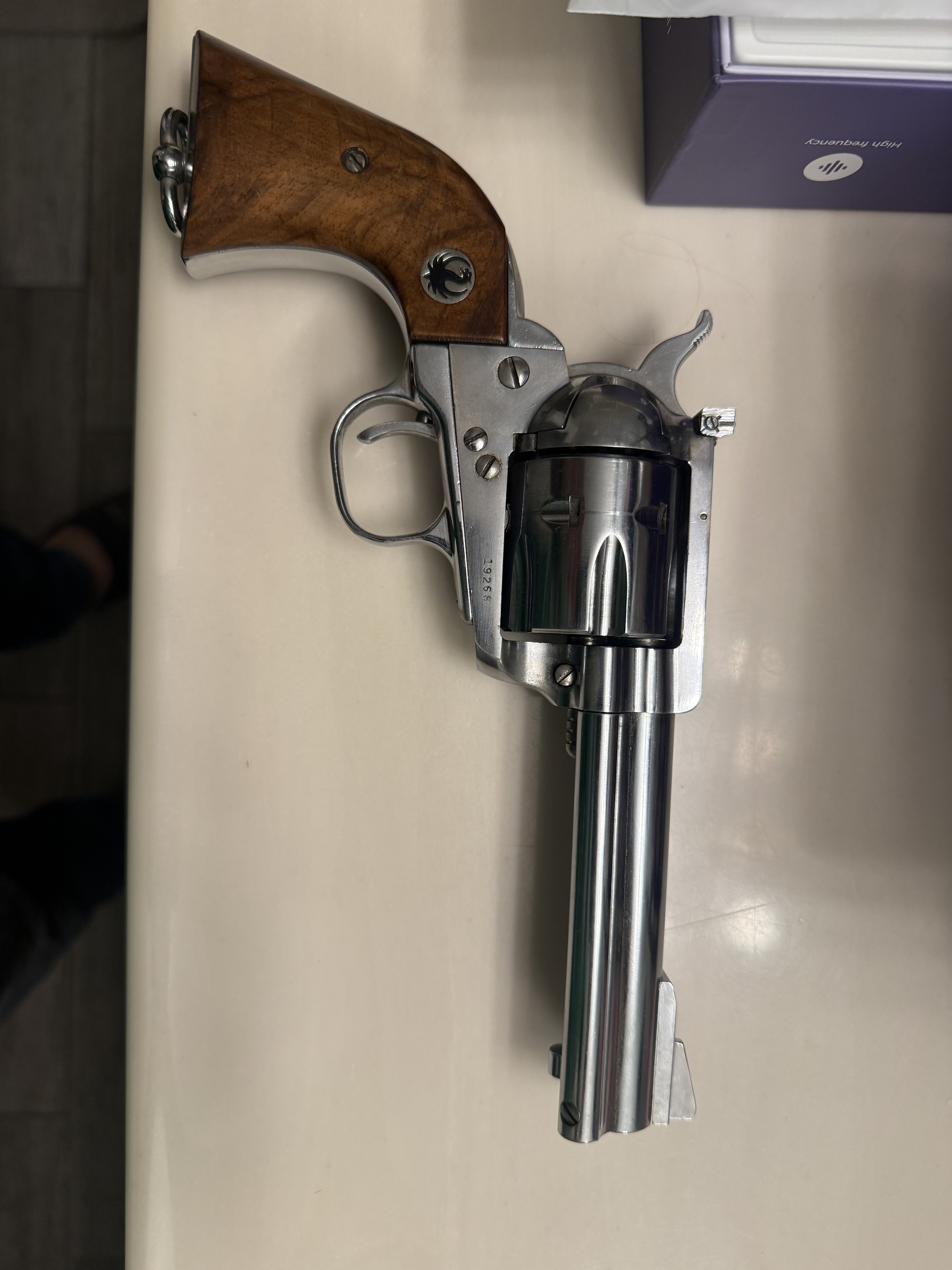

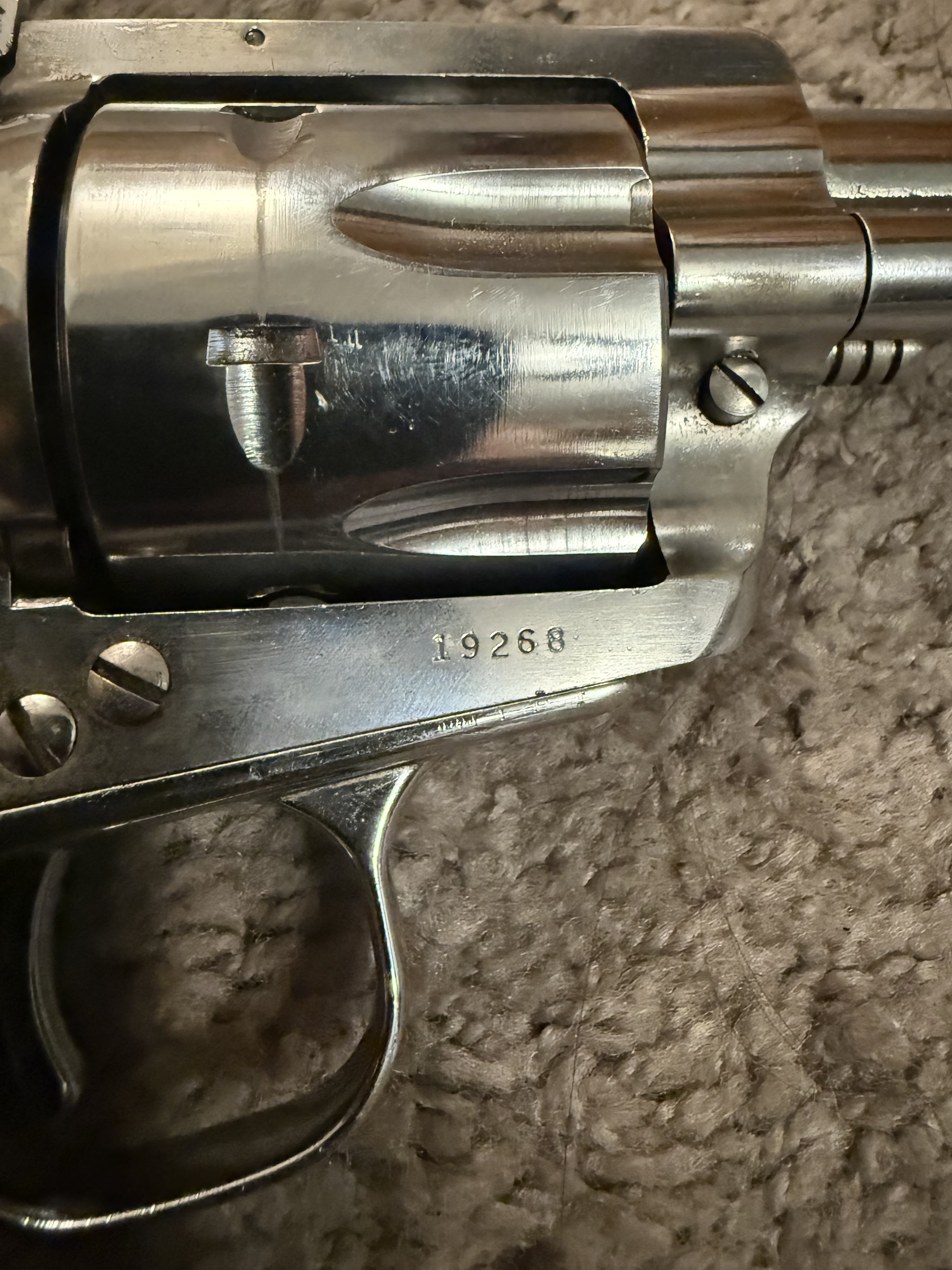

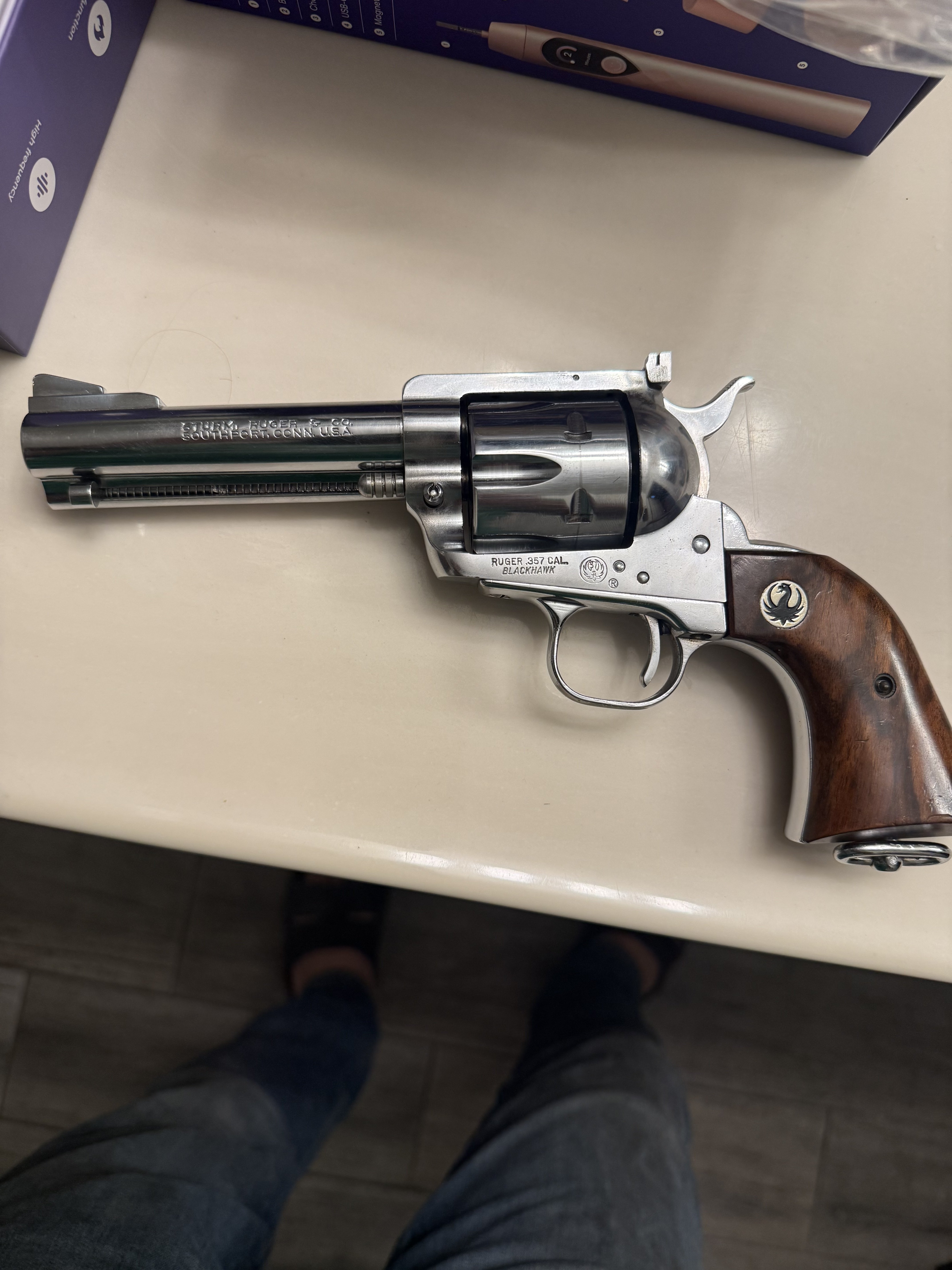

I recently purchased this from a friend who acquired it after a death in the family. It is a three screw obviously and has not been converted. It does have the early 1959 serial number as you can see in the Photos. Also has the micro stamped sights. My question is probably obvious, but I assume this is an aftermarket plating? Some very faint “plum” coloring suggest it may be original, but I’d like to open it up to what you all think. Also the lanyard loop has me thinking this was all done aftermarket maybe in the 60s.

The above posters are likely 100% correct about the finish. I think only a VERY, VERY few experimental guns from that era got test plated. The fact it has a lanyard ring adds to the feeling it was all done after it left the factory.

welcome to the forum, and as noted above definitely aftermarket due to the color ,my guess is chrome, and the prep work beforehand leaves a lot fo be desired, reminds me of an old Colt 1911 my brother in law stationed out on the coast had done, I believe in Tijuana, lots of cross hash marks in the metal surface, still a nice piece, and back then LOTS of old guns ,mainly wartime bring homes were done in bumper shops across the country ,,,can always tell, as chrome is white and nickel is yellow.....again, nice piece, it is what it is, and would be a neat back packing ,trail gun.......(y)
need to add for the term "coin nickel finish" is an electroplated or electroless coating applied to firearms for enhanced corrosion resistance, classic aesthetic appeal, and a slightly softer, yellow-tinted shine.:cool:

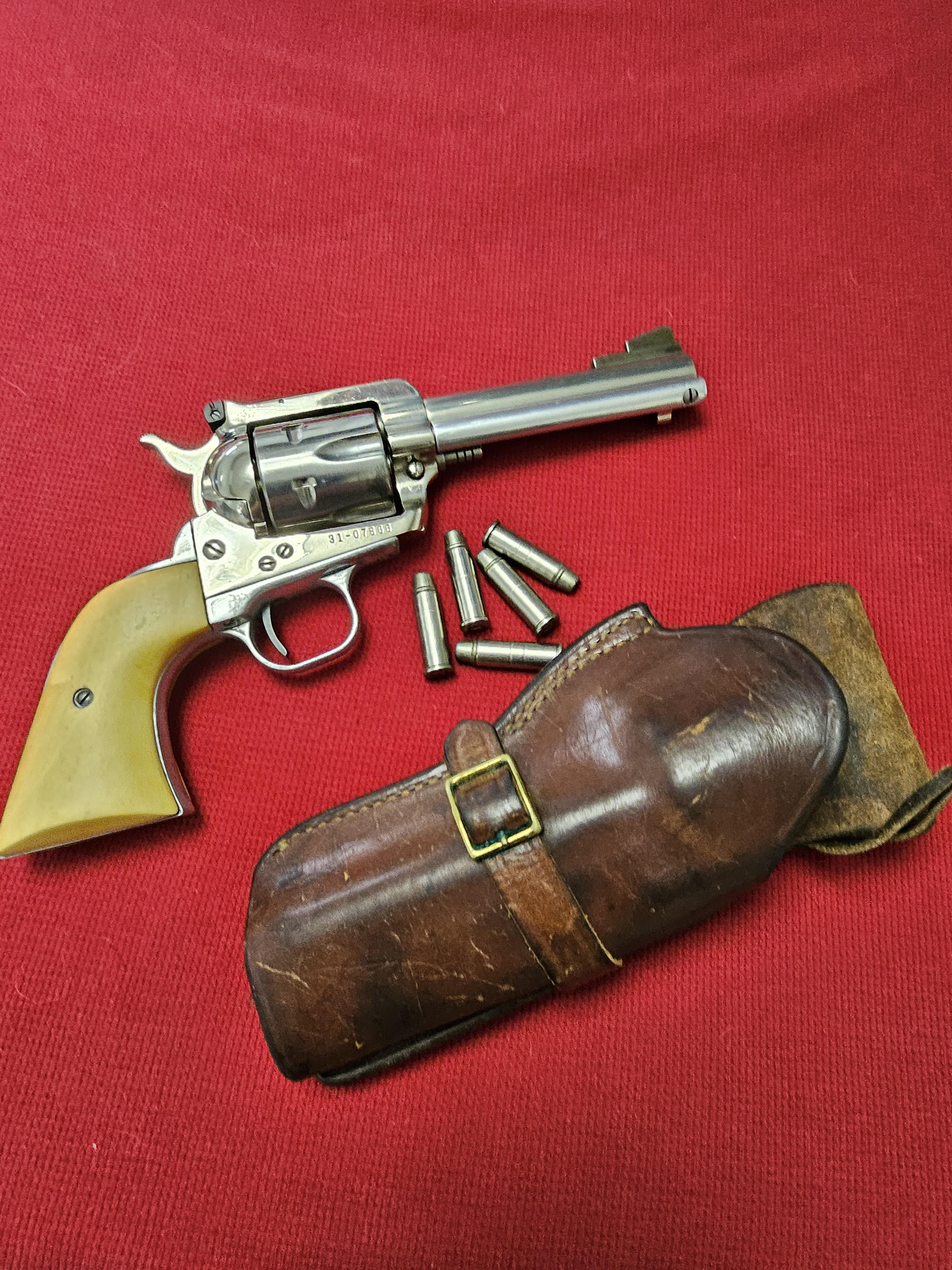

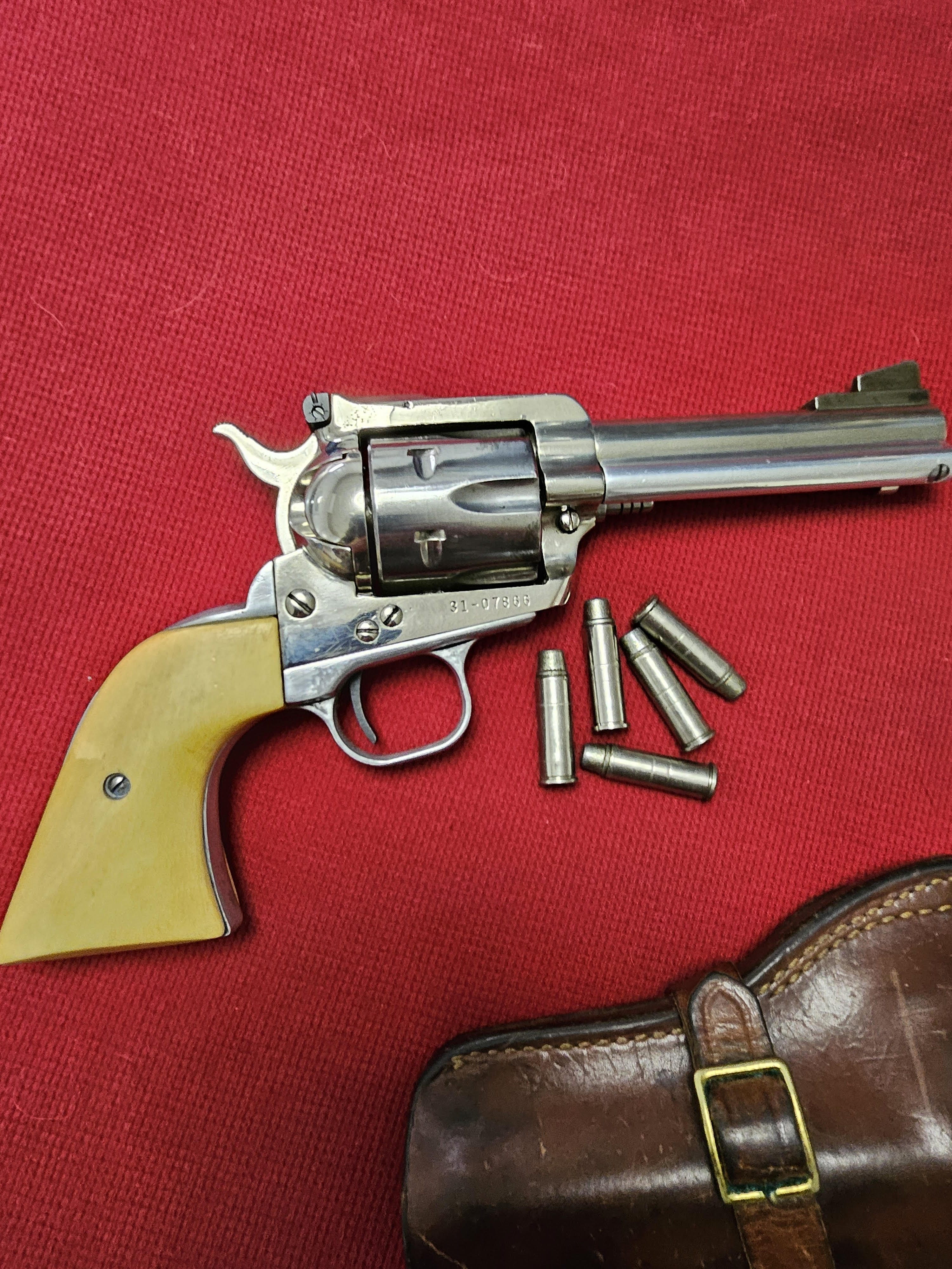

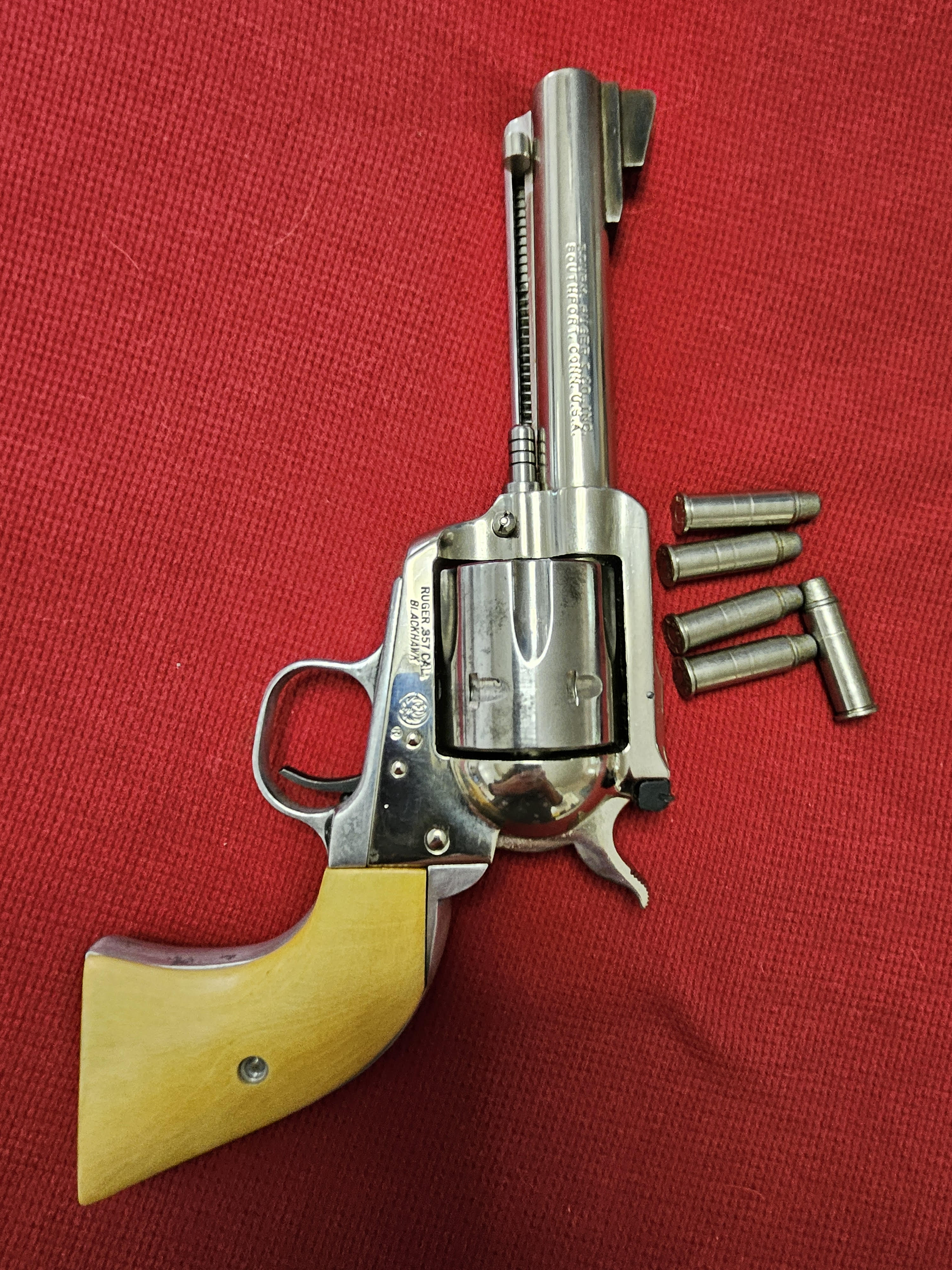

Looks like chrome to me too....I have a similar gun which is nickle and it has a yellowish hue which doesn't appear on the gun in question. Plus, in my limited experience, nickle is prone to peeling off of aluminum gun parts. I don't see any of that here. I do see a small speck missing off of the front of the cylinder, but the ejector rod and grip frame look really good...much better than mine. On mine, the ejector rod housing began peeling first but the grip frame peeled the most. In spite of me having the shop which did the work do those two parts again, the problem persisted. I ended up replacing the plated grip frame with an XR3 that I simply polished brite, and much later, substituted a polished, stainless ejector rod housing from a NM Blackhawk. None of that matched as well as the parts on AmericanSheepDog!'s gun.
All in all, I think that the finish on AmericanSheepDog!'s old flattop looks purdy-good. The lanyard loop is a nice touch too. I've thought about putting one like it on mine, but it seems that I've always had more important fish to fry.
