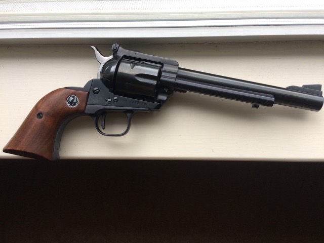

But my two most sentimental Rugers, this 1959 SS and 1968 BH, that I bought new are still unmolested.
