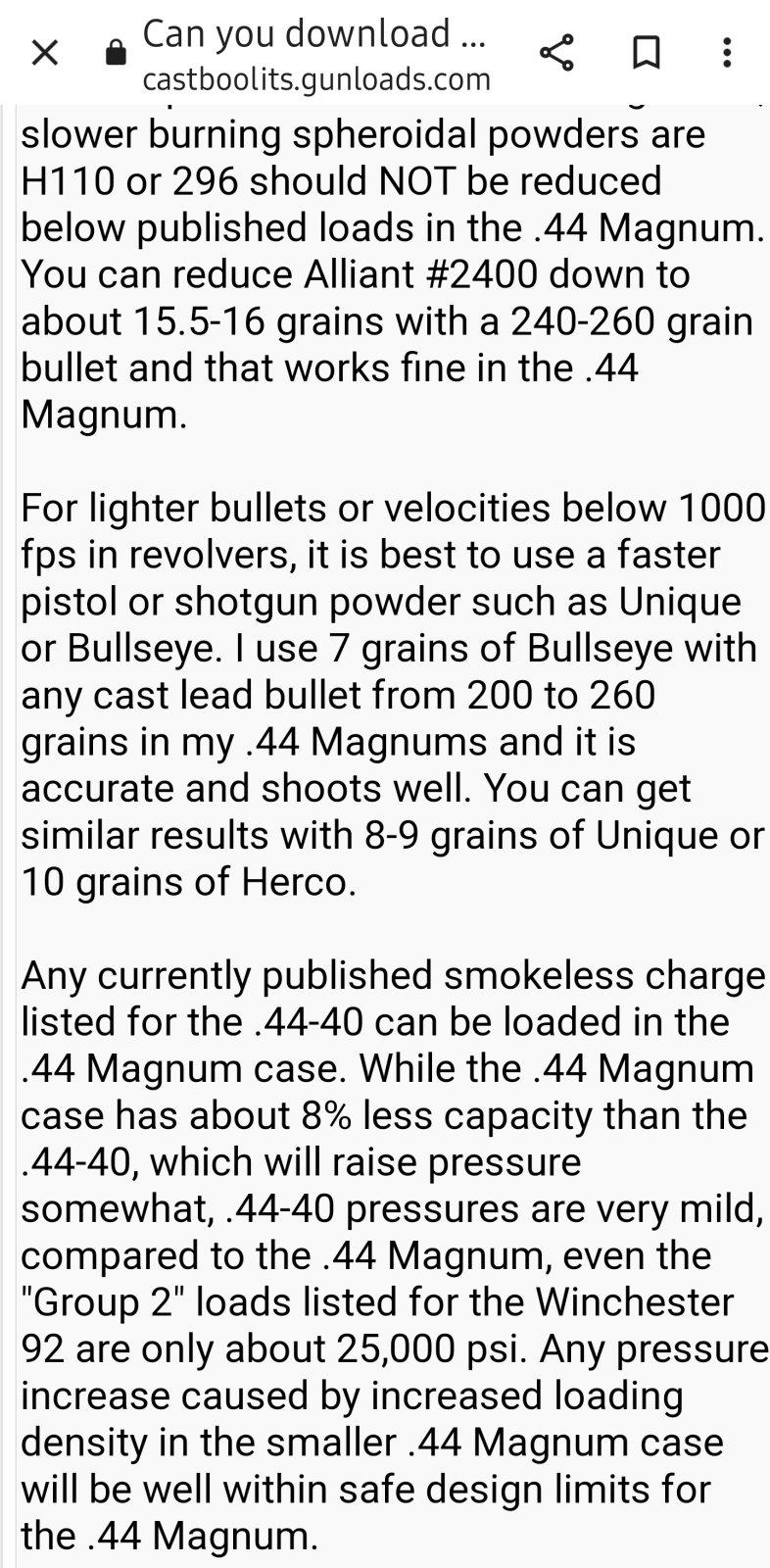

Just want to stay safe. I understand reduced loads can be dangerous.So is it ok,,safe to load a let's say 240 gr rnfp in a 44 mag casing and use a powder charge recommended for this bullet in a 44 spl.
If I understand correctly the 44 split loadings cam be used in 44 mag casings safely.
Read this middle paragraph. I'm trying to figure all this out

A lot depends upon WHICH powder & primer combo you use.
I load .44 Spl in .44 Spl cases using a tried & proven load of 7.5 grns of Unique. But if I wanted to load that same load in a .44 Mag case,, I'd measure things to make sure there was not an excessive amount of air space between the base of the bullet and the top of the powder. There will be an air space in the .44 Spl case,, and it should only increase by the same amount as the different dimensions of the cases.
But if you wish to be safe,, you can do what many used to do long ago,, (myself included,) when using a very hot fast powder,, (Bullseye,) in .38 spl cases. #.2 grns of powder & a WC bullet. To assure correct ignition, and uniformity I would place a "space filler" of a small wad of poly fiber fill material (normally used as pillow stuffing,) on top of the powder, below the bullet. It would occupy the empty air space, and allow uniform ignition.

RTFM. Compare data between the .44 Spl and .44 Mag loads to determine where the magnum can be downloaded to special velocities. It is generally not an issue but may not be safe with all loads due to pressure spikes, etc.
Consider it this way: if a listed magnum load produces velocities in the special range (900 fps or less), it's effectively a special load in a magnum case. Most .44 data I have in manuals lists this type of load.

I have loaded thousands of .44's, Special and Magnum, over a lot of years, some of them, soft-puffers in a magnum case. I've always got the recipe from a known and respected reloading manual. And when doing so, I find a satisfactory recipe using very bulky Hercules shotgun powders. Those powders use up enough case, I do not worry about a detonation.
For safest reloading to avoid concerns and eliminate doubts:
If you want reduced 44 magnum loads only use 44 mag data for light loads, period.
If you want even milder loads, switch to 44 Special cases and loads.
Tip: for light loads use a bulky powder to better fill cases. Trail Boss powder is made specific for this purpose for cowboy action shooters who prefer low recoil. Buy their loading manual.
