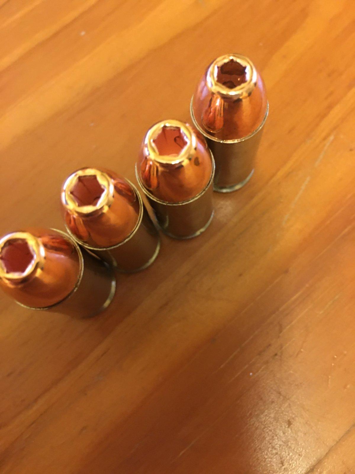

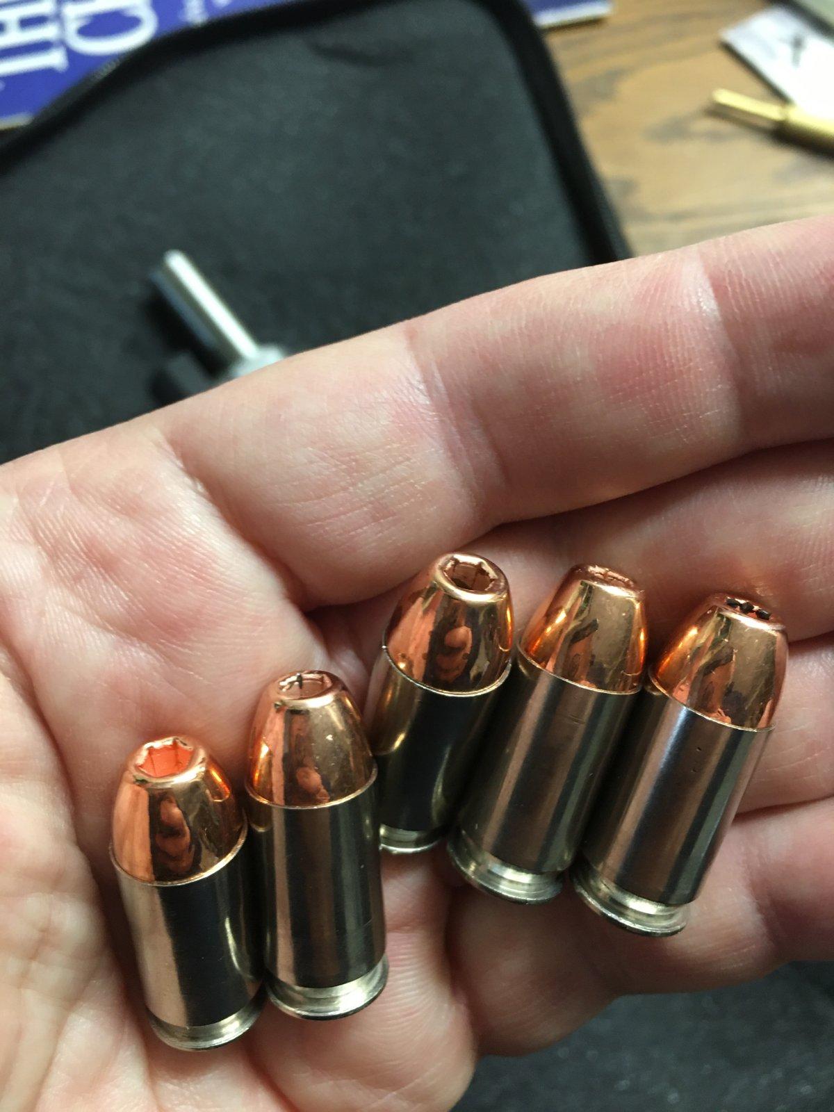

Trying different things….Speer fired brass. CCI 350 primers, 230gr eXtreme plated HP
over a moderate charge of HS-6. Will see what the Chrono says next time I get out.

The plated HP seems to have made significant improvements lately. At one time they were not recommended for SD use but now both Xtreme and Berry's are saying they have met the challenge.
I'm coming into the home stretch of loading 3K of the Berry's HYBRID HP 9mm. Videos of gel tests are impressive as long as velocity is held to recommended levels.
I loaded to velocity by simply loading 5 and shooting them over the Chrony until I was in the zone. When I ran out of the powder I was using, I started over so all loads are within the bullet maker's recommendations--sort of like the big name loaders.
One thing I did notice-those bullets are really 'soft'. I assume to promote expansion and the reason for the velocity limitations.

You mentioned a "moderate" load of HS-6. Since you didn't define it,, I'll throw in a little knowledge with an eye for being cautious.
Remember,, plated isn't the same as jacketed. Plating can strip off at velocities meant for jacketed bullets. Be sure to check your bore after about every 5-10 rounds for build-up.

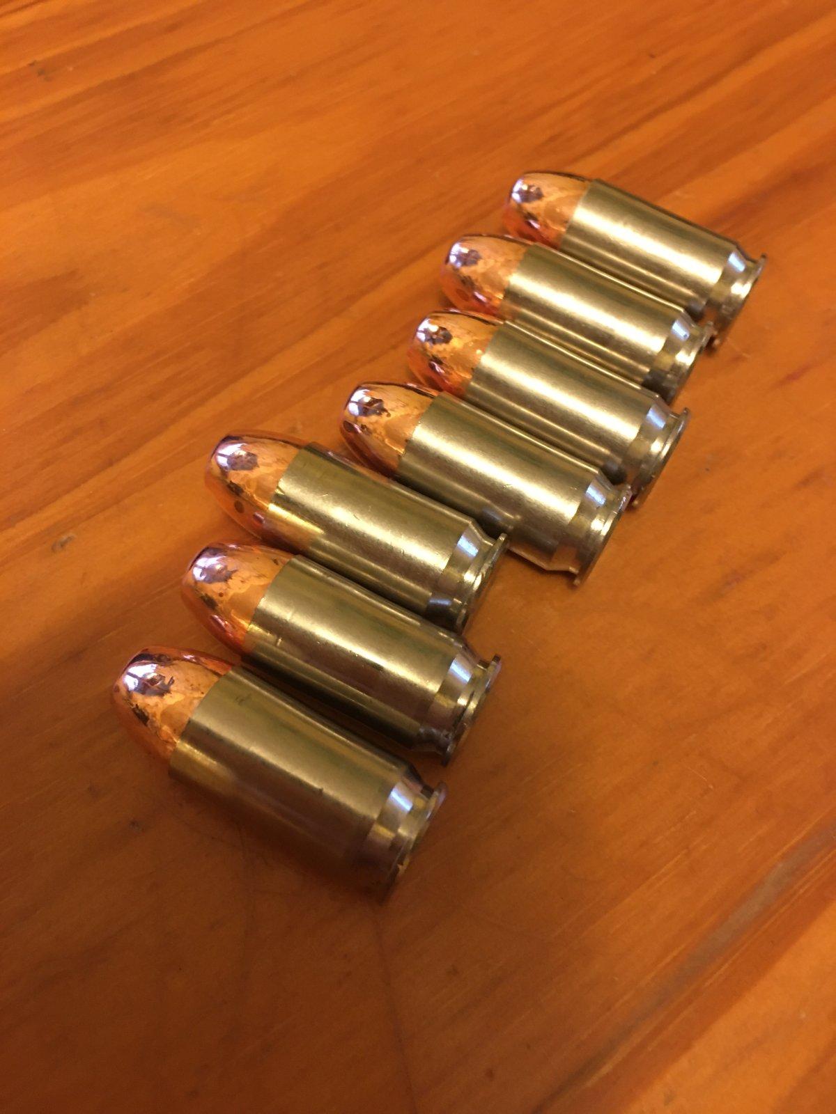

They seemed to load up much easier than the FMJ with exposed base I just loaded, was getting a good bit of bullet bulge with them. Maybe it was the small primer cases? Anywho, these loaded up real nice, I always liked Speer nickel cases.I had no trouble with plunk test this time.
Starting at 7.4gr HS-6
1.23OAL/CCI 350LP
I was getting 835fps with 8gr of HS-6 under a EB FMJ out of my 4.25in Lt Wt commander. Was a little stout, backed off to 7.8gr for 820fps and left it there.

That load was a 230 gr plated over 7.4gr HS-6. I was getting 795fps out of a full size Colt 1911. So actually a light load.

"That load was a 230 gr plated over 7.4gr HS-6. I was getting 795fps out of a full size Colt 1911. So actually a light load."
Yes,, a moderately light load. In USPSA terms,, (power factor) it has a PF of 182.85. For USPSA to make it a "major PF" it has to be at least 165 PF. My light loads in USPSA,, from my .45 acp,, has a PF of 168-169. No problems with plating stripping there.
