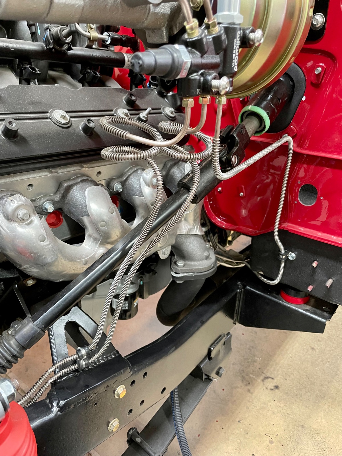

While replacing the rusted-out line, I discovered this wasn't the first replacement. Told Grouch Attack she'd better decide what her replacement budget was and plan her investments to allow a withdrawal next spring (or maybe next month depending on how well the 'for sale' ad works).

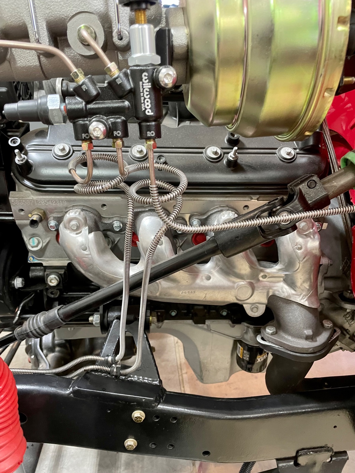

now we're talkin' - nice work Randy, those lines look great!!!
I'm transitioning into retirement and will be starting some restoration work on my old truck fleet soon, hope I can run my lines anywhere close to that cleanly.
