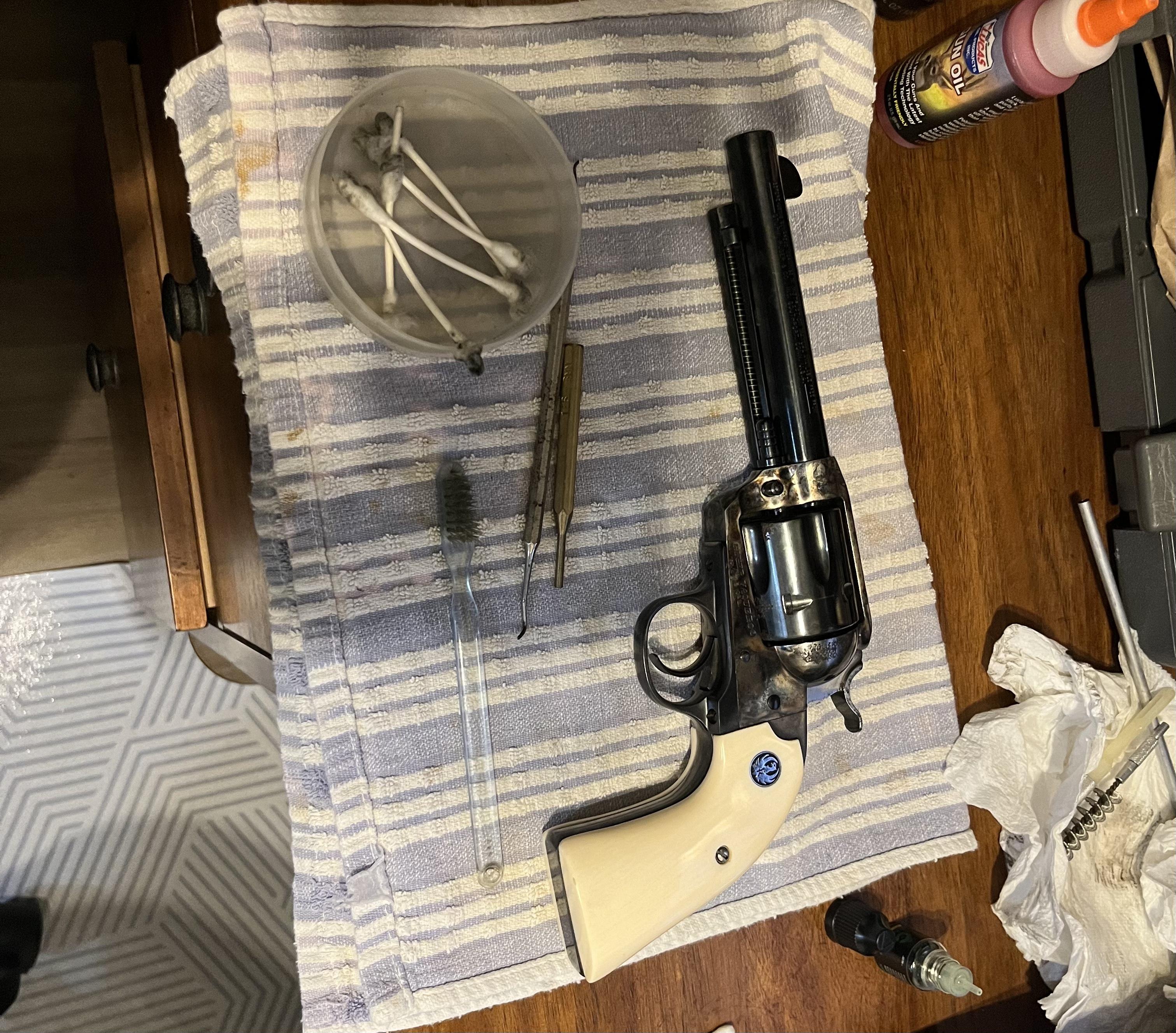

I picked up a Vaquero Bisley in .45 LC last weekend at a VERY good price. The cylinders and bore are in like-new condition and the lock-up is tight. I’m an old soldier and could only find the smallest amount of carbon in it. Unfortunately a previous owner left it sitting in a wet location for quite a while and it has some (mostly) light pitting on the color-case hardened frame, and a couple of worse spots on opposite sides of the blued cylinder. Because of the pitting, and because it also came in a box from a stainless Super Blackhawk it doesn’t have any collectors value, so I want to use it for a customized shooter. I bought it mainly because it is an original large-frame, large-cylinder pistol and can therefore handle the heavier Buffalo Bore and Cor Bon loads. I would like to have the barrel shortened to 4 or 4-5/8”, get it refinished, and have some action/cylinder/forcing cone work done. Depending on cost and feasibility I would also like to have it rechambered for .454 Casull and eventually have it fitted with an additional.45ACP cylinder. I have also seen where people have occasionally mounted S&W adjustable rear sights to the topstrap on Vaqueros. Does anyone know of a gunsmith or shop in the Tampa/Sarasota area that could handle this work? Or even a custom shop elsewhere?
IMO only - This 45 colt can be hot loaded to 44 mag standards in this revolver ("old" vaquero), don't shoot 454 casull in that cylinder bored out. Not strong enough period. No way, no how. Is the frame? Maybe, maybe not (but not for long) (speaking of full loads). I would simply load up hot 45 colt loads for it. Trust me, the recoil will be enough with only that LOL. If you download the 454, then what is the point? Just my opinion. Don't do something stupid and be later called Mr. Two Fingers.......
BTW - I'm all in on hot loading when safe. 454 in that revolver is not safe at all, period. You may even kill someone. Again, don't be stupid !!!!!!

Congrats on a fine score. Have you shot it yet to see how it shoots? I have the attitude that I won't start changing stuff until after I see the need to improve the accuracy level.
But let's address the cosmetics first.

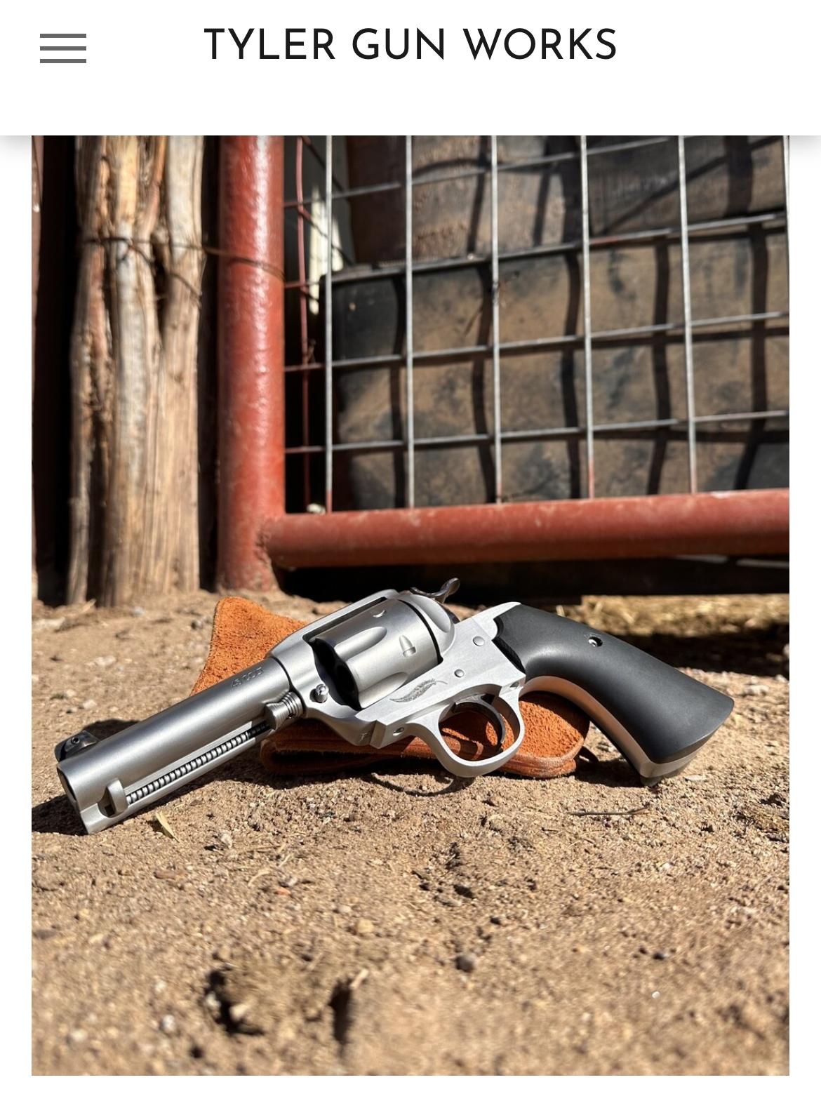

Since you mentioned shortening the barrel, and refinishing,, I'd strongly recommend "Tyler Gun Works" in Texas. Bobby Tyler can easily do both operations at one time. He can also do the action work if desired. I'd ask him about the different sights too.
You mentioned the cylinder & forcing cone work. A member here, (2dogs) can do this. And another member here, (and over on the cast boolits forum) DougGuy also does excellent work on those areas. Both offer that service at a reasonable price.
Do you plan to shoot cast bullets? If so, slugging the barrel & checking the chambers of the cylinder is paramount to achieving proper accuracy.
Now,, the idea of a re-chamber to .454.
That would require a total different level of gunsmithing. Even Ruger only does it in a 5 shot cylinder. As such, not many gunsmiths will do this conversion unless they re-work it to a 5-shot, and that become time consuming & a more serious expense. Most of the GOOD gunsmiths doing such work are booked 1-3 years out.
My PERSONAL thoughts would be to leave it alone in the caliber dept, and if a 454 is desired,, look for a Ruger Super Blackhawk already done.
And since you mentioned shortening the barrel,, again, this is just my PERSONAL thoughts. A big bore, with the desire for more power,, in my opinion gets better use of such ammo with a bit longer barrel. That gun looks to be a 5-1/2" bbl, and I'd personally leave it as it is,, to enjoy a bit more efficiency of those heavy loads.

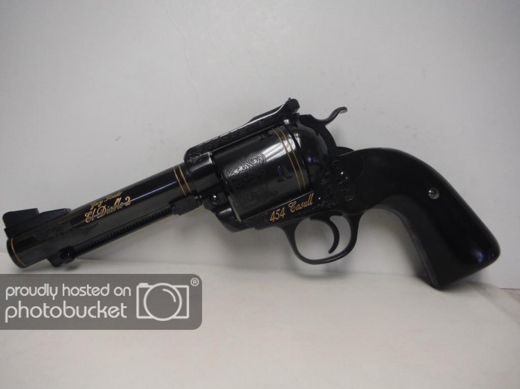

Gary Reeder in AZ converted a NM Super Blackhawk for me to a 5 shot 454 Casull (El Diablo configuration). Really nice gun=shot 2" groups for 2 shot at 10 yards (then I started to flinch). He can do any level of customization from mild to wild. My SIL is from Alaska and wants to go back to hunt, so I gave it to him. I still have a OM Blackhawk in 45 Colt.

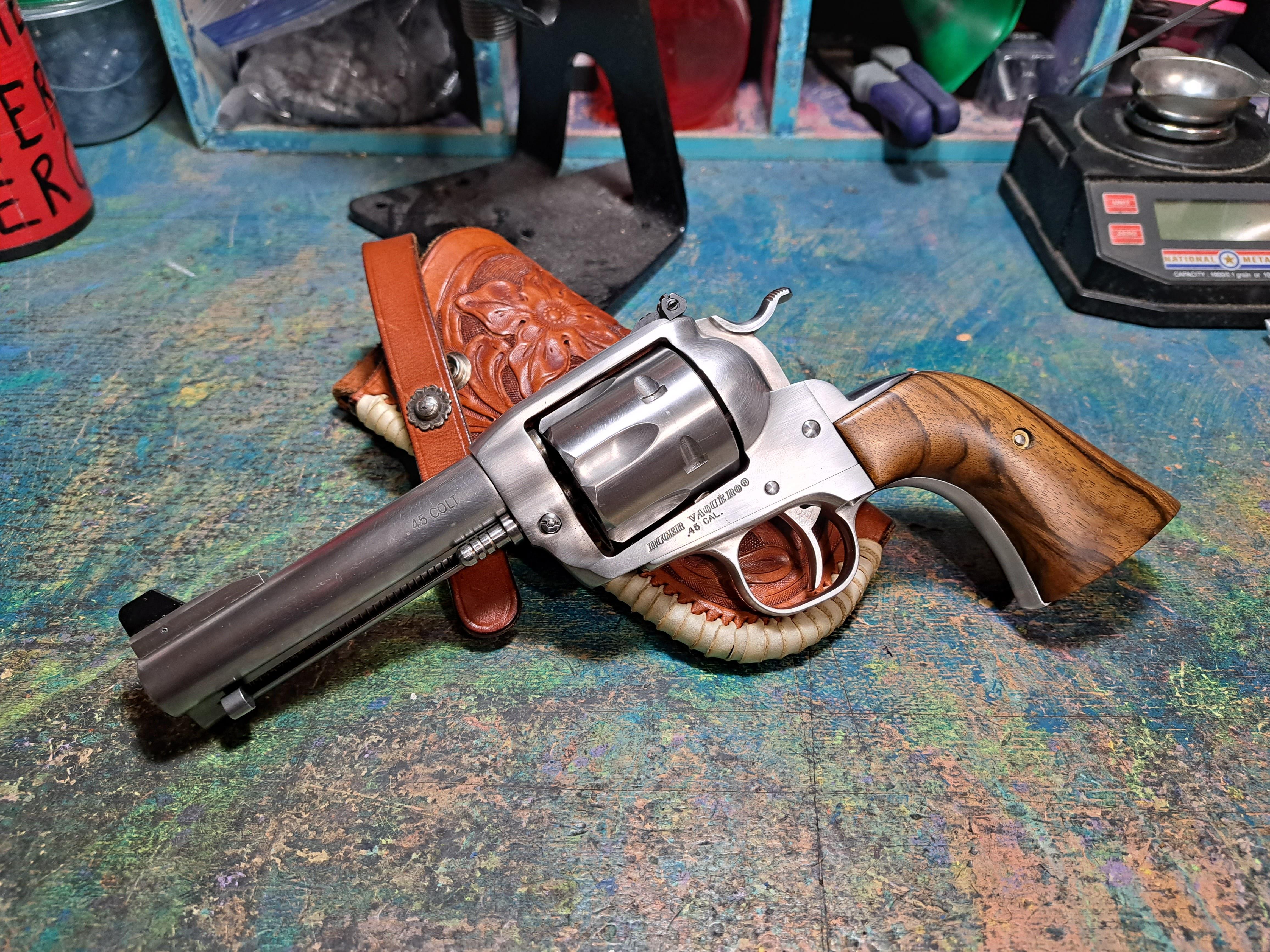

One that I did myself was to use a birdshead (too painful with heavy loads) OM Vaquero. Added a Bisley grip and Hogue oversize wood grips. Kept ejector and housing. Nice woods gun and very comfortable with heavy (i.e. "grizzly bear") loads. Drawback was I couldn't find a decent small/short holster.

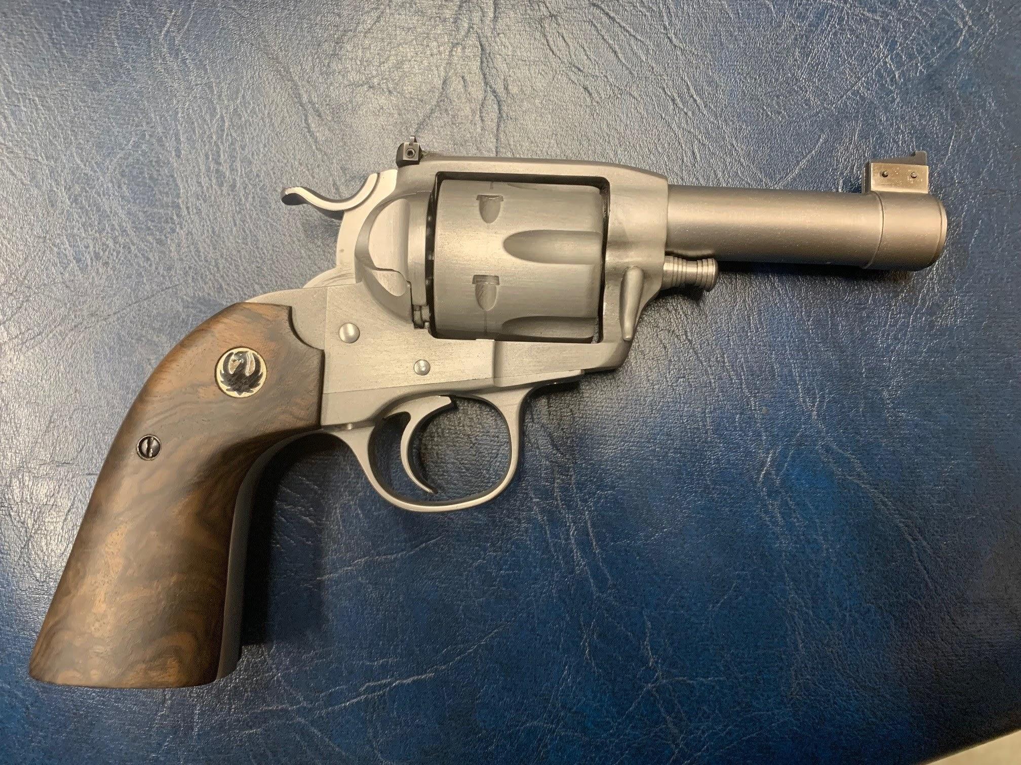

Bobby Tyler is doing a collaboration with Ronnie Wells- a featherweight Vaquero.
I’ve got a .45 New Vaquero that I’m going to partially copy this build. I have a RW Dealer grip frame in aluminum, and I need to decide on Micarta or wood for grips. I haven’t decided how to proceed from there.
Professor...just was reading about the Croft Featherweights in a copy of American Rifleman at archive.org, page 19
sim_american-rifleman_1928-09_76_9.pdf
How does yours carry and shoot? By the looks, you nailed it.
It's great fun. No ejector rod so reloads are slow. It's fun. John Powers builds accurate guns. I'm not sure whose barrel blank he used but it's accurate. I carry it in a simply rugged 120. My favorite holster design for single action.
