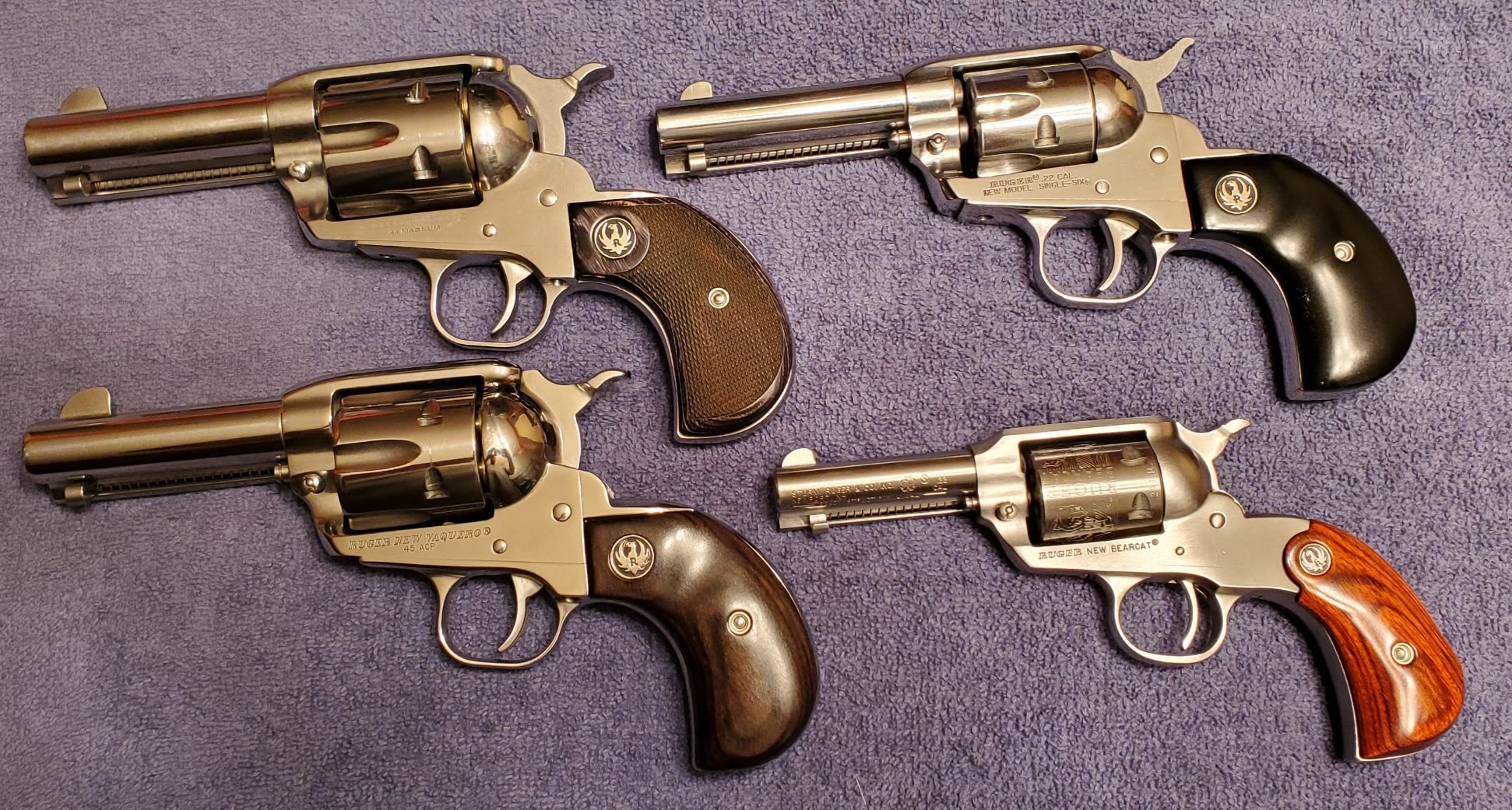

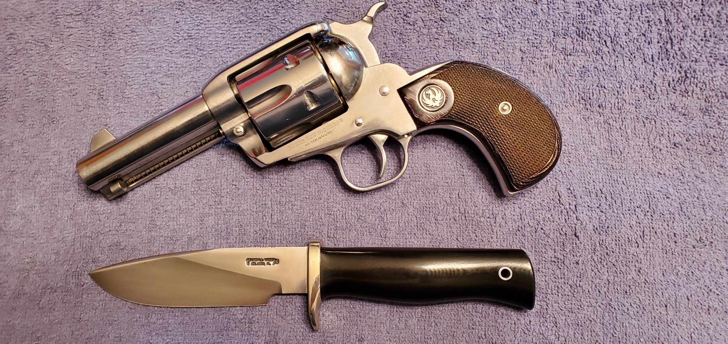

I just got an original Vaquero at the gun show last weekend and it is HEAVY. Mine is .357 so I don't think there's any loading it won't shoot ok. Two pics as I got it and one after a swap to Altamont Santos Rosewood grips.
One with it and its cousin that also got grips.

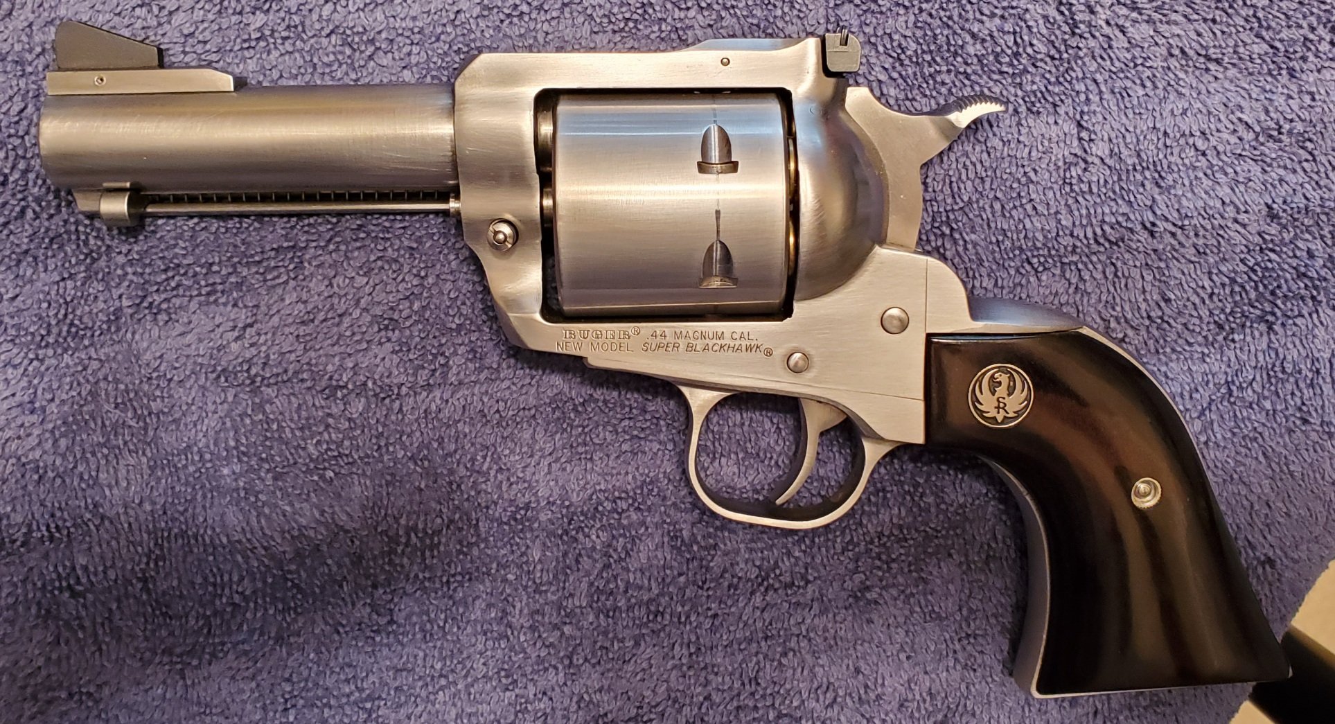

I own this new vaquero in 44mag.View attachment 102383
