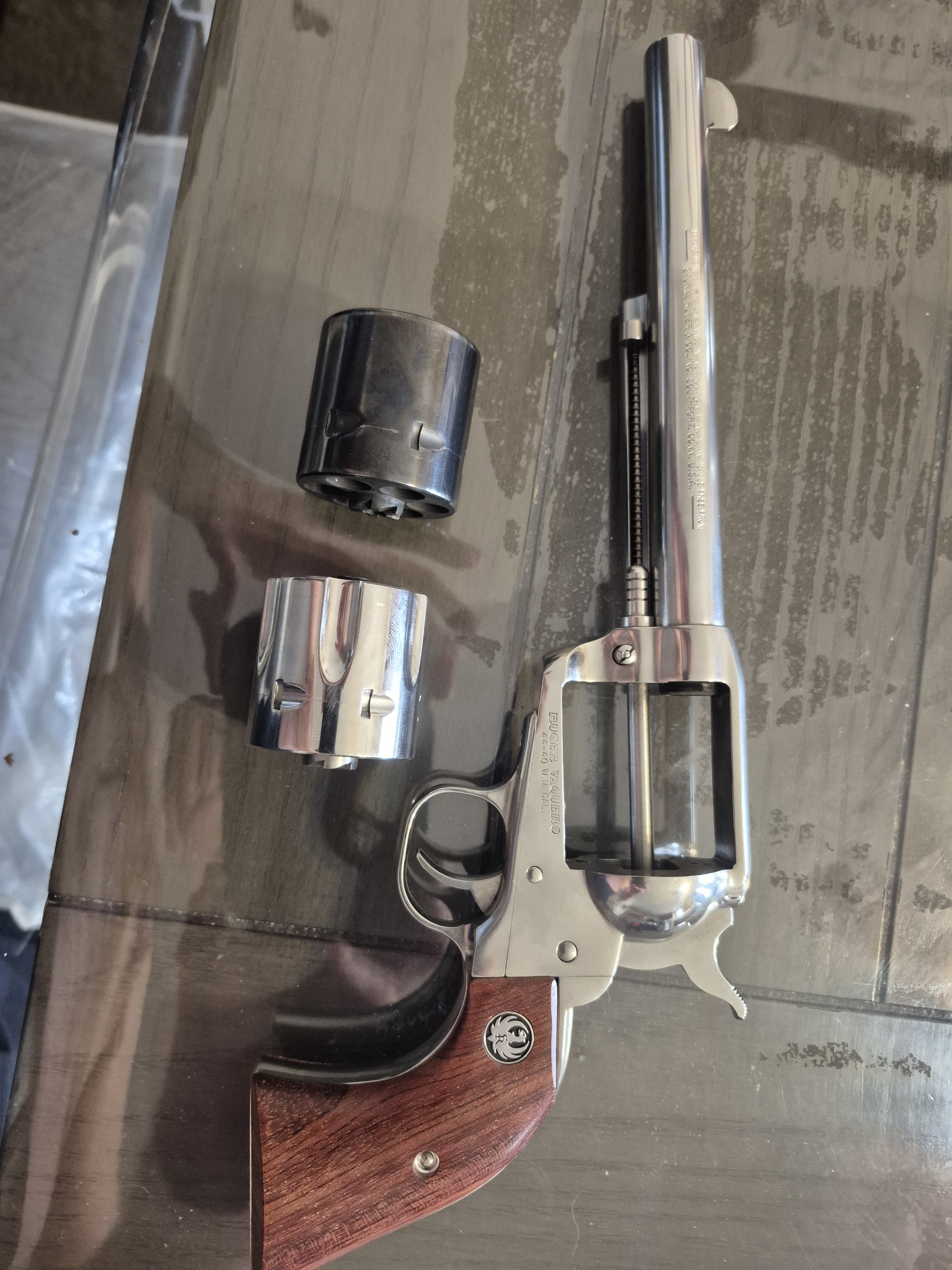

With 44-40 ammo being hard to find from time to time, look for a New Model Super Blackhawk 44 Magnum cylinder to make a convertible. Ruger used the same barrel diameter for their 44-40 and 44 Mag Vaqueros.
The .44mag cylinder is out of my SBH for test fitting. It is a little tight. Ebay has a .44mag cylinder for sale.

Because it is an odd ball cartridge, make him a reasonable offer. Mine is going to live as a 44mag.

Quik update on the 44mag cylinder. I filled the cylinder to fit. Then I checked the timing and alignment. Everything looked good so I got some 44mag cowboy loads to test fire. I ran the box of 50 through it with no issues. I pulled the cylinder and checked for bullet shavings. The forcing cone and barrel look good. I then ran starting loads of cfe pistol and 200gn hornady ftx bullets. Happy. Happy. Happy.
