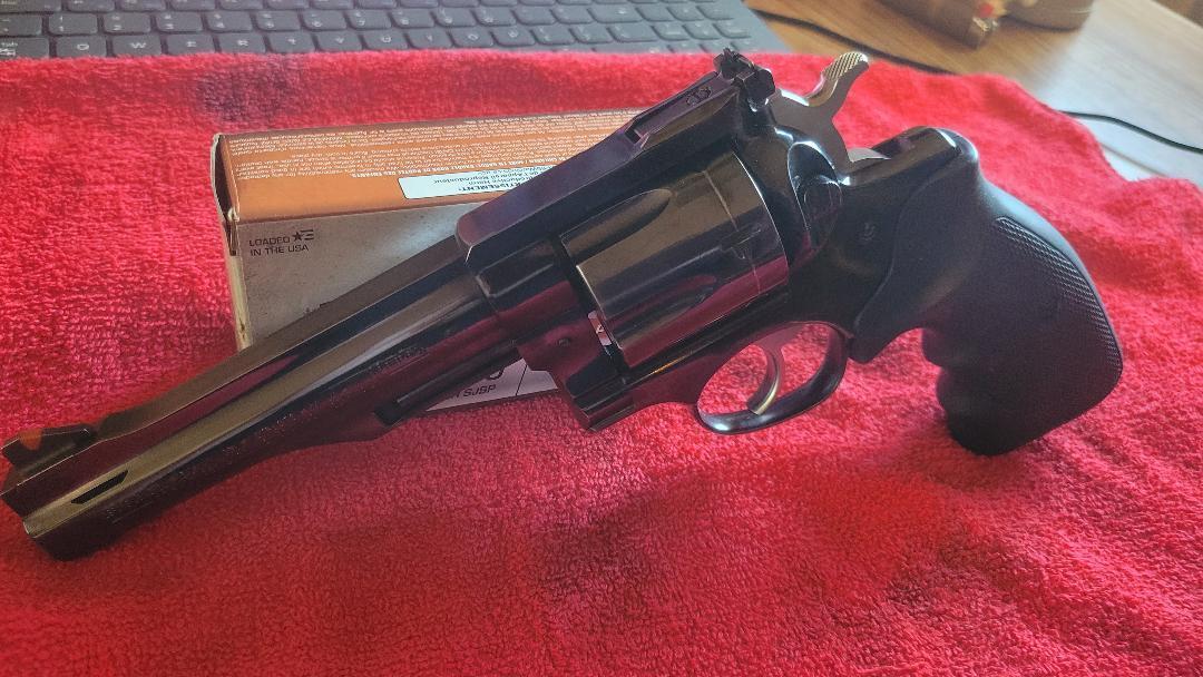

I'm with Hittman-they cover the backstrap completely and they really fit my hand well-waiting to hear your review on them-good on ya Hittman for the grip loan!
I'm looking forward to the test! If allowed,, I'll keep them long enough for folks at the upcoming "Gathering" to try.
Great idea. Let everybody give them a whirl. I’m in no hurry for their return …. I may have another set lurking here somewhere ….
