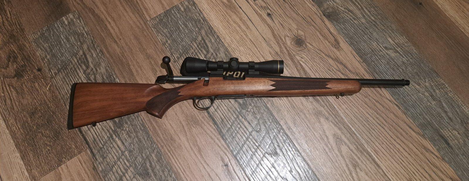

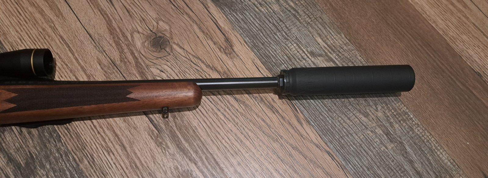

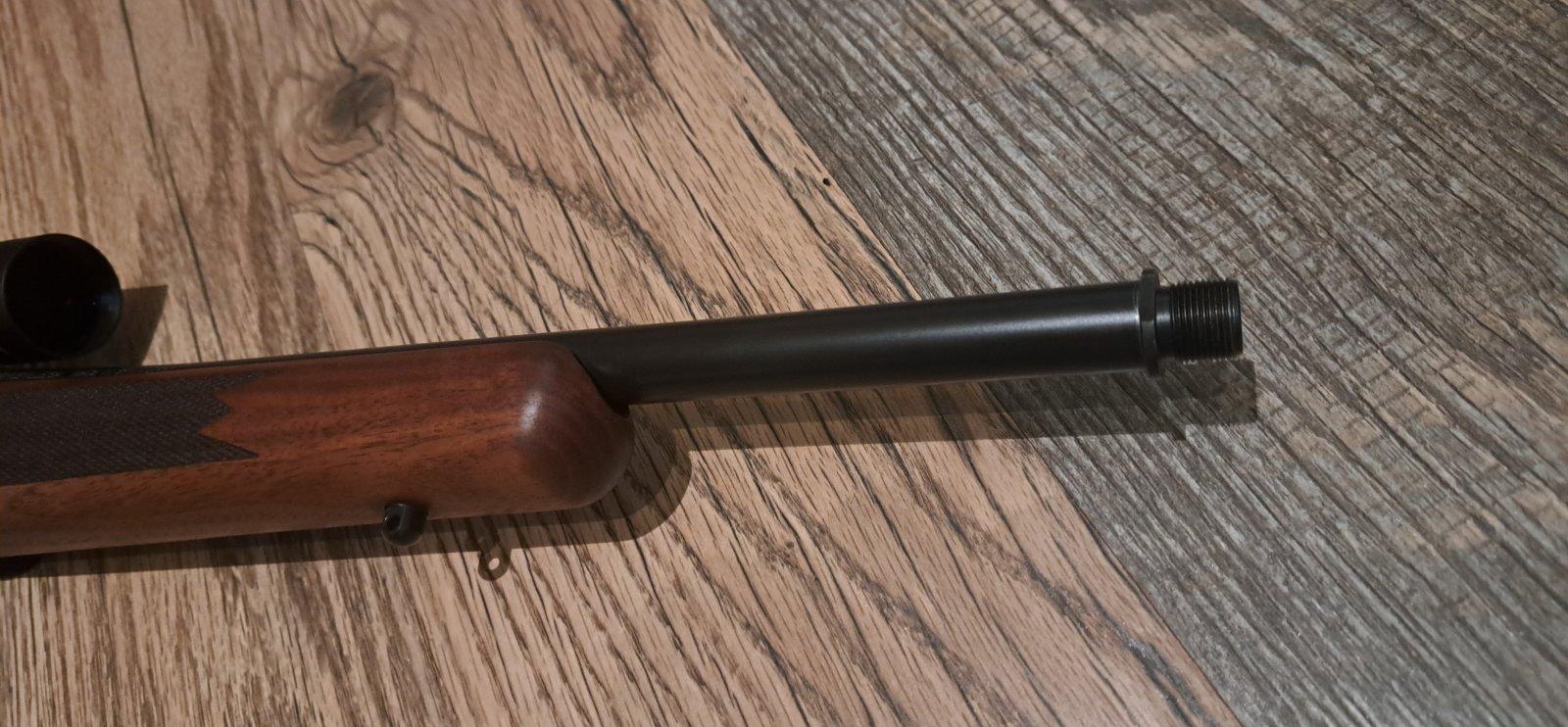

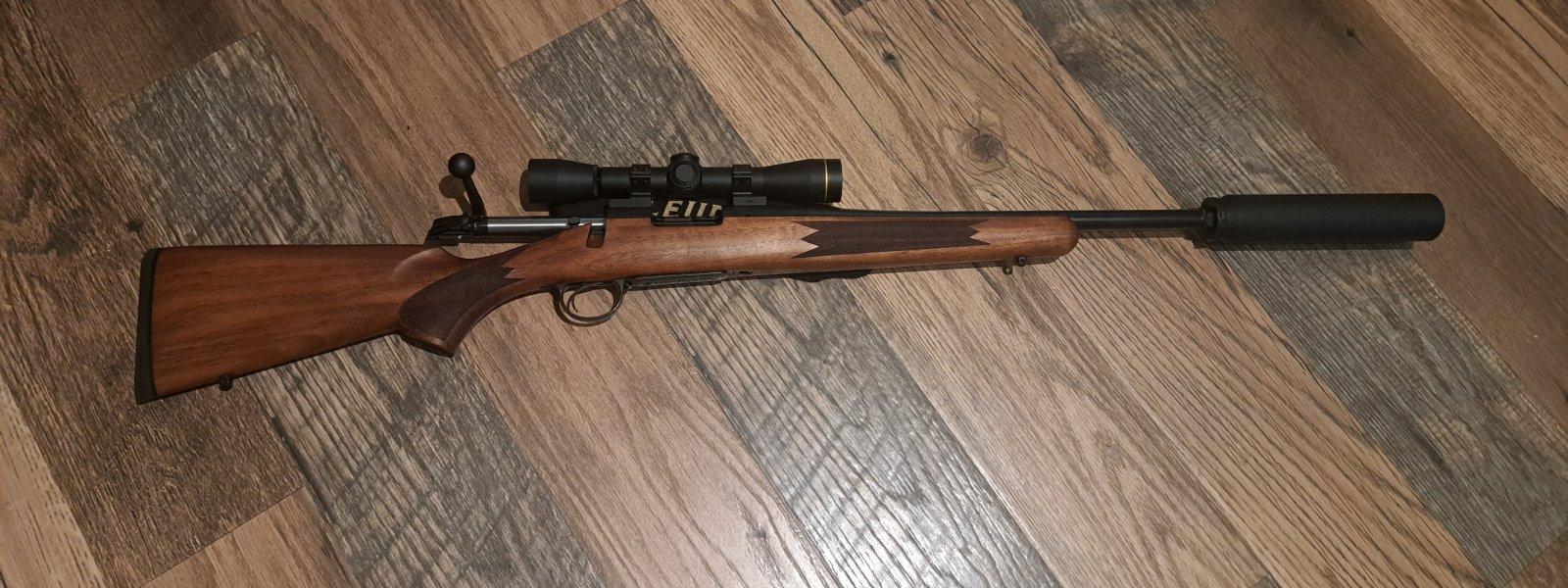

It's cut and threaded with adaptor. Looks OK enough to me. Thanks for the advice.
