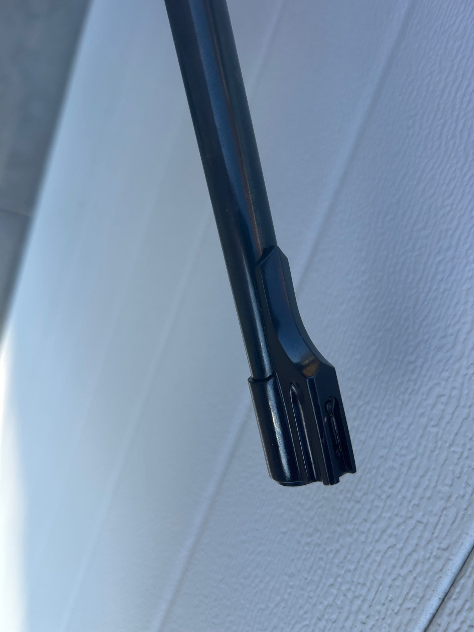

How do I remove an M77 front sight housing from the barrel?
53billygoat
Feb 5, 2026
1
Utah
I'm getting the barrel threaded so I can put a suppressor on my gun and I need to remove the front sight housing from the barrel. I've removed the front sight and underneath it was a set screw that I've removed. This is for a Ruger M77 Model 00749 made in 1986. What is the procedure to remove the housing? Any tips or advice are greatly appreciated.
I remembered some old information on this subject and found this old thread:
I’ve seen similar information regarding M77 sight bands so pretty sure they are similar to No 1 barrels.
I havent had to much trouble getting them off. One I did take a heat gun to and then tapped it off with a hammer and a nylon punch.
