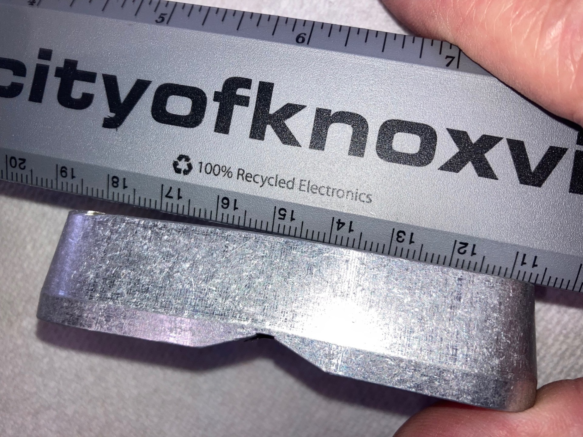

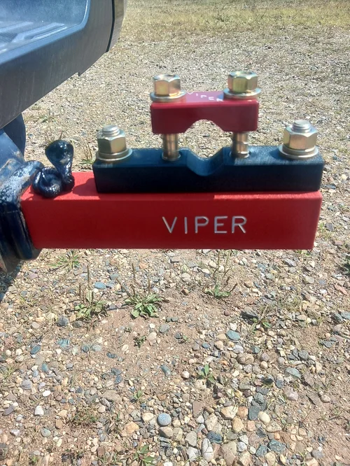

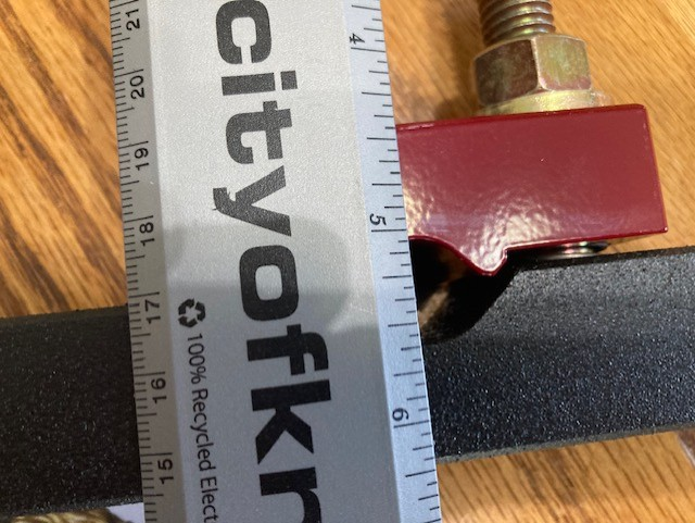

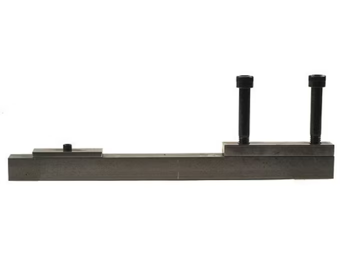

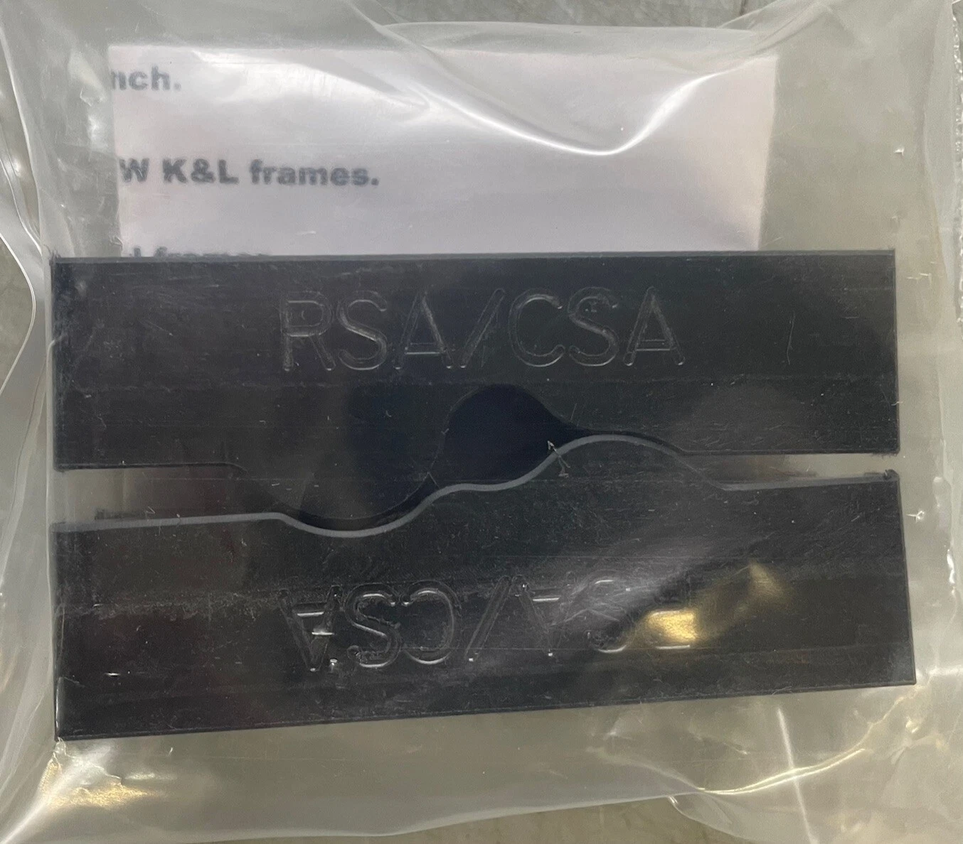

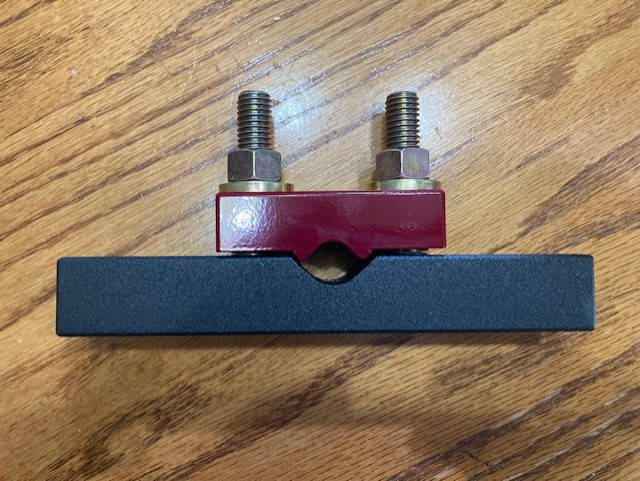

I am in need of a new barrel vise. I bought one off ebay a couple years ago to pull the frame cut-offs off parts kit barrels. I have to tighten it down so much on the revolver barrels that it bent the top bar, 3/4" alu.
I am having trouble finding one that will work on a single six barrel, around .6700-.6800. I can find one that goes to ,7000.What do you guys use? I am getting deeper into working on these and need a vise that will work. Thanks for your help.
Never use rosin to keep barrel from slipping. It will mar the bluing, and especially if it slips!
Barrels are tapered, the hole drilled in the wood blocks is not.
Your vise has to make up for that difference. I use duct tape folded over length wise so it's sticky on both sides and wrap the barrel with it overlapping the wraps. Then cover the tape with a piece of leather. It will fill the void between the tapered barrel and the straight hole in the blocks.
