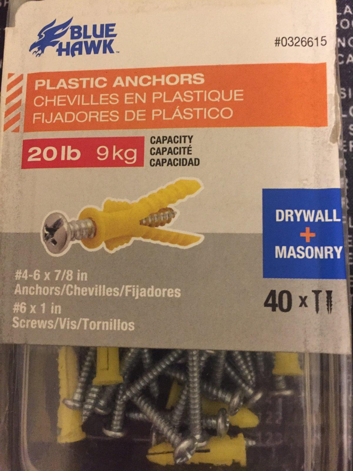

Spend $15 and buy Tipton Snap Caps off Amazon. They are spring loaded at the primer. I don't want to train myself to be looking at brass for dry fire practice. I use the yellow #4 wall anchors for .22-just rotate the striking point.
Yep those #4-6 yellow wall anchors do work well.
