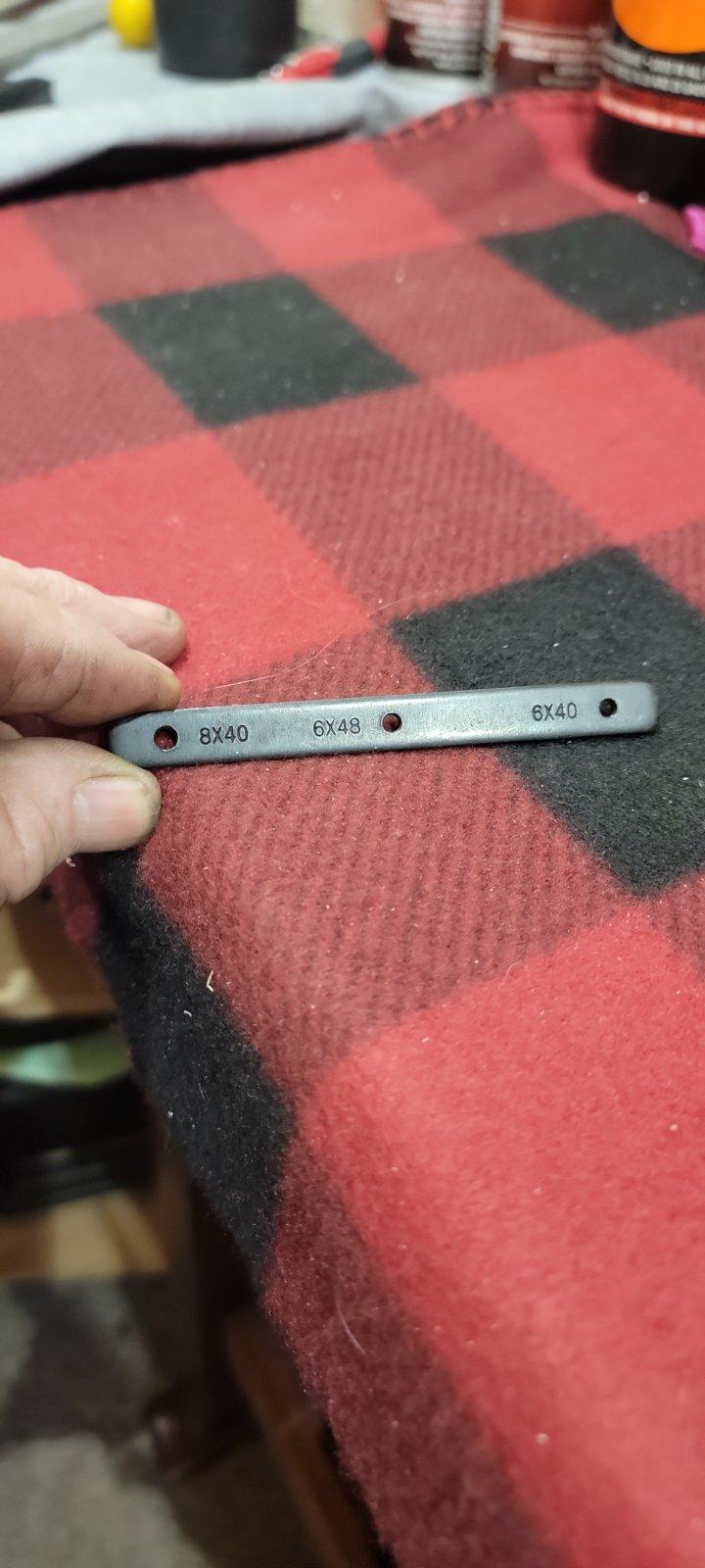

I found this screw size tool at the hardware. They have several drawers of screws labeled gun screws.I just got a few not cheap. And this gauge.Yes the holes are threaded with appropriate size

The Brownell's Screw Chek'r works perfectly and is a great tool. I've also had mine for over 10 years and it's been a lifesaver more than several times when I've had to replace a lost screw.

Screw checkers are a fine entry level tool but don't cover nearly enough cases to be useful for a pro encountering diverse thread types. They'd be most useful to sort a large number of screws of a limited number of known sizes.
