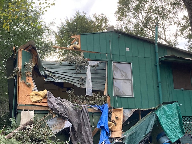

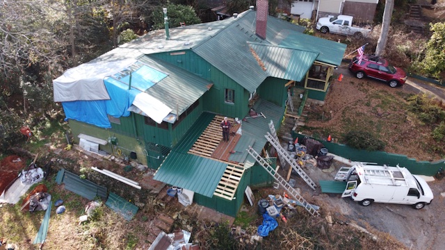

I installed a metal roof on our house over 20 years ago, never a leak and I really am not a pro at it... well it did leak back on Sept 27th of 2024... that's because of this:
This is after the tree was removed. The damage would have been much worse with a composite roof.

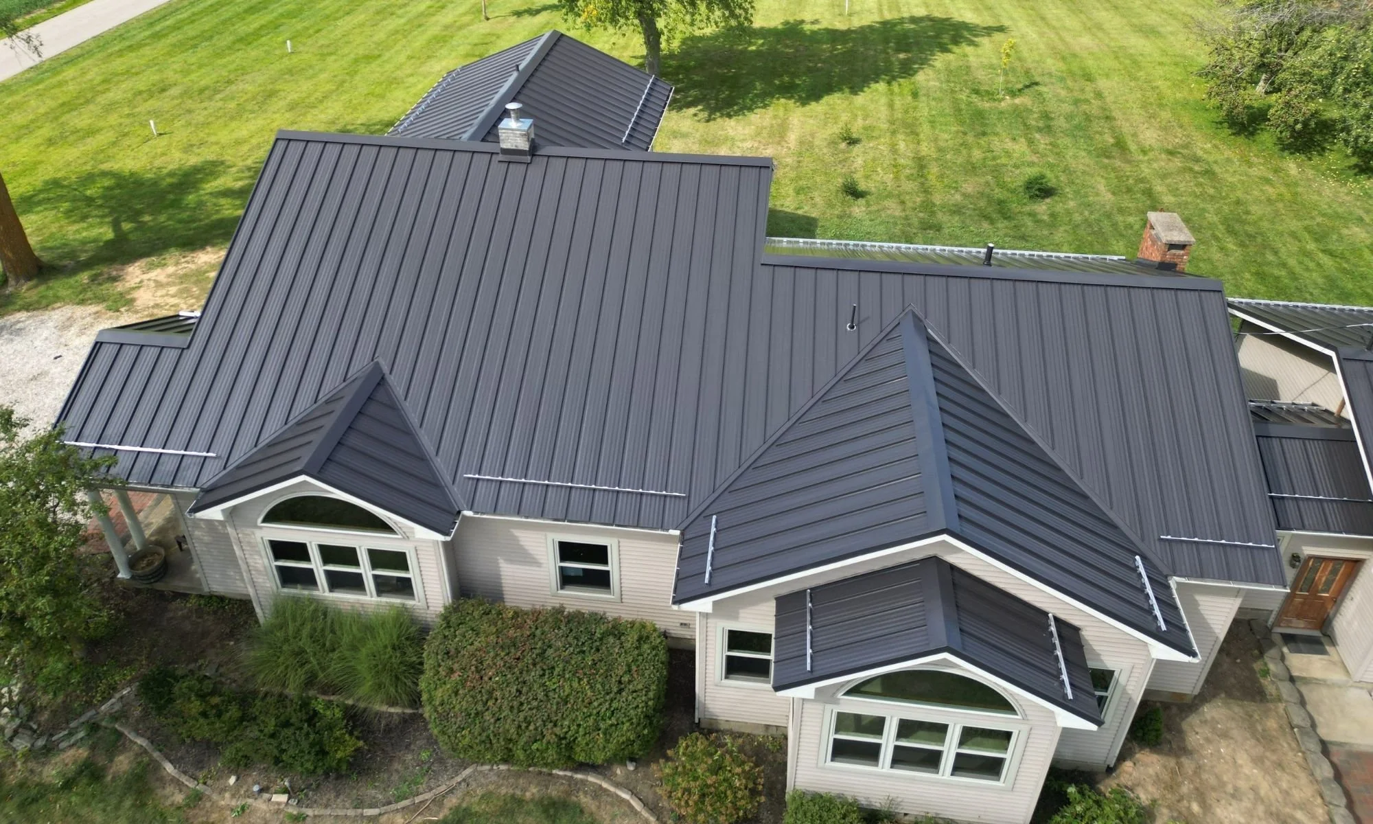

This is a standing seam metal roof that is very popular in Texas. My neighbor has had one for 30 years with no problems.
