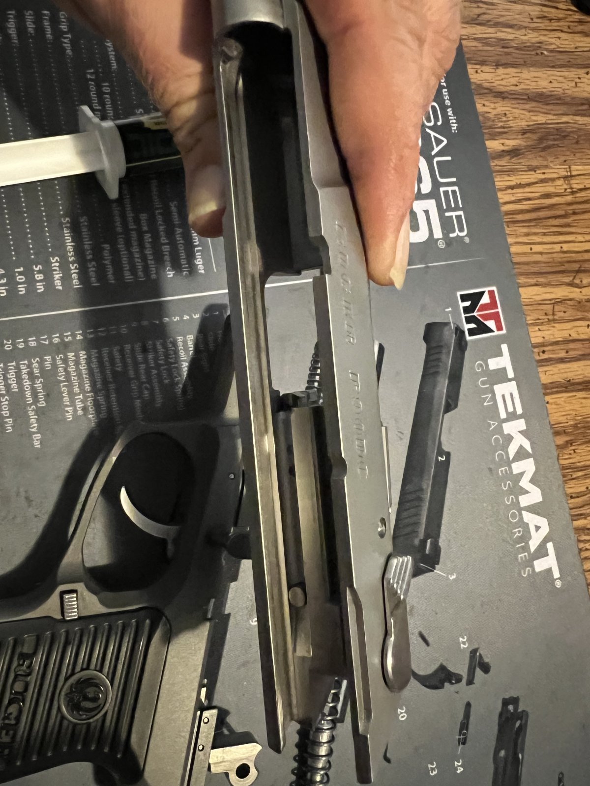

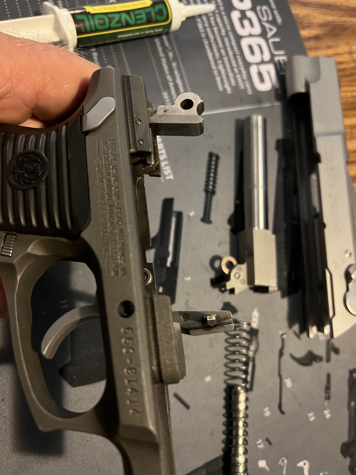

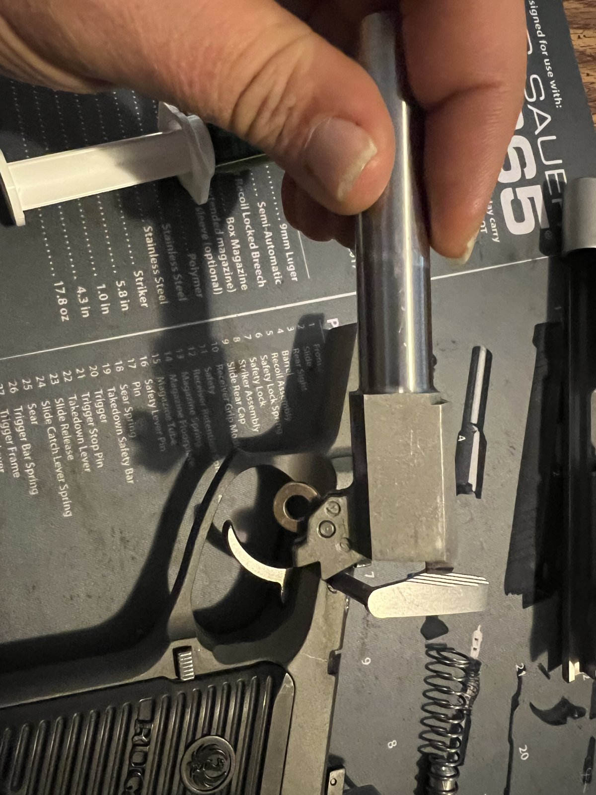

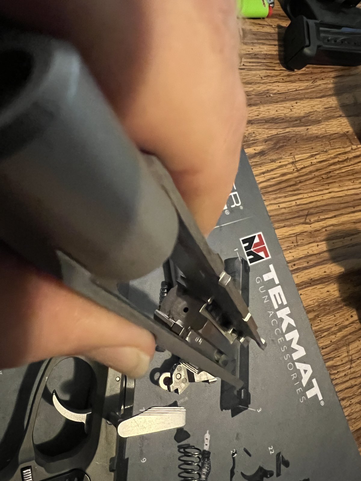

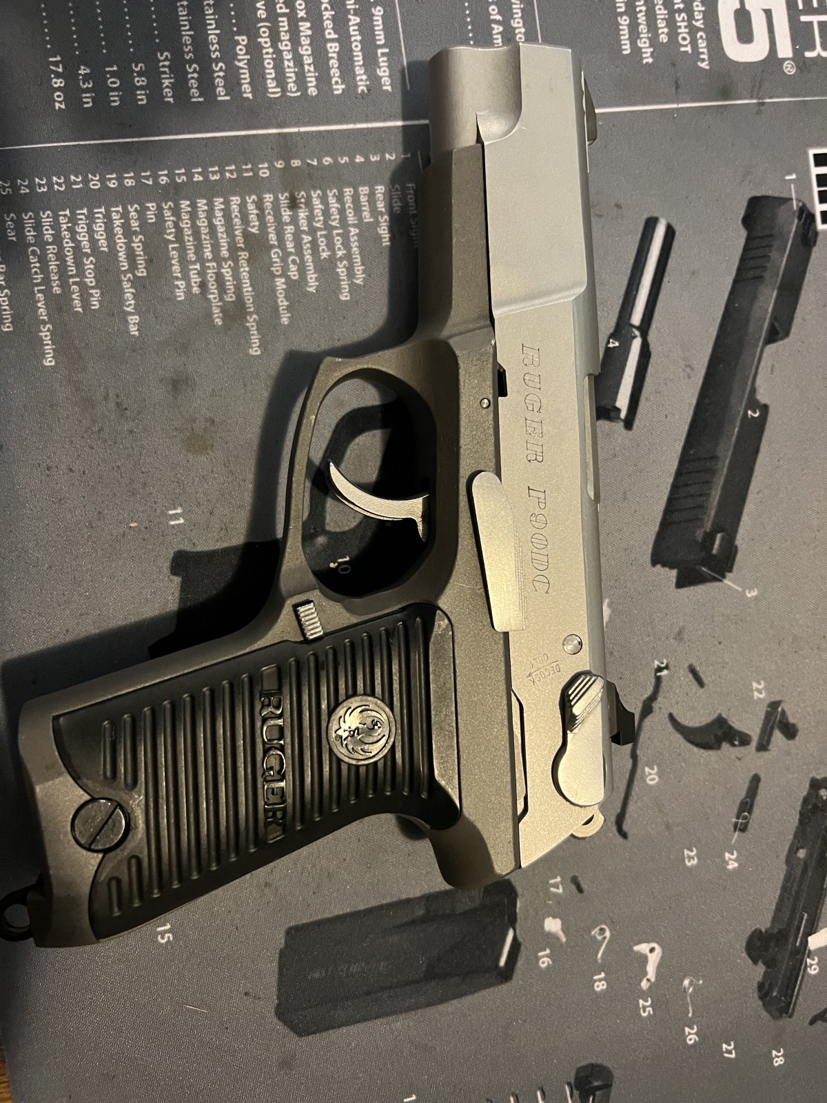

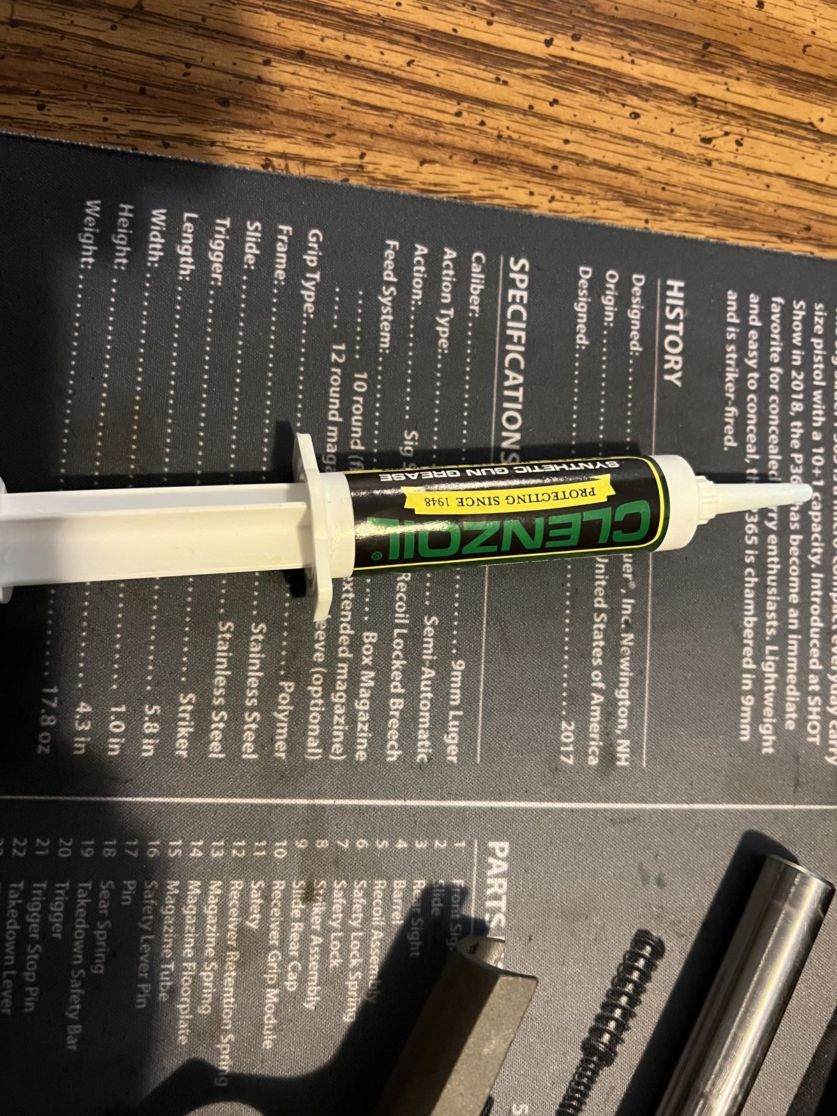

No I have tried different ammo and it still does it. I have not noticed it without a mag inserted as it usually happens after the 3rd round fired. I have attached photos of the disassembled firearm. As you can see no galling is present. I have also attached a photo of the gun grease I use.

I'm guessing you dont see any small burr on the lower or the slide rails?
Light coating of grease on the rails help?
