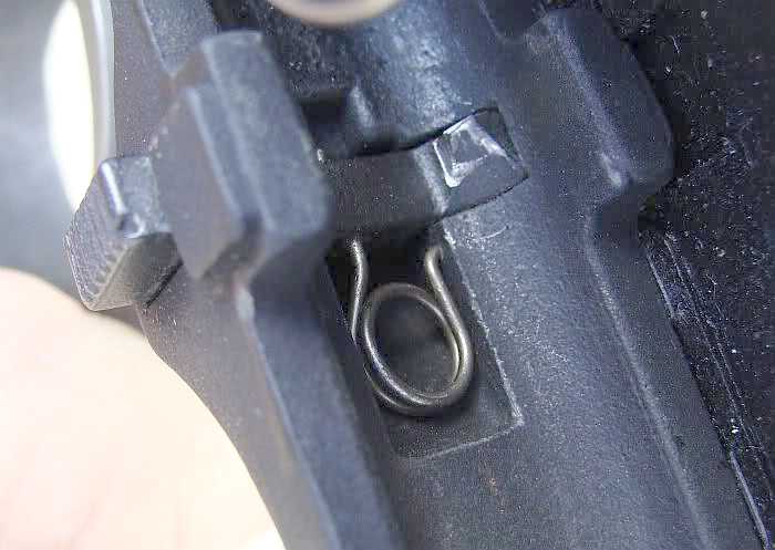

Magazine Latches ...... as in, Magazine Latch Spring ??
Two have broken, I replaced both. For a zero-stress part, I'm still shaking my head over how a zero-stress part will break. Makes no sense to me.
