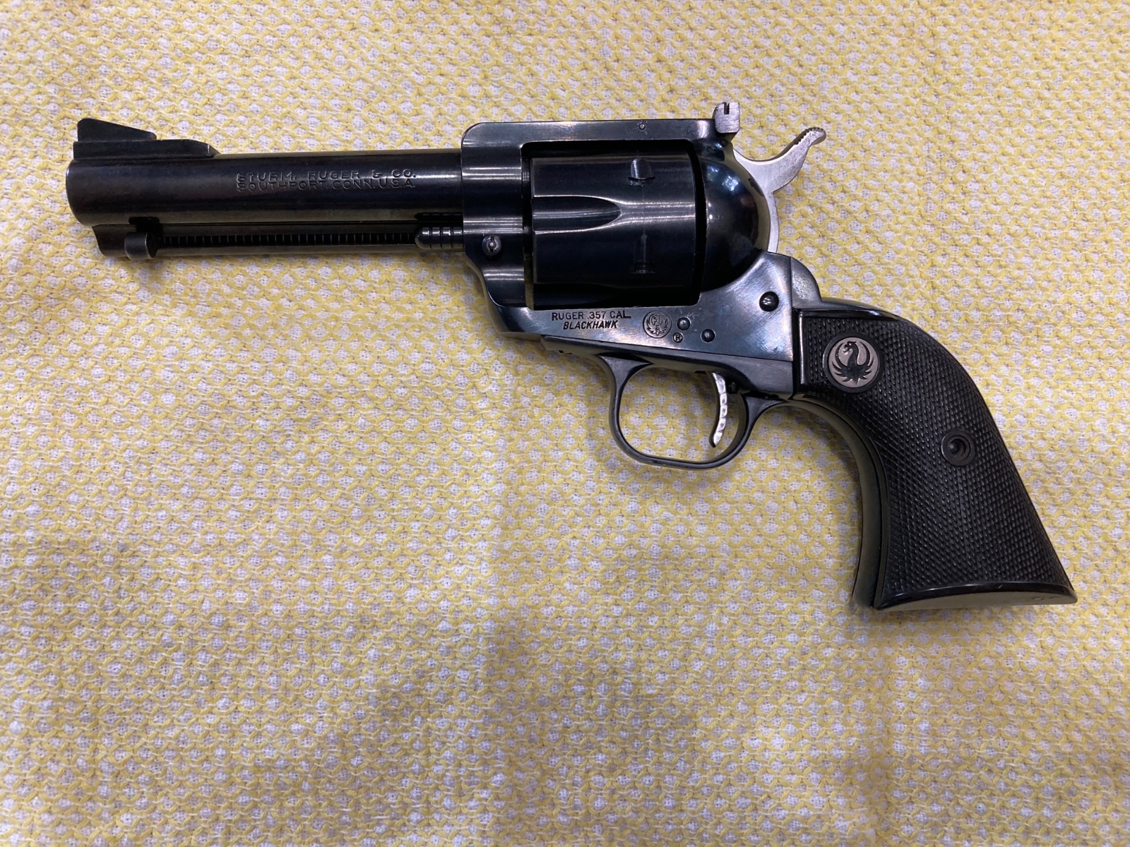

OM .357 Blackhawk FT frame
I got the letter of auth. from Ruger today. Manufactured as BKH3 and shipped in March '59, to AM. Wholesale HDW in Long Beach, Cali. As some one mentioned in a post above, no details what it was shipped with, type of grips, erh, etc. I didn't expect them to as no other letters I have gotten include such details.
The gun is currently at the 'smith's, Got the barrel mounted and timed. Had a bit of trouble with the firing pin. Only recoil plate I could find was a pre-notched or drilled used. In drilling for the pin, the bit caught on the notch and broke. He has it out, ordering a new firing pin, launched into outer space when he removed it! Still in orbit....

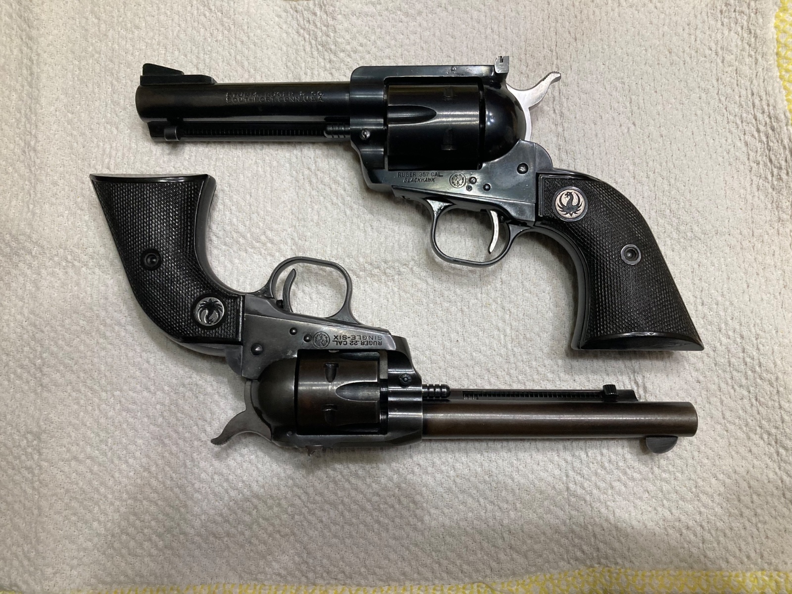

I went to the 'smith's yesterday, we worked on putting the ft together, Ran into some problems with the trigger. I had read that om flat tops went thru 3 trigger changer, the last one in '58. This ft was manu. in Feb. '59, so I thought I was in the clear by having the last, fatter/thicker design. So much for thinking! Got the trigger in, it contacted the gf due to it's being the fatter style. I came home, took the trigger out of my '62 ft, it was of the thinner profile. I installed the trigger we had tried in the frame, and it dropped in place and works just fine. This is the jeweled trigger that I showed in a previous post. Hopefully this trigger will work in the frame, and we can get it back together. I will then have to find a proper trigger for it, so I can put the jeweled trigger back where it belongs.

Thanks much, man. I am happy with it. Thanks to the help from folks on this forum, it is back to its original configuration Couldn't have done it without them! I spent about 3 hours last night carefully filing down the recoil plate. It stuck out about 20k from the frame, not allowing a loaded cylinder to rotate. Jerry Kuhnhausen's Ruger revolvers handbook has a section on installing the fp assy, this apparently is common when installing a new recoil plate. Had to be flush with the frame to operate properly. The OM was built tight! Has a bit of end shake which I put in by filing down the cylinder lug, but almost non- existent. Locks up tight. I was planning on taking it to the range today, but the weather is not cooperating.

Took it to the range today, trying to teach it to talk again!! Shot great for a ground up re-build! I was pleased with it. My shooting pard shot it, did better than me with it. Said he liked it. I sold him a NM BH .357 4 5/8 last year to finance an OM. I think I have created another OM shooter!
