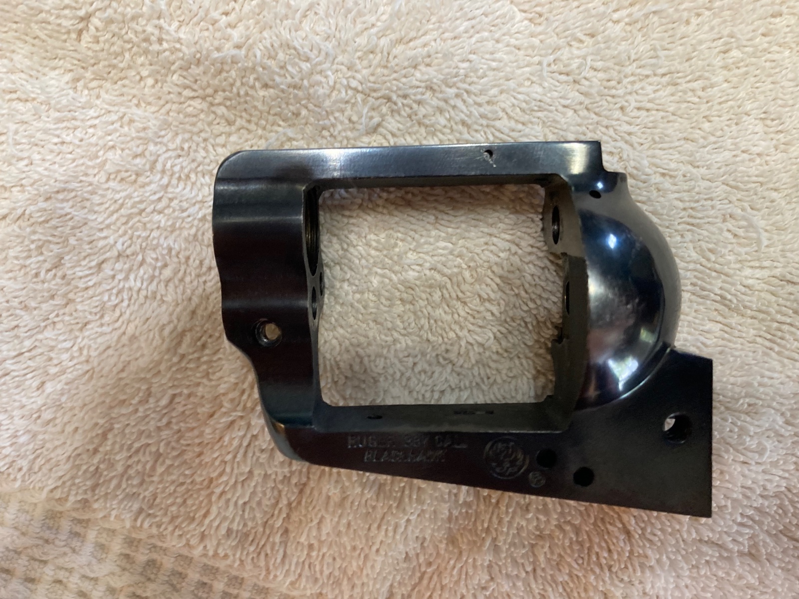

I bought this on Gunbroker a couple weeks ago and just received it. An old model Blackhawk flat top cylinder frame. Has an interesting backstory. First the pictures.
The frame is in better shape than I thought from the pictures!

My plans are to restore this Flat Top as close to original as possible. I have a xr3 gf, a cylinder and a pre-inc (I hope) barrel on the way. If all the mechanical parts are the same, I should have this part taken care of. The rear sight and original hard rubber grips are proving a bit difficult. It will be a while before I need them, as the initial build will take a while. And then it will have to be re-blued. I realize that all parts may not be original to this era, such as the cylinder, base pin and ejector rod/housing, but at least it will be together again. I also realize that the value as a refurb won't be much, but what the hey! Just to hear this fine old piece roar again will be worth it!
My plans are to make this a build thread if any one is interested. May be a coupla weeks as all the parts are dribbling in. But I look forward to it.

You have a cylinder frame marked RUGER .357 CAL. BLACKHAWK and bearing what we assume is the original serial number. If you were to request a "letter" from Ruger on that serial number (a good idea) they would almost certainly advise you of when the gun was shipped and its original configuration. As far as Ruger is concerned it's still that gun. If you restore it to its original configuration matching the "letter" you essentially have that gun, with a few parts replacements. If you use a barrel length matching the original description, all is good, and there'd be no possible hassles from the BATFEIEIO upon a further transfer via an FFL holder. I assume that's how you purchased the frame. Looks to me like a perfect "restoration" of a neat old gun. All JMHO, of course.
FWIW, Bob's List shows 19540 right in the midst of all the other 4-5/8" guns likely shipped in February of 1959. It could be a Type 2 or a Type 3 depending on the ejector rod housing configuration.

I plan on getting a letter from Ruger. I called Linda in Archives Before purchase, she confirmed the serial #, ship date as 1959 to a hdw co, in Cali. Confirmed the 4 5/8" barrel, hard rubber grips, xr3 gf, and of course caliber. I have 3 other Rugers I need to get letters on, will send them in at the same time.

I believe it is a type 3, as far as my studying has gotten me. I think the changes from 2 to 3 happened in '57-'58. If anyone else has better info than me, please share. Thanks again Ale. What I like about this forum, people go out of their way to help! And it is greatly appreciated.
Joey
Bob's List shows a scattering of Type 2's among the Type 3's at that particular time in the serial number list. This reflects the time period when the ejector rod housings were being changed from the Type 2 to the Type 3 and there's a good chance some of each were pulled out of the "parts bin" at assembly. No big deal as far as Ruger was concerned, and I doubt the factory records will reveal which was used on any particular gun. So I guess it really doesn't matter which you use unless you have a preference for "bragging rights". ;) The TYpe 3's begin to show up around serial nimber 17000 and the Type 2's are essentially gone by 19200.
Inasmuch as these housings are what Bob called "screwdriver variations" and could be swapped out by owners it's rather a moot point for all practical purposes. Altogether your call. 😁 I wouldn't argue with either choice.
