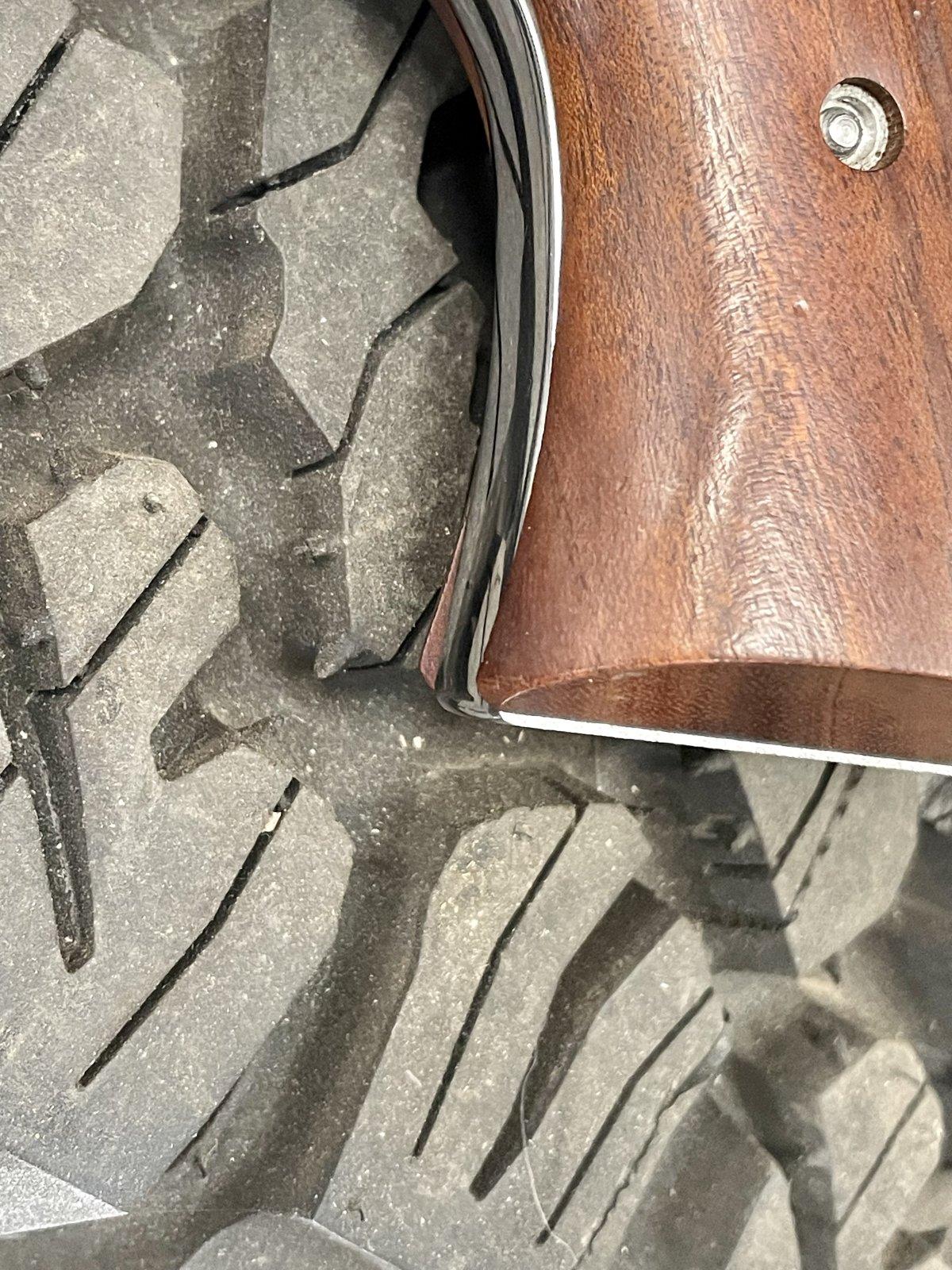

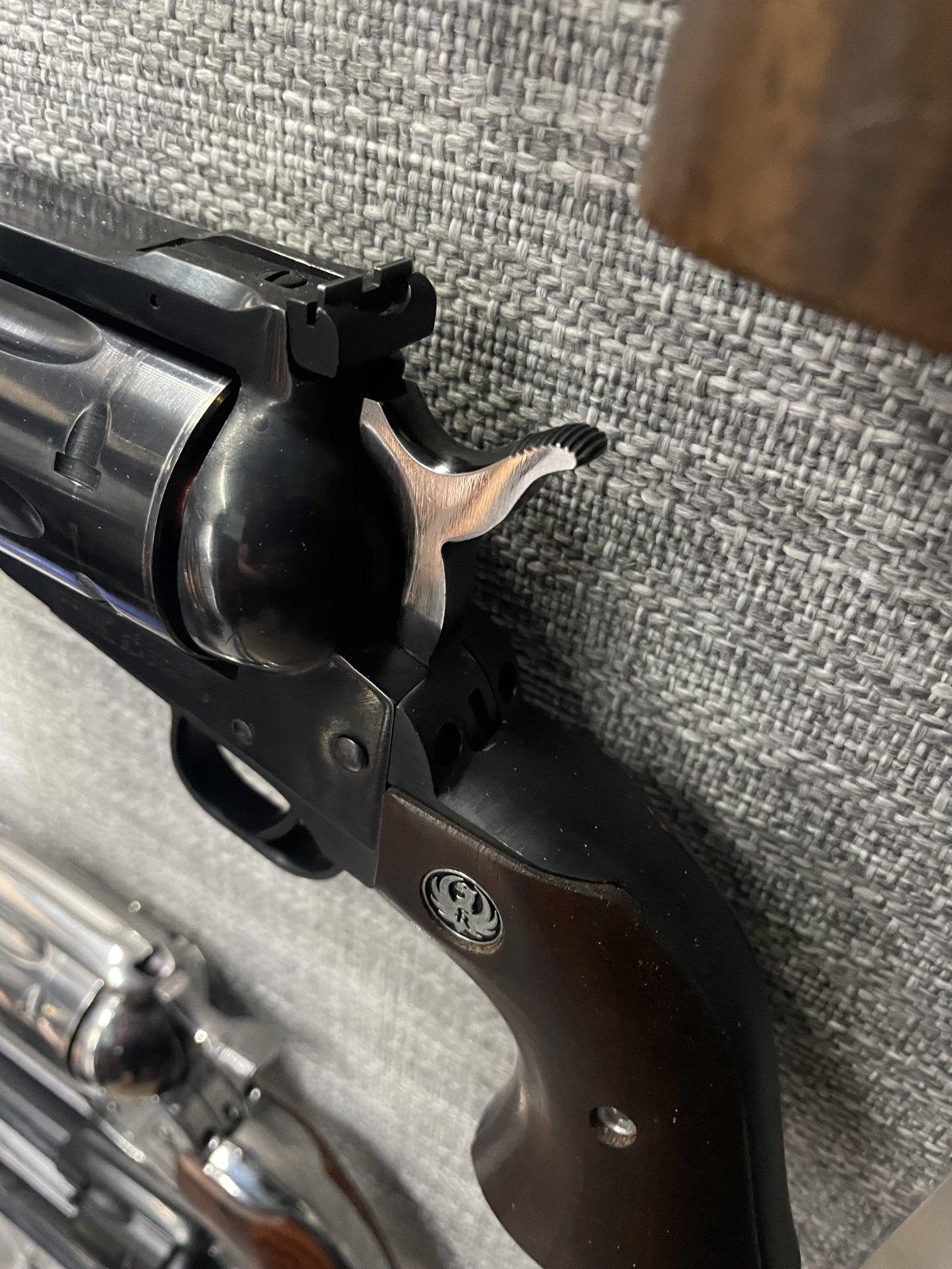

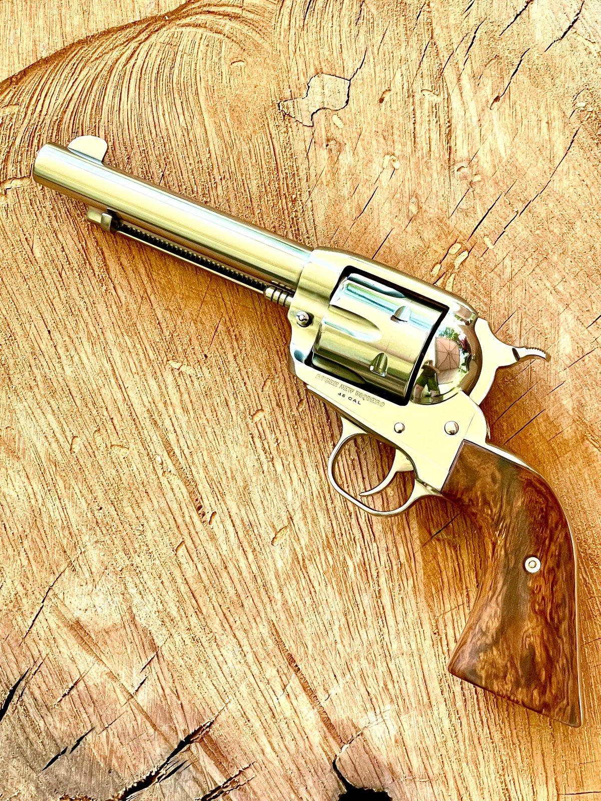

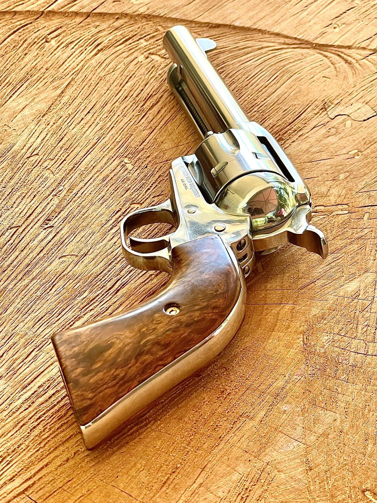

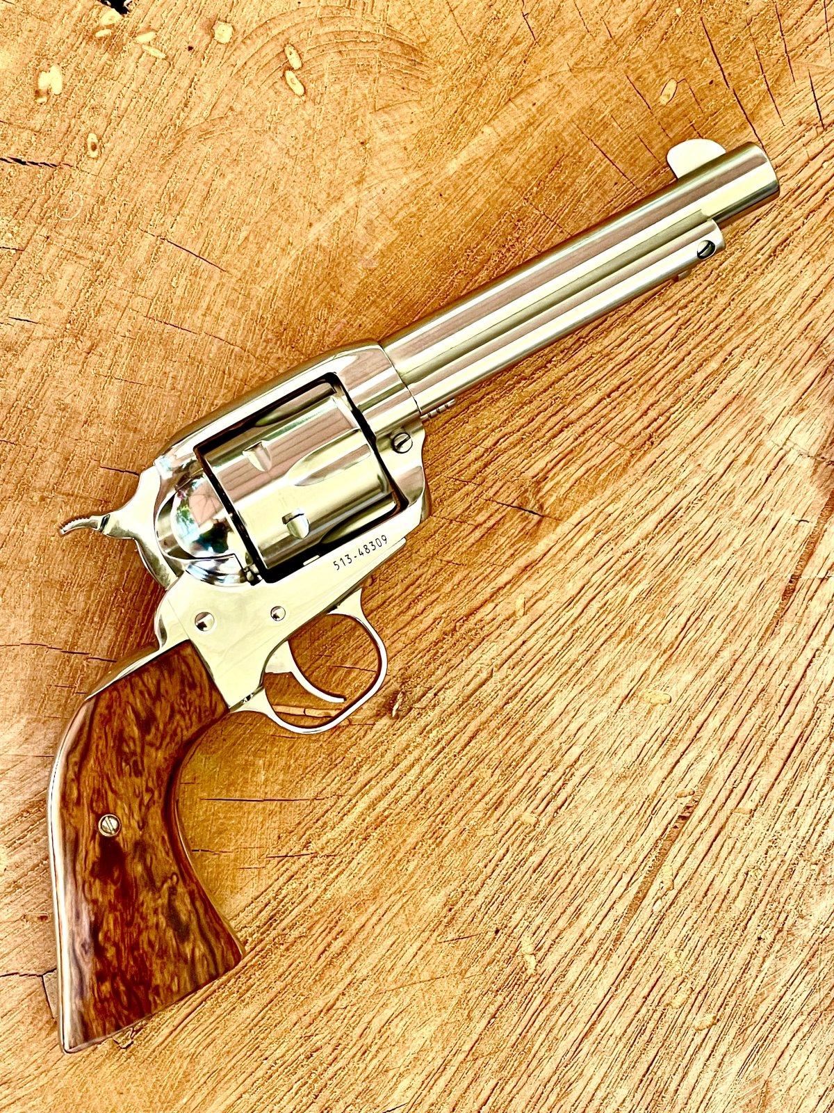

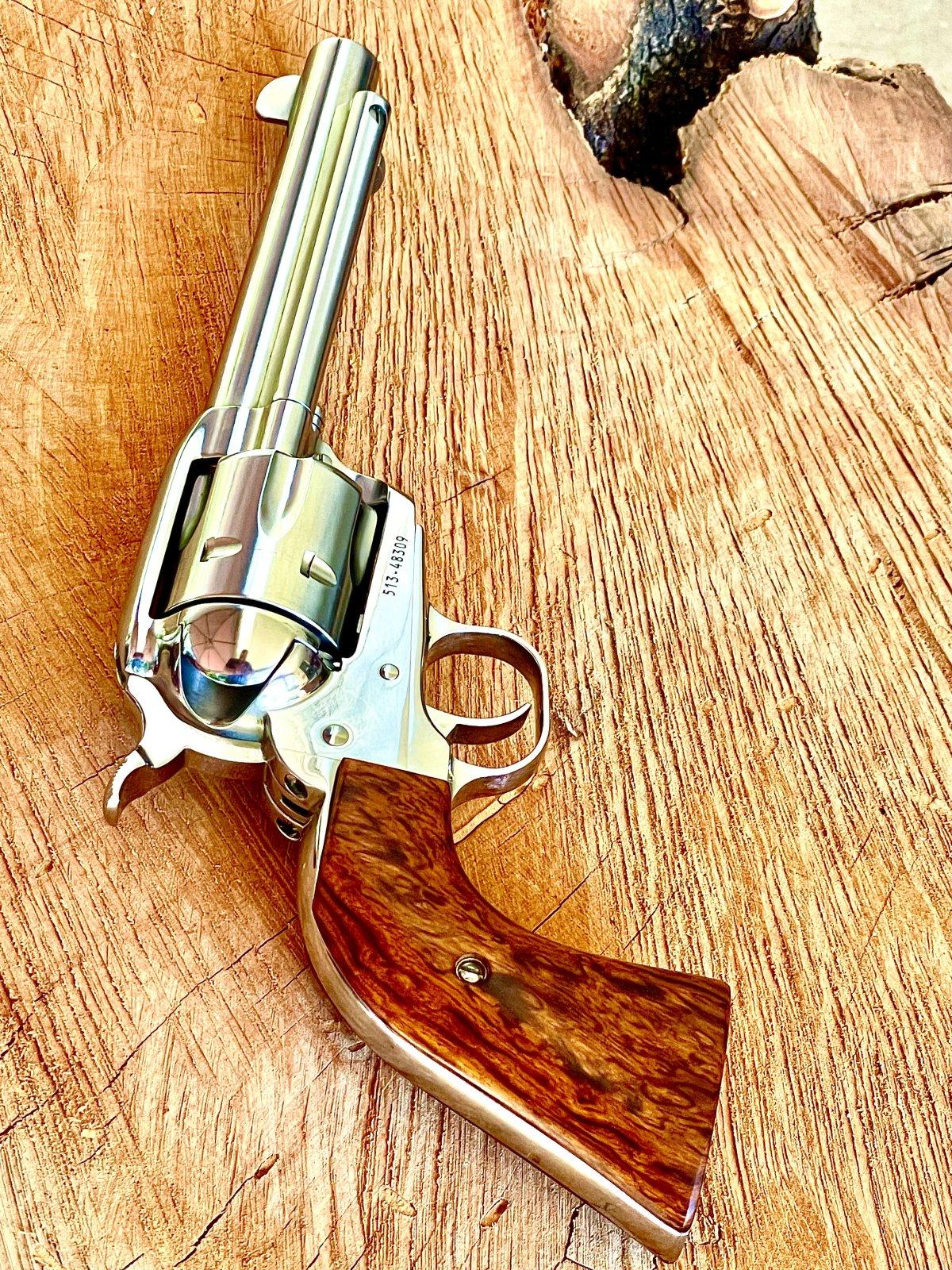

The title sort of gave it away. I decided to build a Super Vaquero. My hands are just way too big for the smaller grip frame on a .45. My New Vaquero is polished stainless and I didn't want to lose the "bling". So when Midway had free shipping I ordered a Super Blackhawk Hunter grip frame in stainless. I spent yesterday afternoon fitting it. Those factory Ruger parts frames are ROUGH! Lots of sanding both power and by hand rendered a good fit. I also took the bottom front corner back a bit- sort of a nod to a Bisley front strap. I spent this morning polishing with my benchtop unit and a Dremel. It came out great! I put a Super hammer in and installed a set of Super grips I had. In case anyone else tries this- the hammer back on the New Vaquero is fatter than a Super hammer, And it will bind up when the Super frame is installed. Also, the Ruger parts frame is larger than the factory grips. Bonus in my opinion. Lastly- the Super frame does not have the little slot that locates the NV retractable pawl. I got lucky and got it ground out- if that had failed a Power Custom pawl would work- probably better.
I've attached a couple pictures. I still need to polish out the hammer, and send the grip frame to Chig's where I have a beautiful set of panels waiting.
The last pic shows how I brought the bottom corner of the front strap in a bit. Feels much better to me.

Great job and a very nice looking gun.
As a collector, and someone who gets questions all the time about various models of Rugers,, I had to pause a bit at your title. To use the term; "Super Vaquero" is fine for you & all,,, but it might confuse folks who are new to Ruger SA handguns!
Ruger does a good job of confusing folks with their nomenclature,, so I try to help folks understand the true differences, done by the factory.
Your "Custom Vaquero" is a sweet looking (and I'm sure great handling) gun .

I knew I'd get tagged on that! 😆 I actually started the thread with a different title- "Vaquero with Super Blackhawk Hunter Gripframe" but it looked awkward in print so I went with my catchy nomenclature. Actually, my current title is also wrong technically because it it a New Vaquero. Oops!
I'll be more thoughtful in the future. No hard feelings- I appreciate your diligence in keeping things correct.
Your comment did make me ponder- if Ruger built this version, what would they call it?

Good work. They're not ours until we make them just the way we like them.
The larger diameter hammer base of the NV requires the 'horns' of the grip frame to be worked down for a proper flush fit.
Thank you! I've always had the "custom" bug since I was a little kid. Couldn't build a model car without a few personal touches. I guess it's in the blood. I'm having a hard time not tricking out the 3 Screw Single Sixes I've purchased recently, but there's something about the age and originality I respect. I may buy one to "make it mine".
I had to work both the grip frame horns and the main frame horns. So now there's no real going back with the original grip frame.
