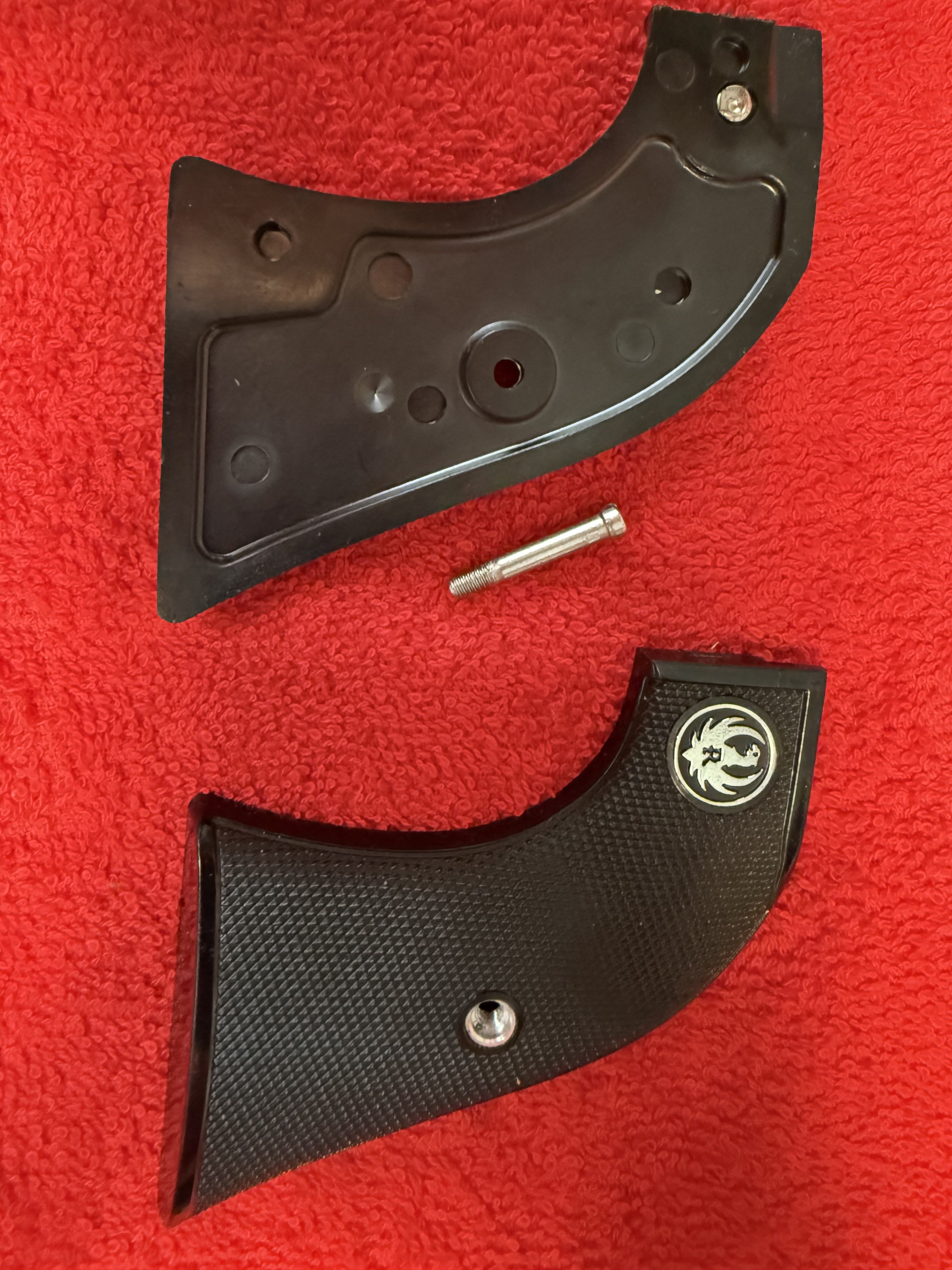

Can anyone tell me? Are these Ruger or aftermarket? If Ruger what were they used on and when? They fit XR-3 Red grip frames perfectly.

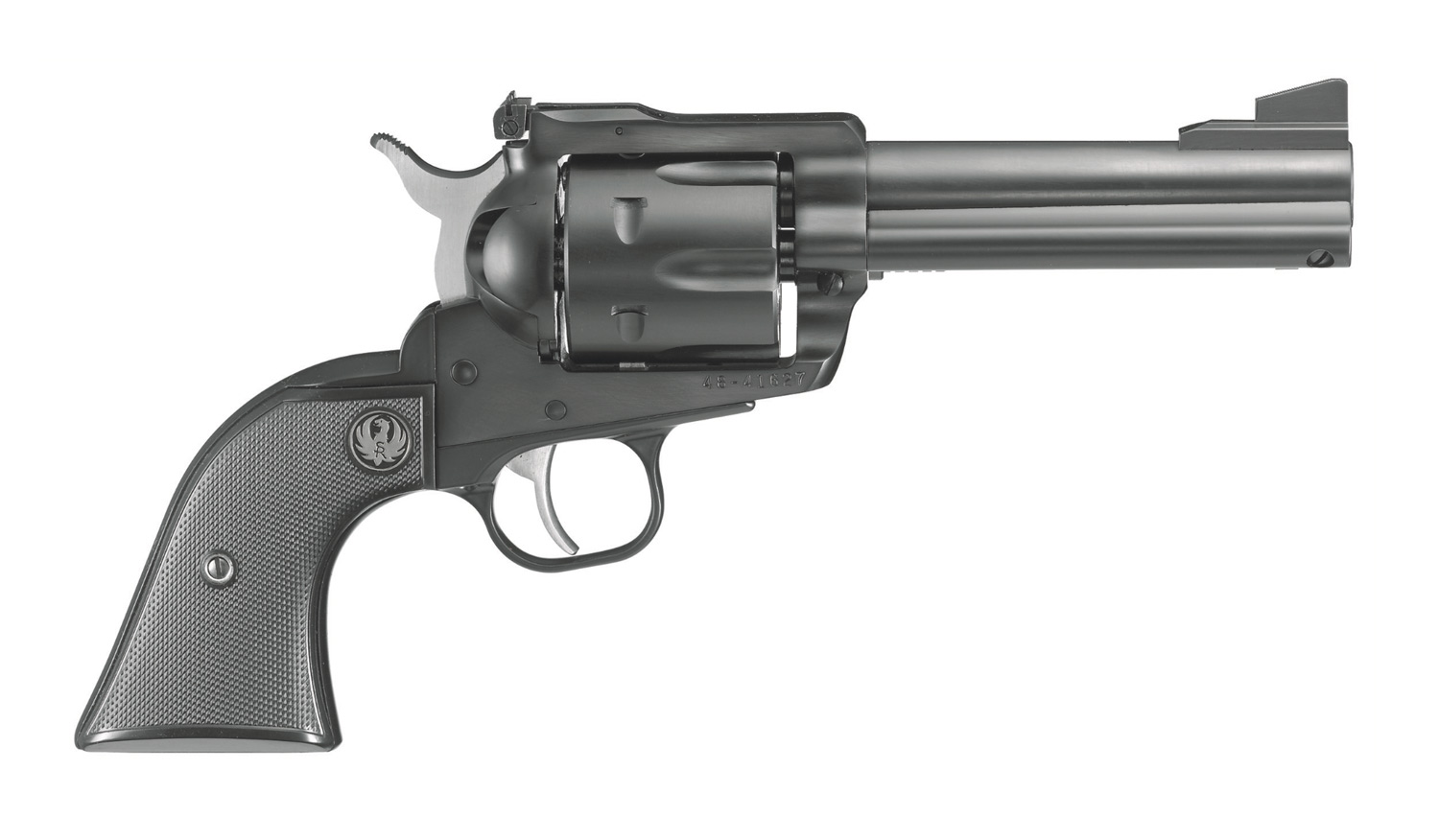

They put them on the New Model Flattop single action revolvers. They were nicknamed on here as the cheese grater grips. Others can tell you what other single action models Ruger put them on.

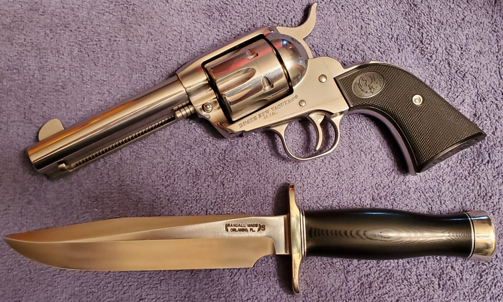

Add: I believe they might have used them of some Vaquero models, as well.
I've seen those, but in the smaller (XR3) size. I believe that the screw was offset to clear the now-discontinued lock......
But I don't follow the NM's all that closely, so I could be wrong.

Given that you have XR-3 Red frames and panels that fit them perfectly, I'd lean toward them being original Ruger plastic grips from the mid-1960s.
If the grips are current would they still fit a sixties Blackhawk? Are they the same as current factory grips? Do all Xr-3 grips fit all Xr-3 frames? You would think they but I'm not sure. These grips came with a 68 Blackhawk and they are a bit thinner than wood grips, wondered if they were original or used by someone who needed or wanted a smaller grip.
"Given that you have XR-3 Red frames and panels that fit them perfectly, I'd lean toward them being original Ruger plastic grips from the mid-1960s."
Wrong. The medallion type, PLUS the internal shape, as well as the screw hole location is not the same as the original Butaphane grips from the 1950's & early 1960's.
The frame shape,, IS the same,, XR3. However most often,, the grip locator pin hole in the grips will not align with OM XR3 grip frames. So, in general,, the new ones,, like shown above,, won't easily fit on an OM,, unless you modify the locator pin hole. This has been done on some grips I've seen.

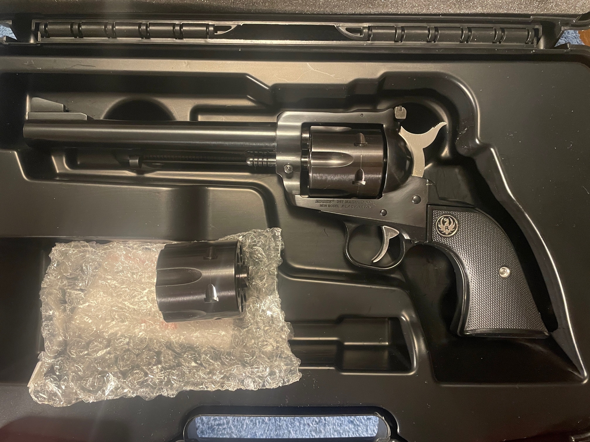

All of my NM/FT's have the S/R grip medallion or the solid Black Eagle with neck feathers.
Do you know of a NM/FT with the Hard R ?
Yes. I don't have one, but I just now looked online at the NM FT images and in the first 15 or so images I enlarged all had the hard R on the medallions. Apparently the change from S/R to to R happened during the FT run.
Thanks for pointing that out!(y)
Went and checked out the NM/FT images & found the hard R on the .357/9mm model.
I do not yet have those guns in my collection yet.
Maybe Chad will see this and can verify the year of change, I think is was around 2017. :unsure:
So any NM/FT revolvers will have the hard R....:(

I agree with Contender regarding pin holes. I have a set of newer grips that someone modified the pin holes to fit an older model. The hole modification is very obvious and even with that they really don't fit well. That is what made me wonder about these grips as there is no obvious modification to the pin holes but I do agree about the "R" not being correct. The hole either has to be enlarged or widened to fit an older model.
I need to correct my initial post. They don't fit perfectly. They came on the Blackhawk, didn't like them and replaced them right away.
I installed them on the revolver today and took closer look. They stick out ever so slightly at the bottom and they aren't even with the backstrap. Another thing I noticed is the screw holes are not in the same location, there is a 3/16" difference in height. The one thing that is the same is the size of the pin hole both are the same just a bit over 5/32" the pin is 5/32", this is what led me down the wrong path initially. I apologize for any confusion I might have caused! At least now I know for sure what they are not!
Besides all the obvious things,, (to me,) those grips have a totally different internal image & shape from the 1953-1963 Butaphane ones.

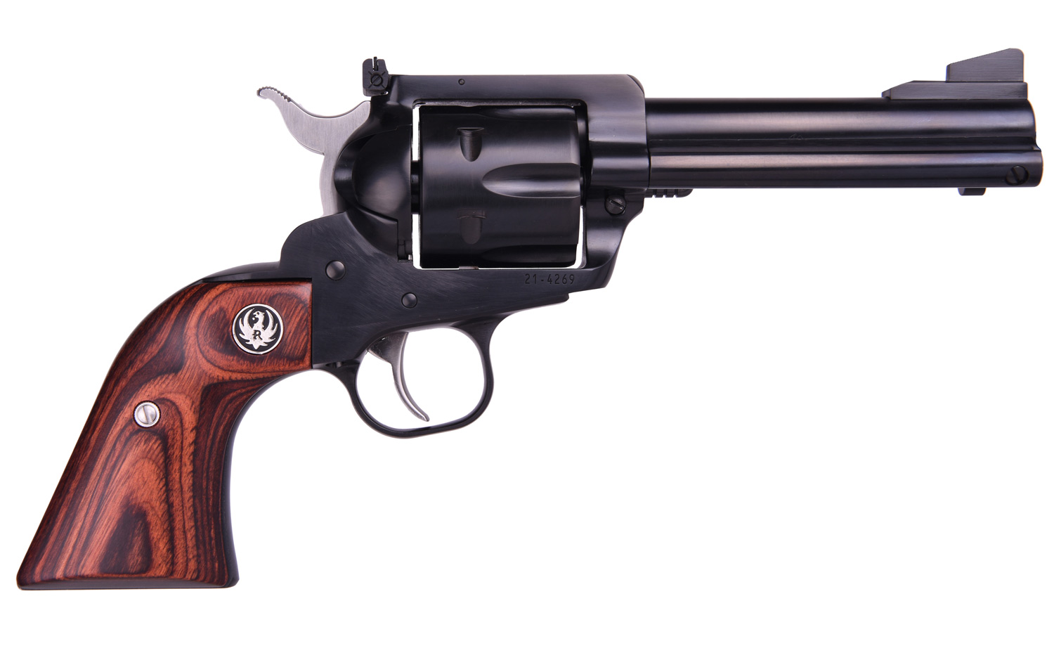

I believe most of the newer New Model flattops have the silver phoenix like the non flattop in the pic above. The 2005 and 2006 anniversary flattops have the black phoenix without the letter logo. I don't know when that changed to the silver phoenix with the hard R.
I'm not sure that's the phoenix....It looks more like the Neck Feathers or Squashed Chicken to me.
DGW
As far as I know the bird in the medallion has always been referred to as the "phoenix", clear back to Alex Sturm.
The medallion in post #25 is the current "hard R" and it does almost show neck feathers and is kinda "squished to me. JMHO
I stand corrected, the newest flat-tops have silver eagles but that must be a recent development. Either way, the grips in question are New Model XR3-RED.
