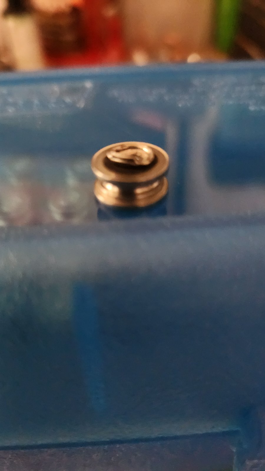

The casings are absolutely NOT re-sizeable. I tried to neck size 1 and the base tore off leaving the broken case stuck inside my die. It was well lubed.
For non-reloaders these are pretty nice but for me its a NO. My Alpha brass works just as well and some have 15 firings on them.

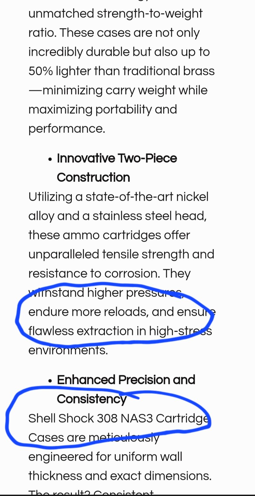

Apparently SS says in their FAQ section that their brass is not reloadable. However, the danged description says otherwise
I'm not really clear why an alloy other than brass is desirable for the top half of the case. The fully supported chamber area is not really limited by the flow stress of brass like the case head is, SIG has shown this with their hybrid case loadings for DoD. Those cases are reloadable, I've formed surplus ones to a couple .308-based cartridges. Not yet sure how well they stand up to repeated use.
