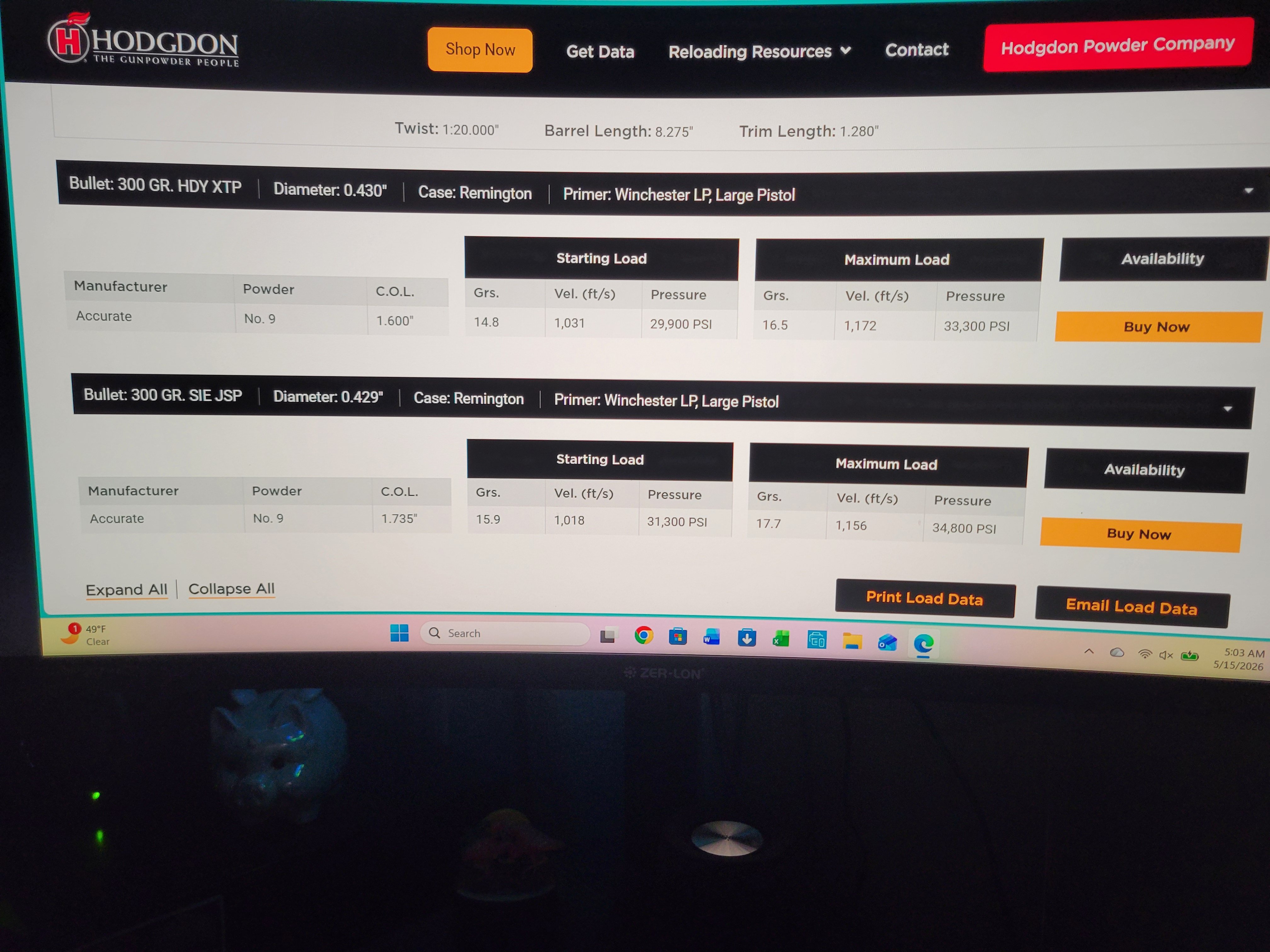

I had some 300 grain Laser Cast bullets for YEARS.
I also had a small amount of 2400 powder. Price of 2400 is crazy.
I tried 14.5 grains. Nice load. About 1000fps.
It kicks more than I am used to but way less than the Keith 240 grain load.
I am going to try the same idea with AA #9 when it is back in stock.
Images are from the Laser Cast manual
and Hodgdon website.
