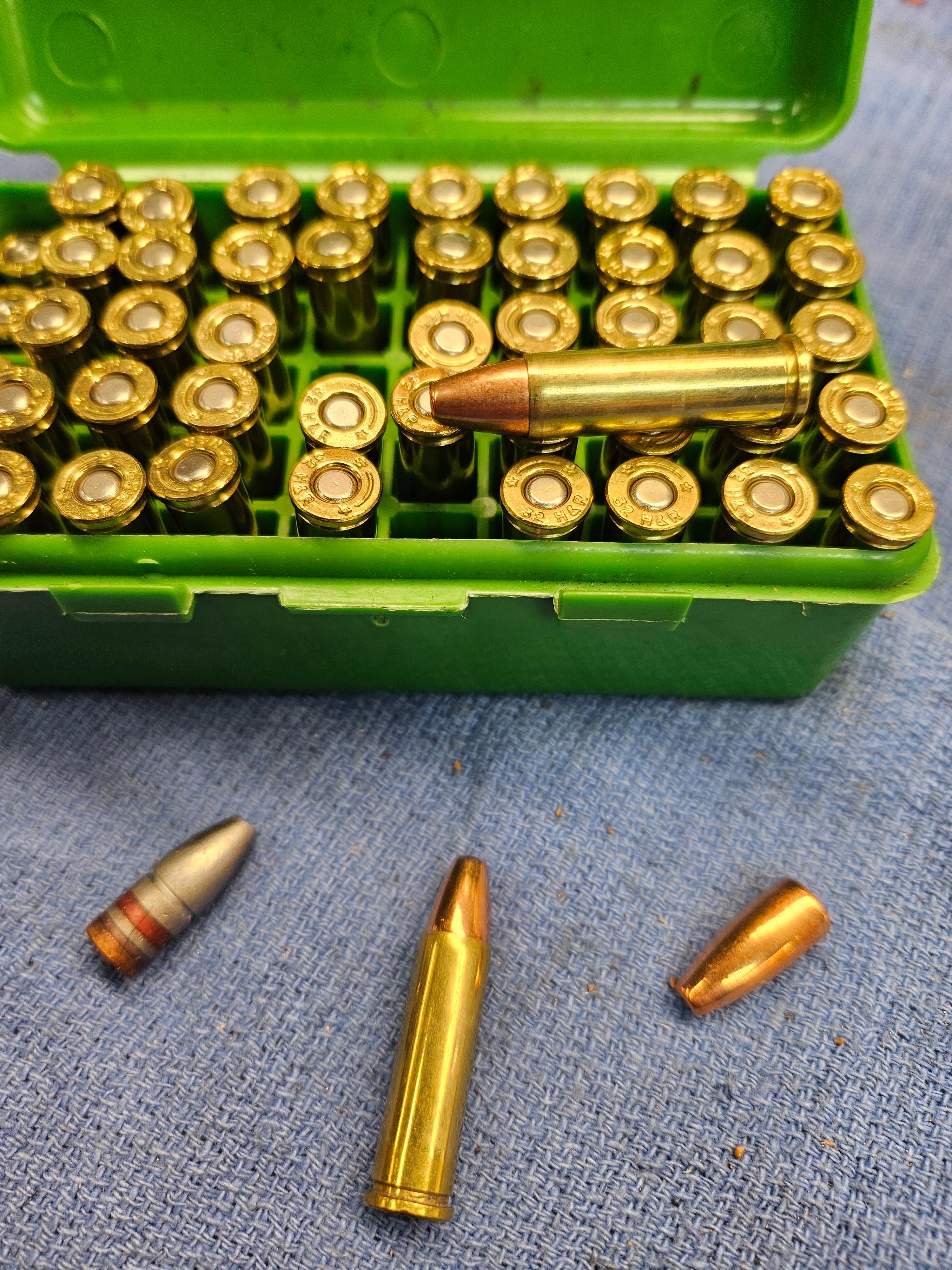

I load a 100gr cast swc over 2-2.5 gr 231 or bullseye for revolvers.
But for my Marlin rifle, it's 8.0gr 2400 under a 123gr sks flat nose spire point for 1440 fps.
2" groups @100 yards.
