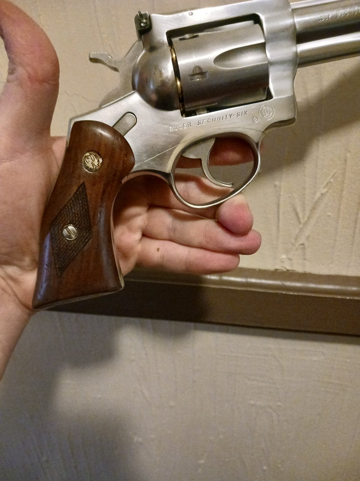

So I found a good deal on a Security Six last month and couldn't pass it up. Stainless 4 inch, pretty much exactly what I wanted in a 357 revolver. Took it to the range and decided the factory wood grips do not go well with hot 357 so I ordered some rubber target grips. Come to find out the grips will not fit and that's when I learned about the low back Security Six.
I tried to modify the rubber grips but that did not work. The only aftermarket grips I can find are the Jay Scott grips but they don't look like they'd make a difference over the factory stocks, they look to be the same size. I can't find a set of the Herretts,which would be perfect, but I'm keeping an eye out. Does anyone here have any suggestions?
Someone on another forum said they modified a set of Pachmayr grips for a Redhawk to fit their low back but I can't get any more info on that. I'd like to know which Pachmayrs (presentation, gripper?) and how it was done exactly but this person hasn't got back to me. I'm thinking about trying these Tuff 1 universal grip covers I saw, I'm thinking if I overlap 2 or 3 it should give me the effect I'm looking for.
Anyone know of some grips I can make fit a low back? I'm not really trying to spend $200 on a set of custom grips.
What's really interesting is it has a 151 SN, just my luck since all the aftermarket grips say to make sure your SN is 151 or higher 🤣

Back in the day, there were some Low Back grip choices. After the change to the High Back, replacement grips dried up.
I have some Jay Scott replacements. I don't care for them, but they are substantially thicker. You should try a pair. They may be what you're looking for.
The Low Backs, especially stainless Low Backs, are sought after. Have you considered trading this revolver for an equal revolver of the High Back variety?
You're right. Most Low Backs are 150-series. There was substantial overlap of serial number prefixes during the change from Low Back to High Back. Some of us purposely look for 151-series Low Backs.
Lastly, we'd really like to know the serial number. Leave the last two digits off it it's more comfortable. :cool:
WAYNO nailed it!
Your grip selection will be mighty thin. That’s the bad news.
Your stainless LOW back is pretty scarce ( rare? ). That’s the excellent news.
The same #8 Tyler T Grip that works on the high backs and Redhawks also fits your gun. I use a Tyler T Grip on my Six Series revolvers.
There’s several well respected members here from Ohio. You may get lucky and be close enough to meet up with one of them at a gun show and they might have some grips for your needs.
WAYNO- The Jay Scott's I found on ebay look almost identical to the factory grips, thickness and all. I heard they made over sizes grips too so I'll keep a look out for those. The Herretts are what I'm really looking for. I've thought about trading for a high back or even a different model but due to the rarity I'll probably only do that as a last resort. Worst case I can use it as a glorified 38 special 🤣. SN is 151-093xx
Hittman- Thank you! I've been considering the Tyler T's also, I was thinking about the BK Grip it's basically the same thing but cheaper. The only reason I haven't ordered it yet is because the issue for me is more about thickness, I don't get alot of purchase at the bottom of the grip unless I move it more towards the center of my palm where there's no meat lol.
jaybowjm- thanks for the offer but honestly I want to try to find a solution before I go that route. If I do I'd want to trade rather than sell and I'd do it locally here in Ohio.

Got ya...although I may have just found a solution. Not 100% sure I'm going to do this but if all else fails I found out on another forum the Pachmayr Gripper grips will work on a low back but you have to punch out the grip panel dowel in order for them to fit. I'm not sure I want to start punching out pins but if I absolutely have to I'm sure it'll be fine.
Sorry, I failed. Found 3 pairs of older Security Six Pachs, another 10 Point brand set of rubber, a set of Mustang finger groove zebrawood, and a large set of wood with a RH thumbrest. But none fit the lowback gun. I know for a fact that I have a set of Jay Scott imitation stag lowback grips somewhere, they were factory made with thick spacers, but I didn't see them in the 2 boxes and 3 bags of grips that I looked through. I do remember piling a one cubic foot box full of old Ruger grips a couple years ago, taping it closed, and putting it somewhere for safe keeping... a little too safe it seems.

If you are interested in doing your own grip finishing, I have a set of zebrawood grips for the Six series that can be cut for the low back frame (in fact I already did the outline. They look like this (9th one down): https://www.gunpartscorp.com/gun-manufacturer/ruger/revolvers-ruger/security-6 If interested we can talk.
I might just be interested. I'm going to be honest I've only ever done basic wood work. I'm good with sanding, staining, drilling, like real basic stuff but I have no idea how to set the little bolt for the screw.

Can't start a "conversation" with you yet but if you are interested I can cut off the excess wood and you can finish the project. You'll need to get a grip screw and escutcheons from Brownells (or Numrich for OEM parts) and either use a drill bit and straight wall countersink or the escutheon drill bit from Brownells. Truthfully, that may be more than you want to spend unless you plan on making more grips on your own.
How much would you want for em? I could probably take the bolt and screw from the 151 grips that didn't work and use those. I'm sure I can figure out how to set the bolt it can't be too hard.

I couldn't find the elusive low-back pachmayrs either, but I just took an exacto knife to the insides so they fit.
Update after re-reading the inital post: Looks like you already tried that! Good luck with your search. I used the largest presentation grips I could find.
The grips I tried weren't pachmayr they were sile so maybe the pachmayrs will work? I might have to take the locator pin out of the grip frame though and I'm not sure I want to do that.

My dad made oversize grips for his lowback Security Six and he didn't need no stinkin' escutcheons! He did the old hexagon peg in a round hole trick and force-fit a brass hex nut into an undersized hole in one grip and used a large head brass screw that wouldn't sink into the wood on the other side.
I wish I could find those grips to show. When I inherited his guns, I took them off and reinstalled the originals and put the gun back into its factory white box with die-cut insert that would not accomodate the large grips. I remember tucking dad's homemade grips into his homemade holster for safekeeping, but I can't find the holster either. My dad died 25 years ago this August, so it had been a while.
I'm sure I can figure out a way to make it work one way or another. I've been watching some videos on how to do it. Sorry to hear about your father, 25 years is a long time but still it's never easy.
I don't know how many posts it takes before you can participate in the conversations (private messages) so I don't want to give out my email or phone # on this "open" thread. But I will tell you it would be $30 shipped if I do some of the cutting and $20 shipped if I leave then they way I got them (with all the extra wood from the original rough shaping). I will also mark where the grip screw goes.
