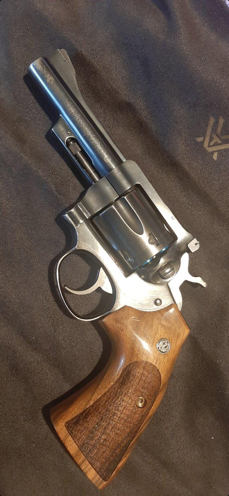

I looked again for those lowback grips my dad made and still couldn't find them.
But I did find a different set of grips he made, along with a holster for a 4" Security Six that is a later highback gun with a 154 prefix and the warning barrel.
I'm not certain but I believe the wood is Texas mesquite that he harvested from my grandfather's small ranch. He took it back to Colorado and dried it for a year or two, then made several sets of grips out of it and I think these are some of those. I still have the leftover mesquite from that.
Anyway, his grip making skills had evolved by this time, and he rounded out the brass hex nut on a redneck "lathe" (screw chucked into an electric drill clamped into his bench vise and file). He also added a small slot to these at the bottom of the grips to insert a pry tool to get them apart. These grips wrap around the front of the frame but leave the backstrap exposed.

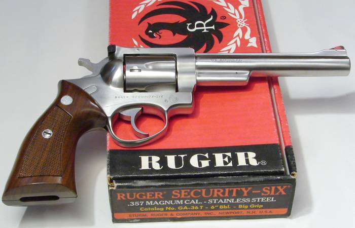

Those smooth oversize grips came along closer to the end of Security Six production on the "T" (Target) models.
This one is a 161 prefix and also has the fairly rare "RUGER" in huge lettering on the side of the barrel:

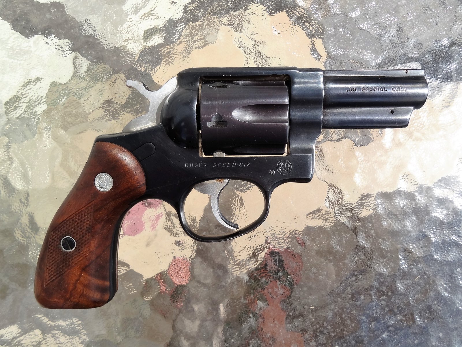

The more common Target grips are the checkered ones with more of a S&W grip profile:

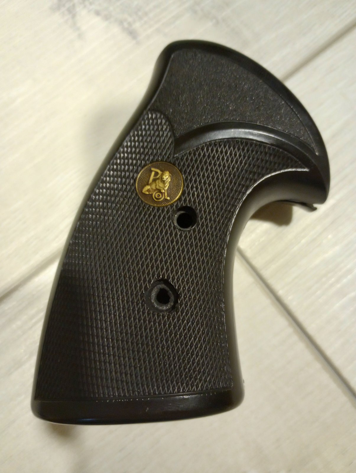

For anyone interested if you want to modify the large presentation pachmayr from highback to lowback.
Not my best work, I did this a long time ago, but here is a picture of the inside after I removed material. Bottom locator pin is in the same place. I had to drill/tap through an embedded steel plate to mount a new screw, I don't use a nut on the other side but did recess the screw head.

This might be a project I'll have to try eventually 🤔 although I'm going to buy the unfinished stocks from Ronin for the time being and finish em up. I'll update once I have em finished up.
