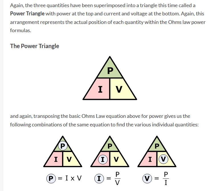

P=IV **** Power(W-Watts) = Current/Amps(I) X Volts (V) (I learned this as PIE)
from the above formula Amps = P/V
Amps = 1500/120
1500 watt appliance draws 12.5 Amps
Clearer version of the formula (good for generator estimations too)
Put your finger over what you need to know. What's left is formula to figure it out.
