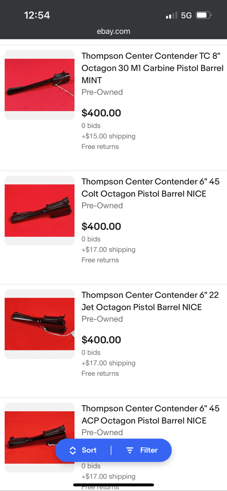

Same guy just listed these. Says part of an estate sale. He doesn't know anything about them. 6" octagon .22LR & .44MAG. Anything is possible, but without any documentation I think they were cut down.
What do you guys think? Special order? Cut down? Pretty neat looking for sure.
Same guy listed all of these 6” octagon barrels. I’m having a hard time believing they aren’t all cut down. Maybe he special ordered them? 🤷 the crowns all look good.

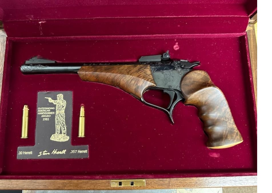

Admittedly a HIJACK.....BUT...THIS IS THE AUDIENCE TO ASK: Any of you know the real history of the Contender french fit red cloth lined hinged wooden presentation TC boxes? I have a pair that came to me years ago sans Contenders. One of my old commentors said that there were only a small number made and offered...........I would appreciate more and correct info, please

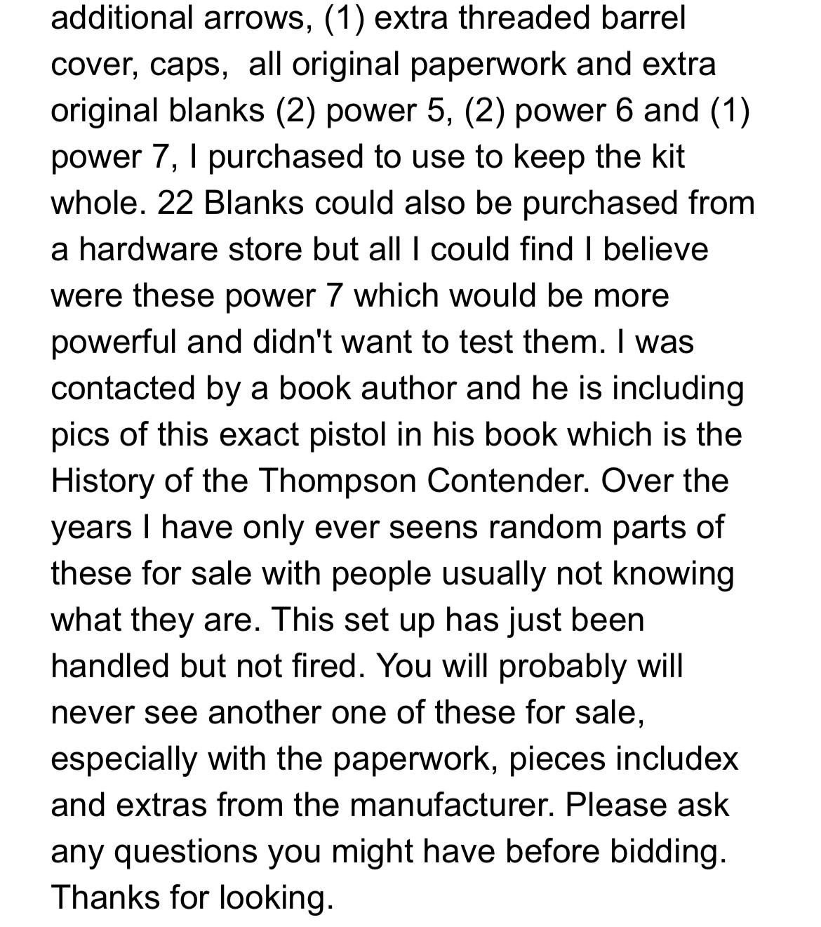

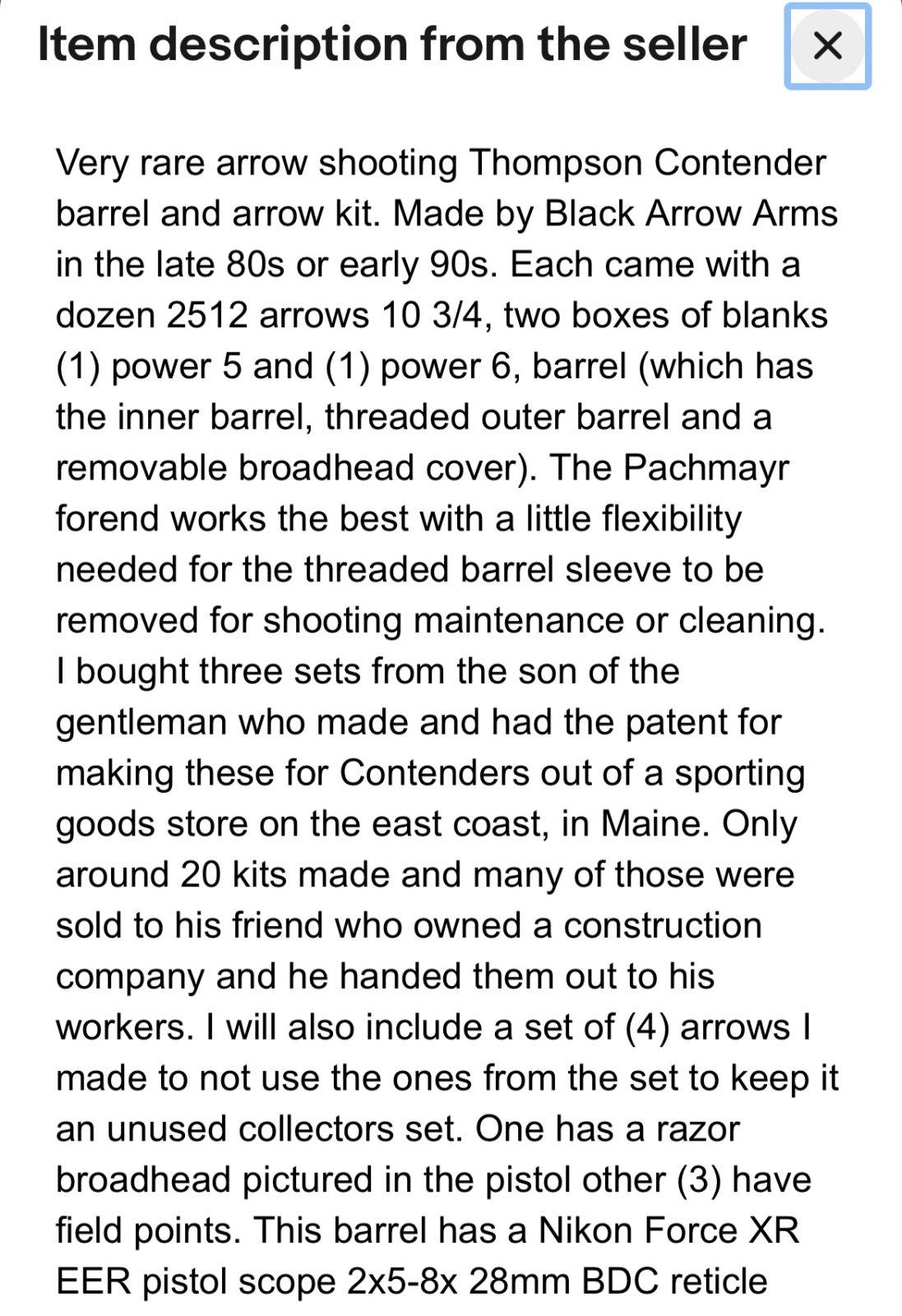

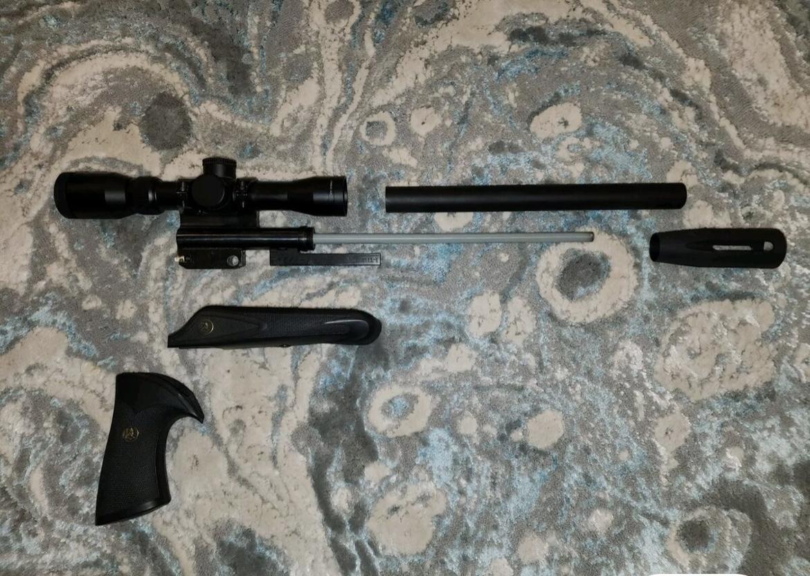

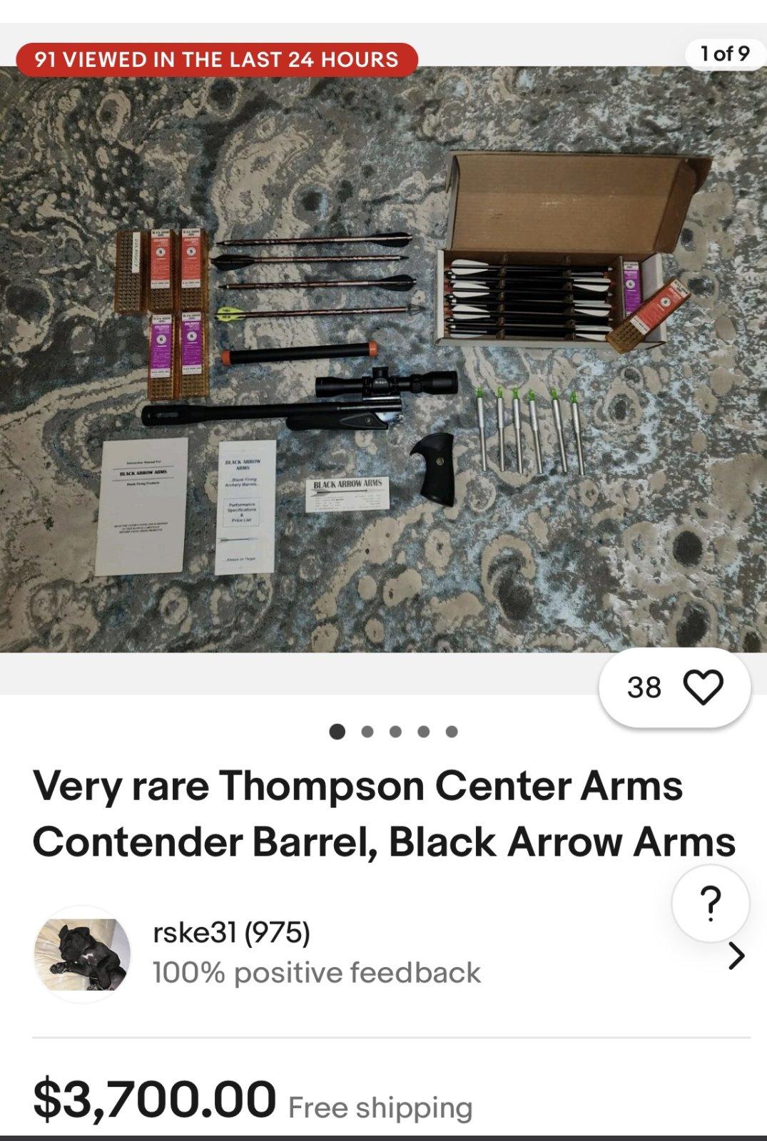

I seem to recall that about the arrow shooting gun using the Contender set-up. And I recall thinking; "It's not a factory item,, but kinda neat!"
I can't recall if I ever saw any pictures but I do know I've never seen a set.

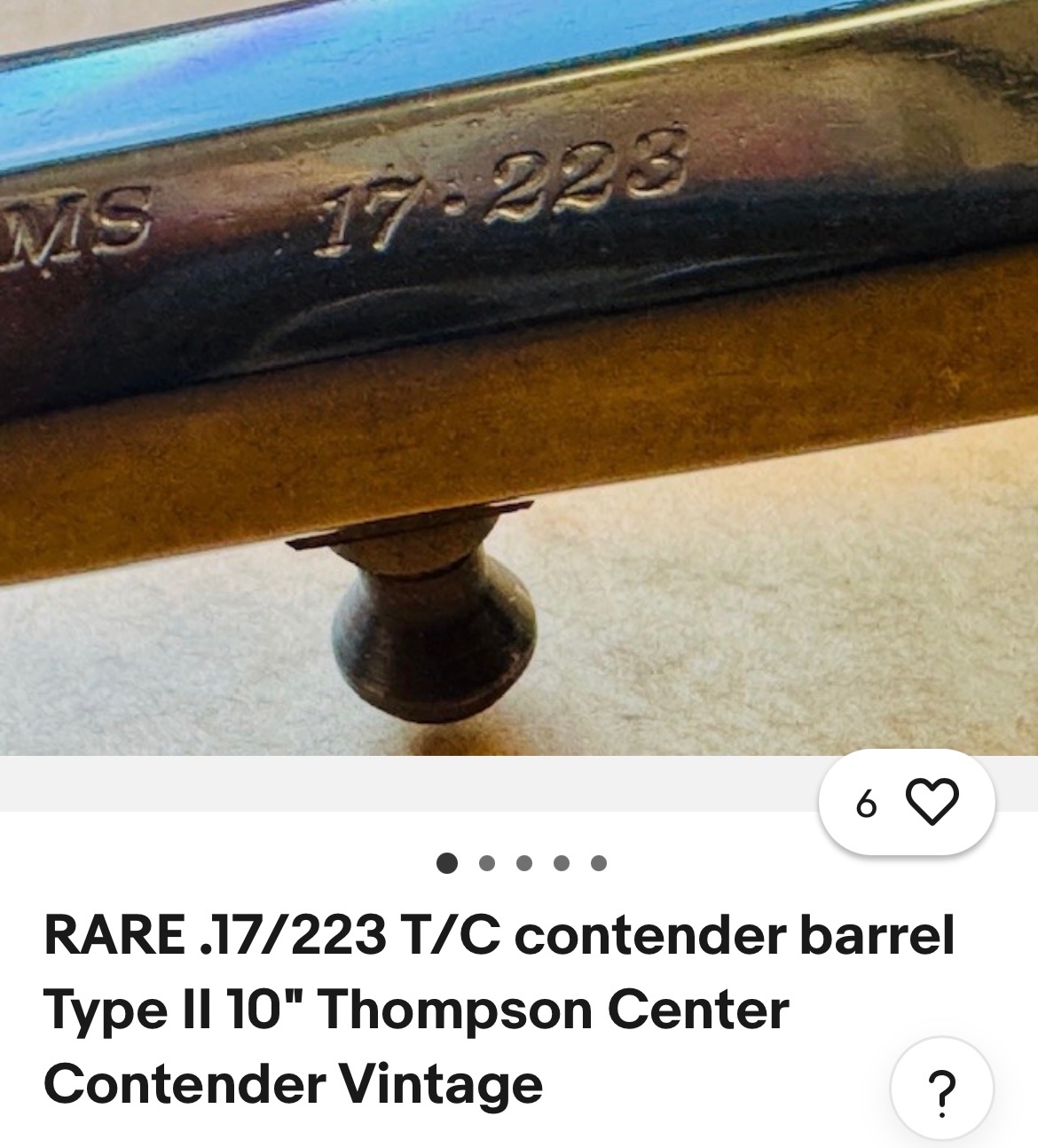

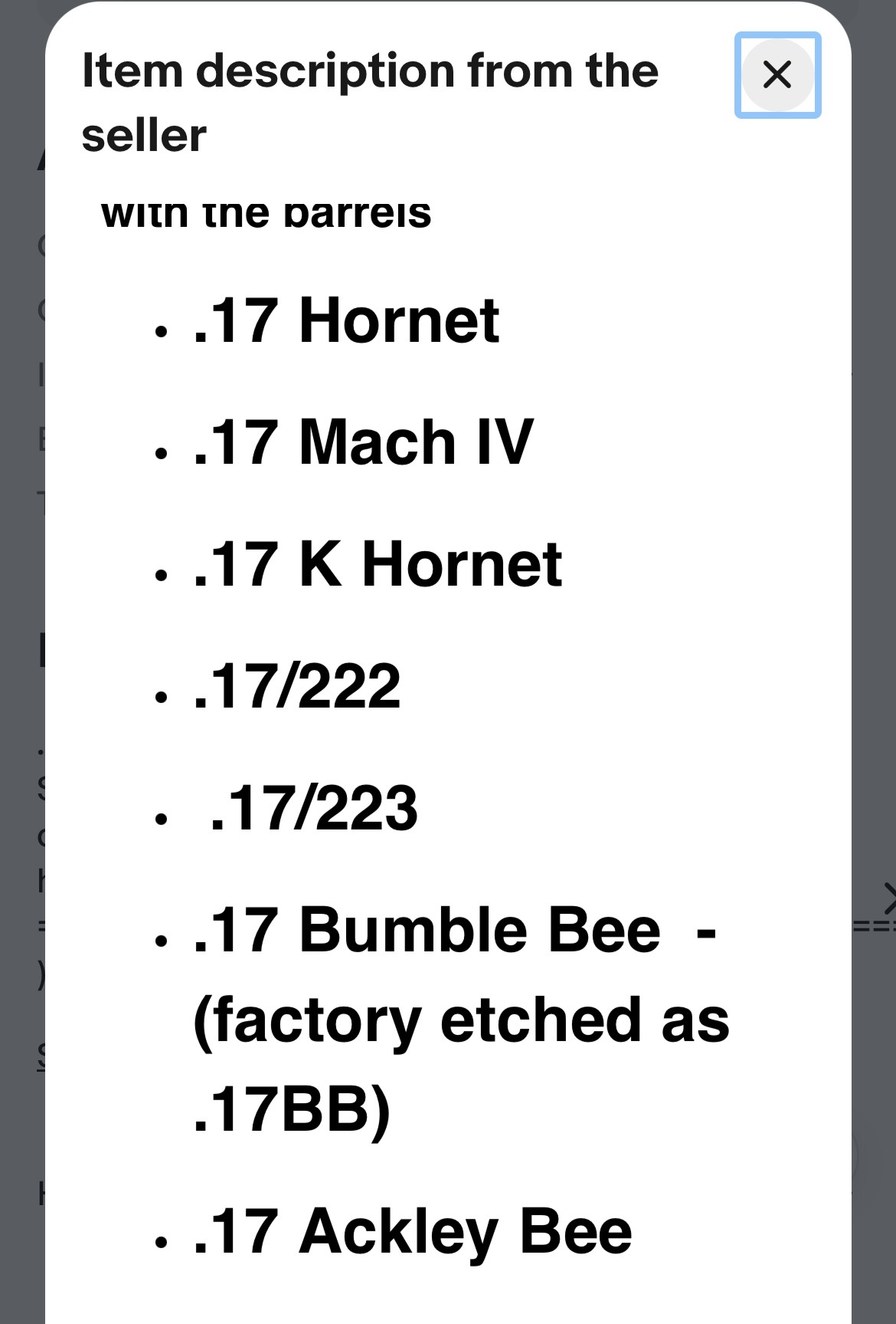

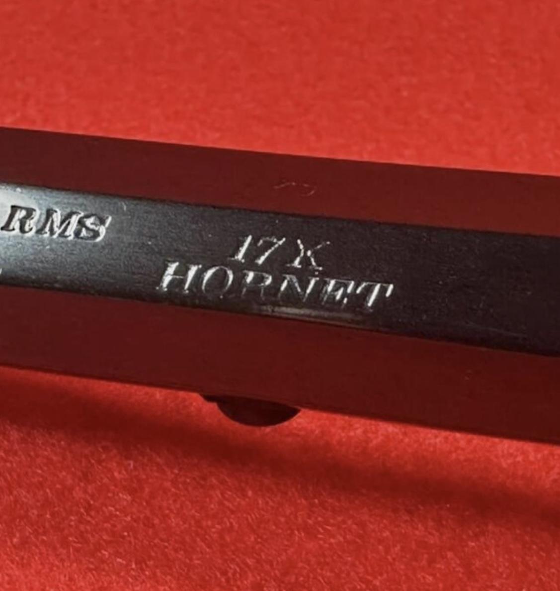

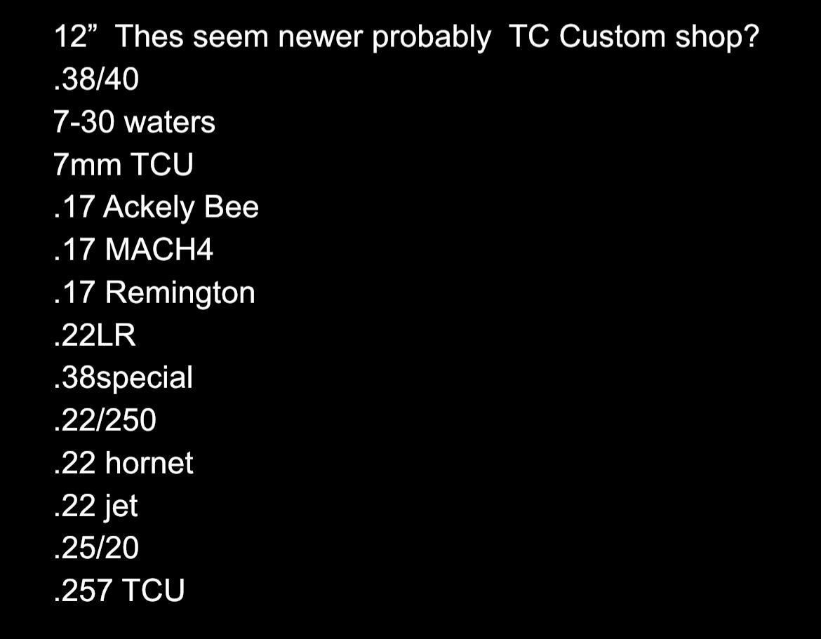

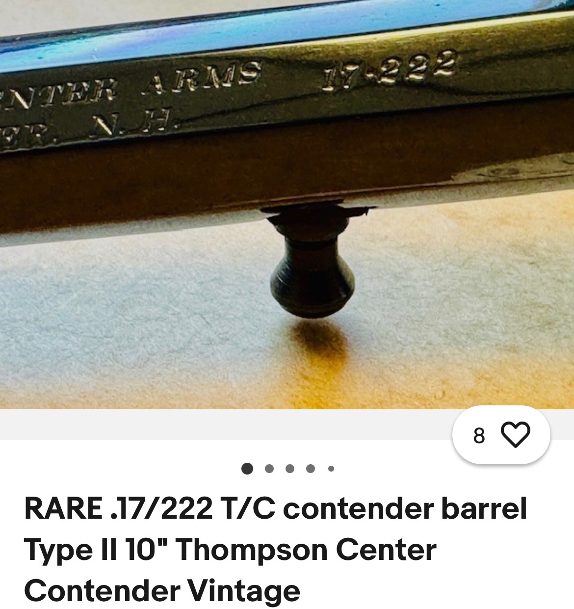

Someone listed 7 different .17caliber 10” Octagon barrels on EBay.
He says all are from 1967, I had no idea there were so many .17 caliber cartridges. Especially back then. I thought I had them all listed and one ebay listing adds 5 to my list.

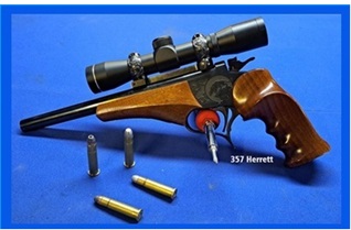

"The Contender french fit red cloth lined hinged wooden presentation TC boxes" that I've seen were commemorative Herrett presentation.
Steve Herrett designed the 30 and 357 Herrett cartridges from 30-30 brass to more adequately utilize the 10" barrels of the time.
Bob Milek was also instrumental in the cartridge's development.
I cannot speak to their value as 'the market bears to the buyers pocketbook' and the cases are few and far between
Herrett also designed the furniture and provided grip designs for quite a few handgun models.
