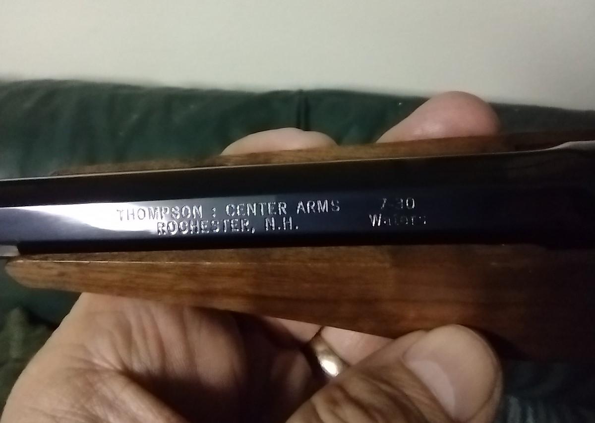

"I have a 12" octagon in 7-30 Waters"
I'd bet that this barrel is a Fox Ridge barrel,, not a factory offering. Or maybe one of the other custom makers like BullBerry, or whomever. It's not in any of the T/C catalogs.

Probably a pretty scarce barrel. Only one I've seen.
Thats 2 that seem to be uncataloged both 12”. I think I’ve seen a .218 BEE 12” Too.
I may well be wrong, but I’m guessing we’re overthinking this. Could it be as simple as they made 12” octagon barrels when they switched from 10” to 12” for the standard length?
Fox Ridge, T-C's custom shop offered non-standard barrel lengths, at least in the catalogs I have.
But, the catalogs I have all are later than the octagon era.
I would suspect that the 12" octagon barrel originated from Fox Ridge.
