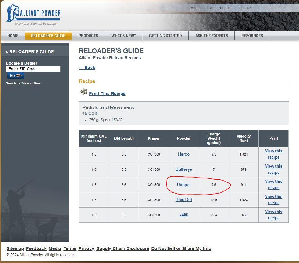

The closest data to your load is from Alliant's on-line reloading guide. According to their data with a 250 lead SWC the maximum load of Unique is 9.5 gr.
So you're well below maximum. The fact that your well below maximum is also evidenced by the black soot on the sides of the cases which is evidence that the cases aren't even expanding enough to seal the chamber walls.
I see the barrel length in that chart is 5.5 in. I'm shooting a 24 in. Will that increase the pressure? I wouldn't mind a little more velocity but dot want to stress the toggle links much. So I could go up to 8.5 to 8.8 area and if no pressure signs I would be ok.
Only if it benefitted me in velocity and accuracy.What do you think. My math is not that great anymore but at 8.5 gr that would put me at 90%
Of the 9.5 in the chart. I've never like max loads maybe I better stay where I'm at.
