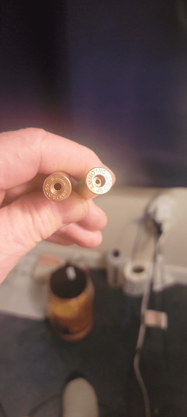

I got my starling 45LC brass. I reloaded 30 years ago alot of different calibers. So thing that bugs me. The factory ammo has a much smaller primer pocket hole than the new brass.The starling brass has a hole twice the size of the factory brass I've been shooting. Is this a safety concern? Never saw the hole that the primer shoots fire through that big.

Thanks let me ask ,,on the head of the starling brass it is stamped 45LC blank. Is that ok or did I buy the wrong thing? I wouldn't think so. Here's a pic of the two diff brass side by side

Are you 100% sure you didn't buy Starline 5-in-1 blank brass? That brass has a primer flash hole that is too large for safety in regular cartridge loadings. Everything else should be fine.
ETA: Just saw your reply on the headstamps. You bought blank brass, not brass for loading cartridges.
Blank brass has large flash holes so the primers don't back out with extremely light blank loads. They will eject primers with an actual bullet load and tie up the gun.

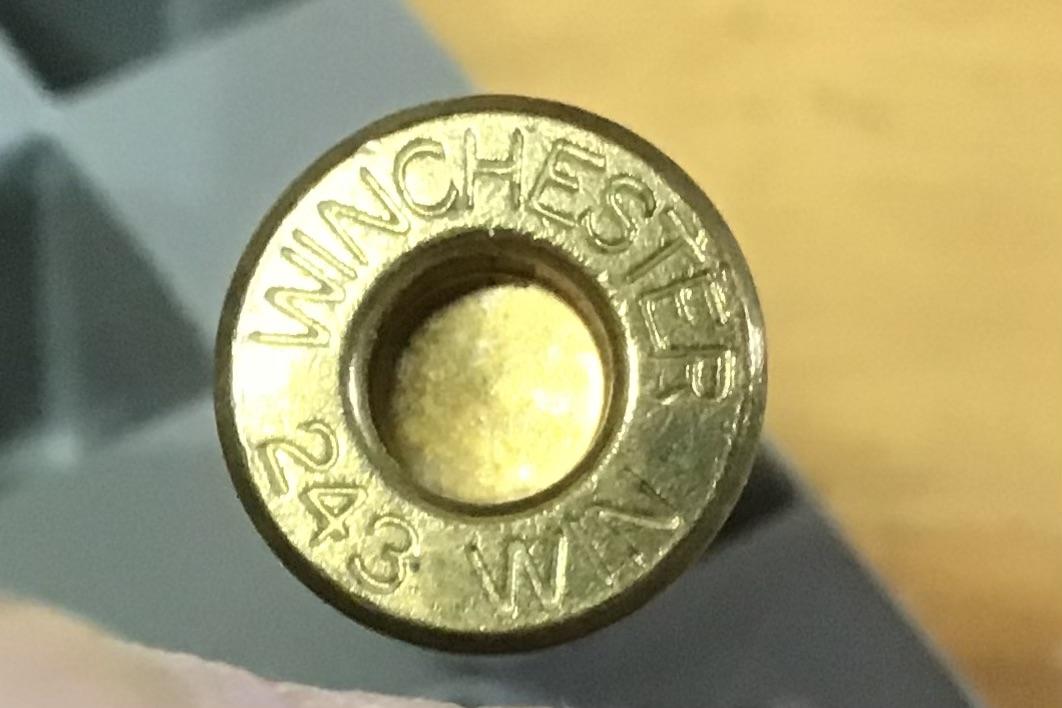

Here is a factory loaded cartridge without one, or a primer seated in the primer pocket.

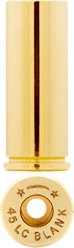

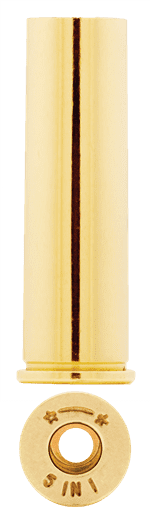

From looking at your pictures You DO NOT have 5 m-in 1 Blank which are a longer case so the will cycle in a lever rifle. You have 45 Colt Blanks ;) Check the wording on the case.
They would probably be OK with light loads similar to a Cowboy load. Load a couple and see what happens. If you are loading them for your new 1873 they will not lock it up?????????
The 5 in 1 is a general blank case that is designed to feed in lever action rifles. It is the same length as a loaded cartridge in 45 Colt, 44-40, 38-40 and 44 MAG and will chamber in all
Your picture
Yours kinda look like this one

"Here is a factory loaded cartridge without one, or a primer seated in the primer pocket."
I found one of those in a bag of new factory 6.5 Cr brass last year. Set it on the shelf as a reminder to LOOK at every piece of brass before doing anything else. I have a collection of broken depriming pins for proof of this importance. :poop:
