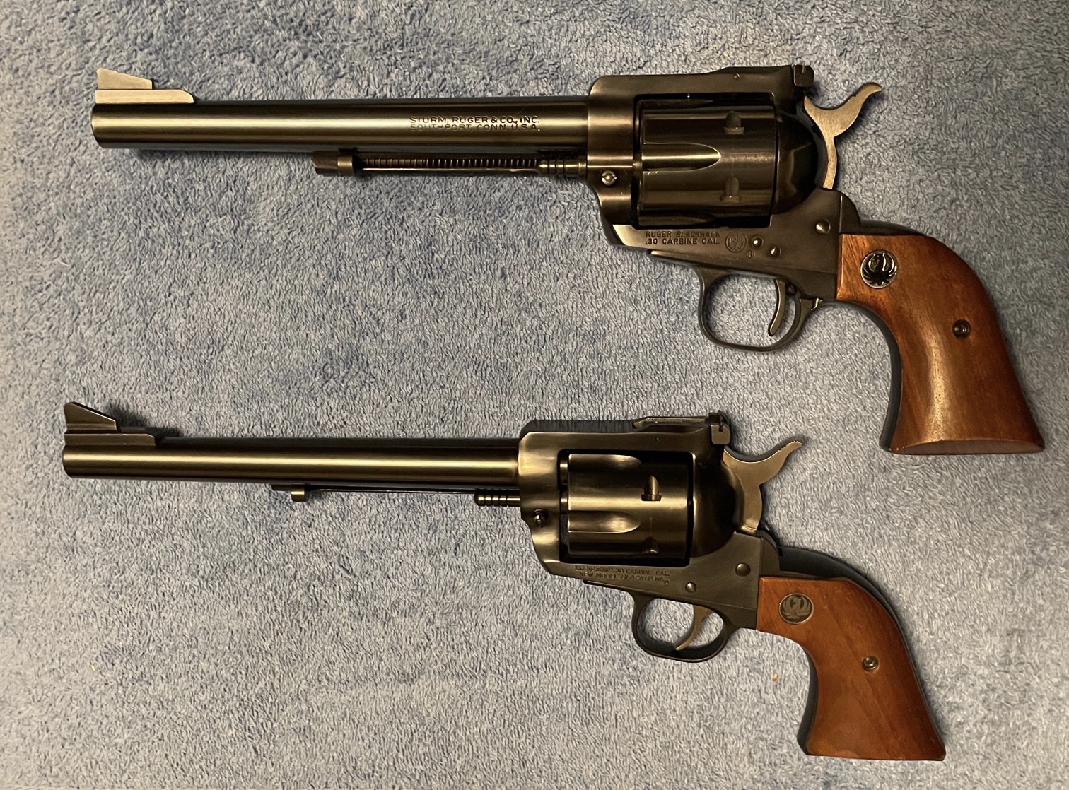

I have a pair. Love ‘em, everyone should have one 😉

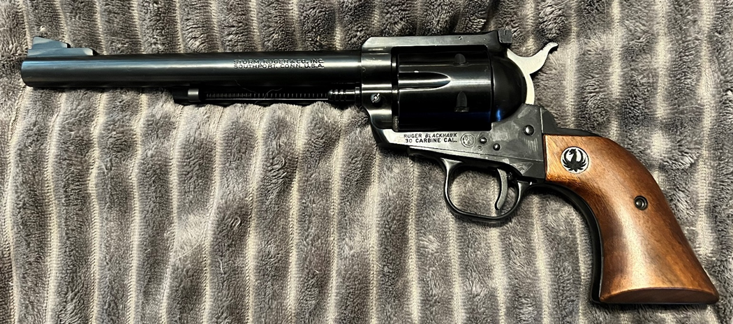

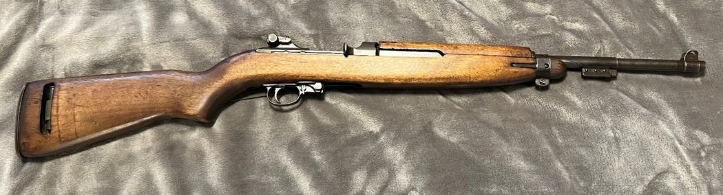

Mine are a first year (68) four digit Blackhawk with original numbered box and paperwork and a (42) first year Winchester M1 carbine. Both are very accurate and fun to shoot. Yeah it’s loud but what I really like about the Ruger is the fireball when you shoot it.
