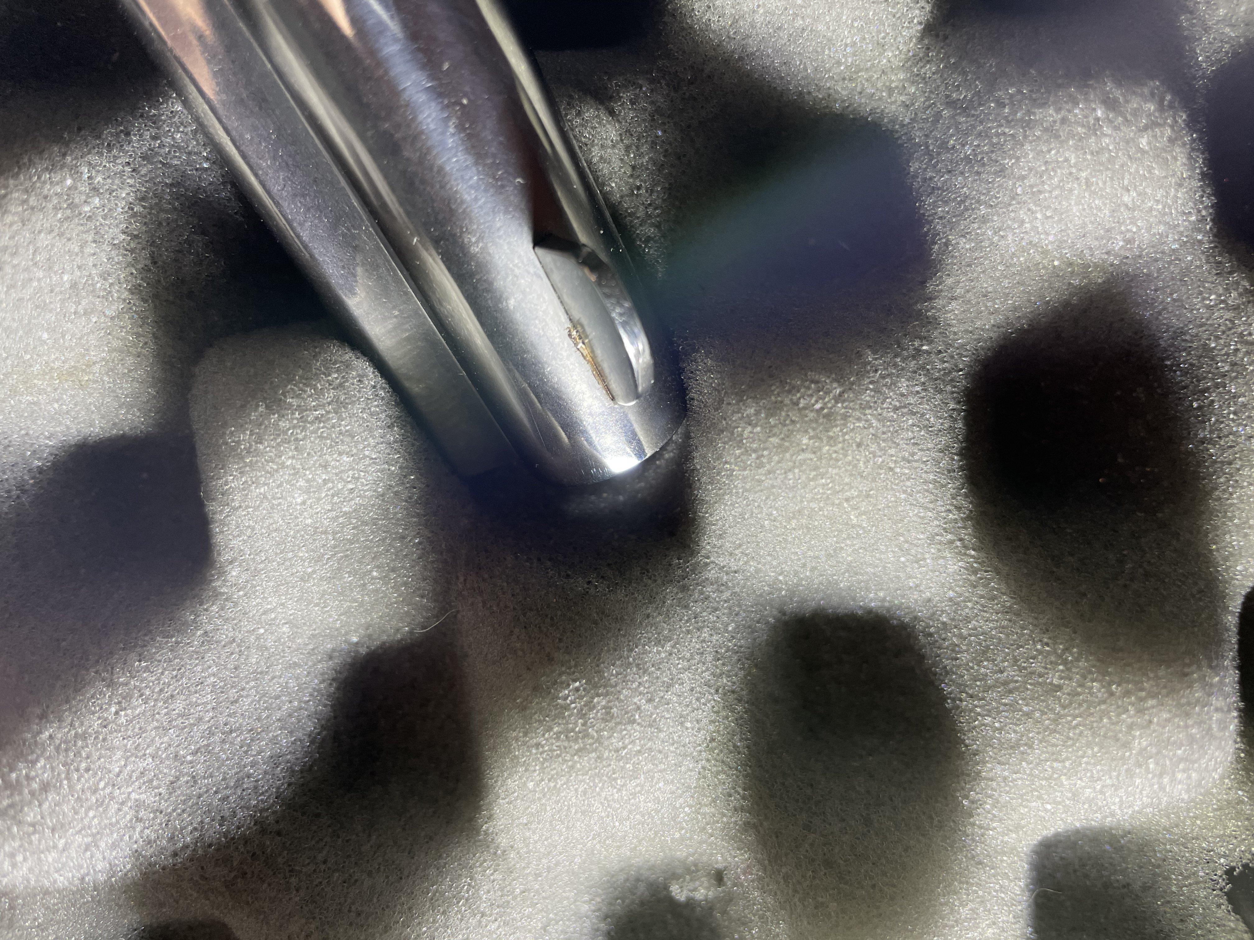

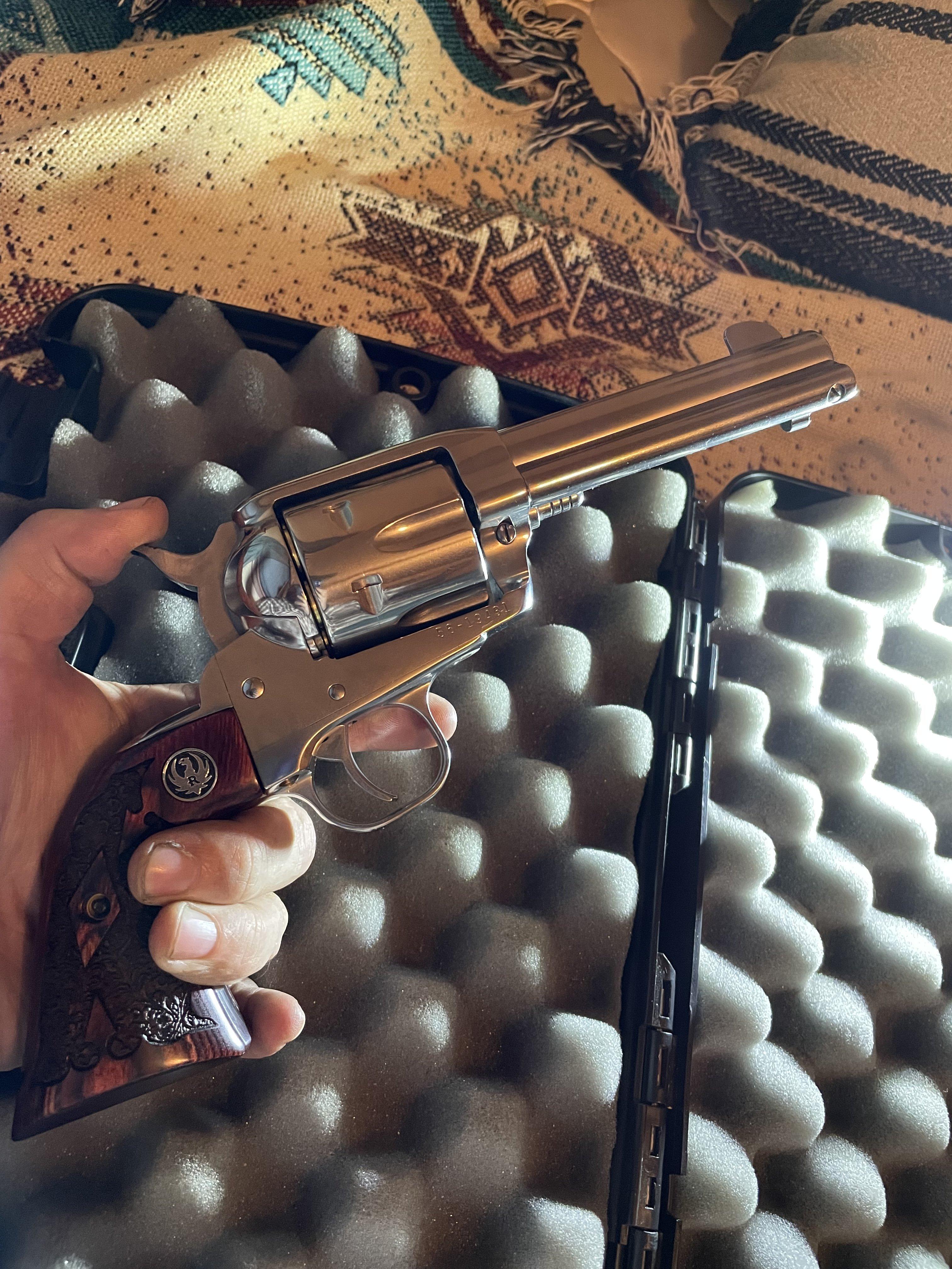

Recently I traded a nice Model 19 S&W for a Stainless OM Vaquero 45LC.. he paid me 200 in boot but once I finally got the pistol in my hands I felt uneasy about it. It looks a bit abused dispute the fact he told me she has only seen 100 rounds. But I love the western six guns and after all my years as a soldier and law enforcement I am certain they are the best choice for most any scenario. So I made the deal. After I got home I noticed some interesting solder and discoloration on the front sight post and the rifling doesn’t look so sharp.
I figured I would take it to a gun smith and have a brand new barrel put on as well as any upgrades available. Is this even possible? What do you gentlemen think about the looks of it? My goal was an accurate shooter. And I would pay over 1k to any gunsmith that can make her a shiny pantie drop’n western nail driver. 😆
Sorry I don’t have better photos.
I’ll post a better picture of the rifling tonight. I haven’t shot her yet. Just got it.
First thing, check the throats in that cylinder. Ruger’s are notorious for a .450-.451” throat openings. All of my Blackhawk’s and Vaqueros were tight. Open to .4525 -.453” with a reamer. Big accuracy improver.

First off, give that gun a good cleaning in the bore. My computer/internet is slow enough that I can't see any pics yet. But,, often,, a bore can appear worn,, when all it really needs is a good scrubbing of the LEAD,, that has accumulated in it.
Next, the front sight & the solder. GENTLY see if it's loose in any way. If not,, it may be ok.
BUT,, if the solder is weak, or the sight loose,, a POLITE call to Ruger can often get you a pre-paid shipper, for them to look it over. They may replace the barrel too if they find an issue.

Ok, my internet is better in the mornings, and I can see the pictures.
Nice one for sure.
Give it a good cleaning,, and then shoot it. You may be surprised. And if you have access to a set of pin gauges,, you can check the chambers yourself. if not,, as mentioned,, the (2) members I mentioned,, can easily check things & uniform them if they are not a true .4525 size.
