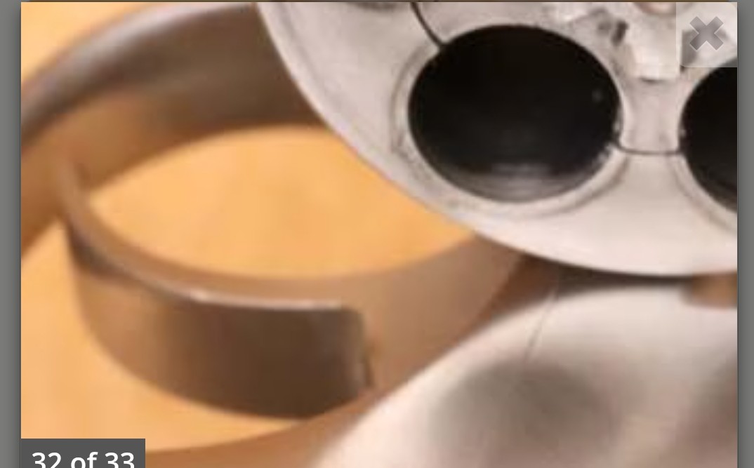

Parts breakage is rare on a Ruger revolver. The complaints that I see/hear are regarding assembly not the quality of the parts. The most common complaints are:
The barrel canted a hair.
Chambers that didn’t get a great job of polishing.
Excessive barrel-cylinder gap.
End shake.
Ill fitting grips.

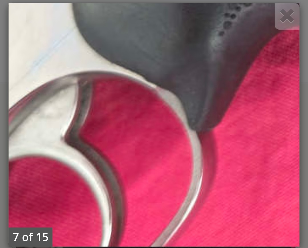

There was a time when if you bought a GP or SP you'd have to check to make sure the barrel was not rotated too much making the front sights off. Don't know if this is still an issue but I've carefully checked all that I have purchased. I had some pretty sharp edges on a stainless SP trigger guard. Some time with some emmory paper worked it out. As with any firearm purchase check it out before yea take it home. It's a manufactured product built to tolerances and it might not be prefect out of the box. Sure QC is supposed to take care of issues but not all QC is top quality. Same goes for all manufacturers.

Here are examples of both. Pics from GB ads.
