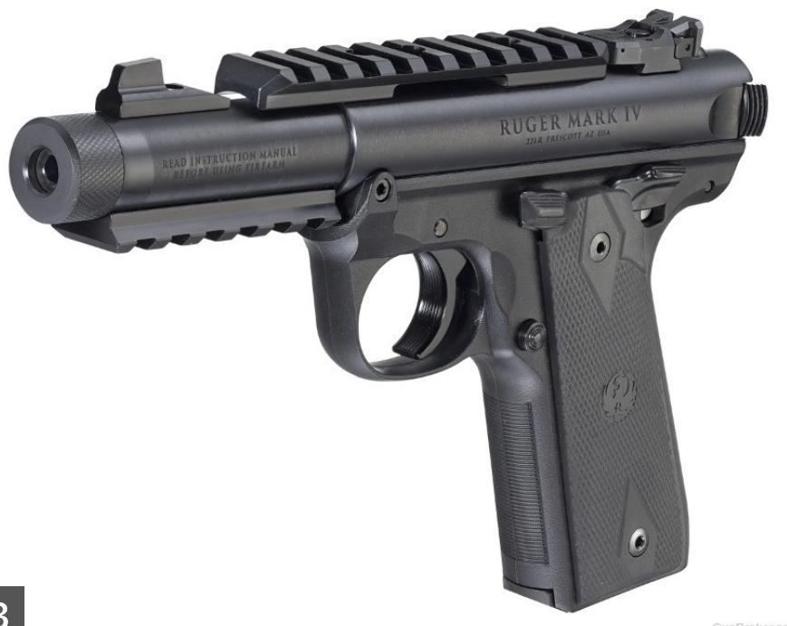

I took another look at some reviews, and as far as I can tell without holding a sample, this model has a solid barrel. Could easily remove the rails and front sight, chuck the upper up in a lathe, and either turn off the threads or cut the whole threaded section off in a few minutes. Much easier than my recommendation on the other models. I'd guess the charge would be for 1 hour of machine time, ~100$.
Threaded section will be about .4 inches for normal applications of this type. You wouldn't lose any length if the threads were turned down as opposed to cutting and recrowning.
ETA: Adco Firearms is well known for their barrel threading service, you might get in touch with them and see if they will offer an "unthreading" service for a similar price. A bit different since you can't legally own it until the service is performed, but worth a try.
Thanks again, NikA! This is the pistol I am referring to. Yes, would prefer not to shorten the barrel, if possible. Now, if I could only find a gunsmith to do this…
