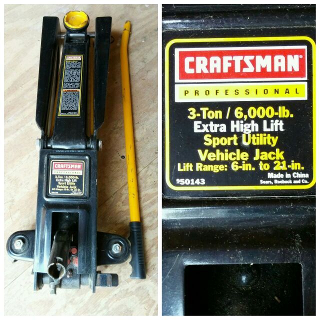

Anyone know about hydraulic jacks? I have been looking for a cheap jack to have in my daughters car. Her rockers are rusted off so figure the factory jack has nothing to lift on HAHA.
Anyway I got given to me a 3 ton Craftsman extra high lift jack PN:950143. Seemed to work just pumping the handle so I was stooked.
Fast forward, we were changing the brakes on her car to get it ready (bought cheap knowing it needed work) and it wouldn't lift any weight?
Google led me to conclude fluid was low. Got some hydraulic fluid from a guy at work and tonight filled it up. I topped it up and jacked it up and down. filled it some more and jacked it up and down. Added more and jacked until I felt it should be good. corked it off and tried to lift a car.... nothing.
Any ideas?
Looks like this:
https://images.offerup.com/cNzNnXU7...0/photos/6633f80d590244ac9b40c145b23422e1.jpg
I didn't see any leaks but it was pretty empty. Even after filling I didn't see anything leaking.
But yes.... free. HAHA
Looks nice so I really don't want to scrap it if possible to fix.
Yes I tightened the screw that lets it down.
I think I bled it correctly. All the videos I've watched say leave the lift screw open and pump the jack as if trying to make it lift.
Is there a nut screwed into the body of the jack, where the pressure release screw in screwed in> is the up/down screw threaded into something you can remove?
If you can remove it, try changing Orings in that area.
Did you rotate the handle clockwise until it stops, then pump the handle?
Counter-clockwise all the way releases the hydraulic pressure and it lowers on its own.
Clockwise all the way, then pump it to lift.
If it’s got fluid and its handle is twisted all the way clockwise and still doesn’t lift, I have no other idea but replace it.
