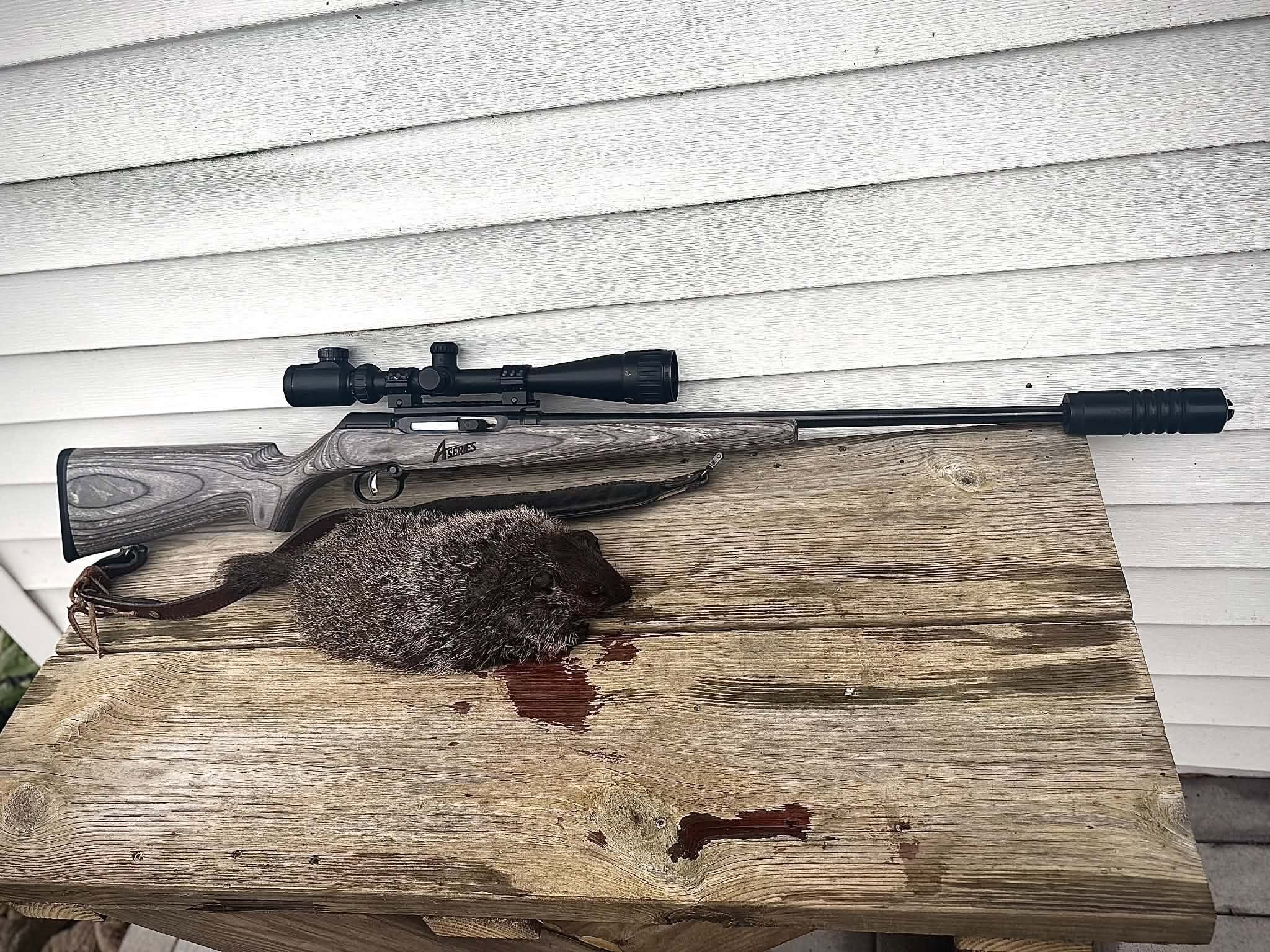

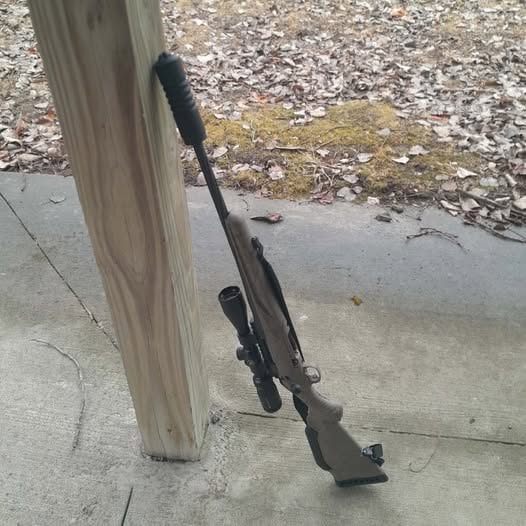

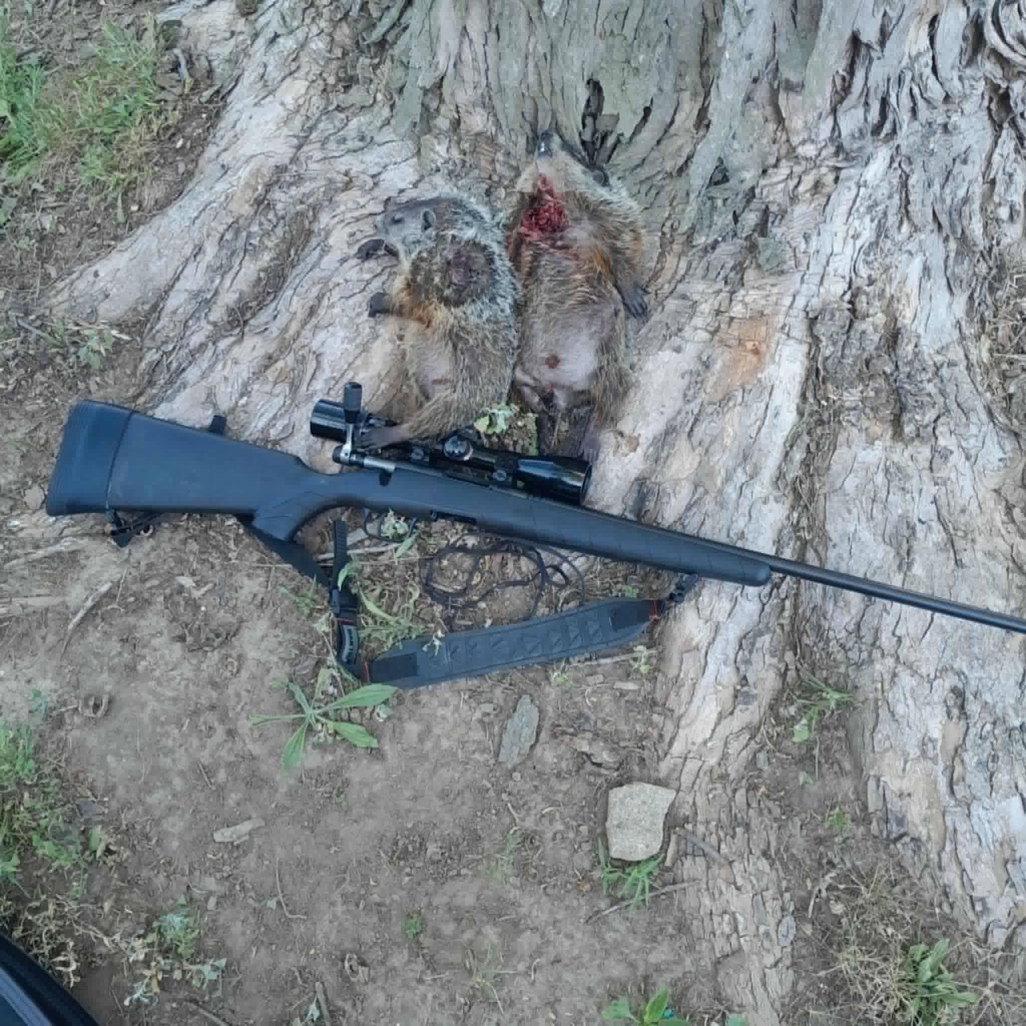

So, I found this online ...............I have three rifles I shoot suppressed and they all are very accurate.
