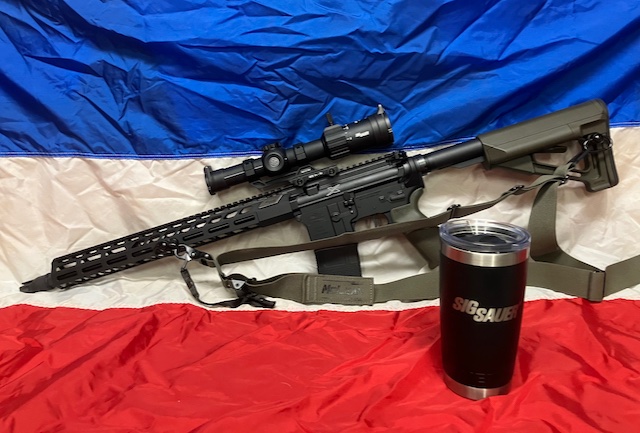

Since this came back up I have to admit I have no need to carry this rifle just wanted a sling for it... I also explained in my post in a different thread titled my $1300 yeti mug why I bought the sling I did.... two reasons... one, I already had two on my pistol caliber carbines and the other is the company offered one in the same color as the grip and stock of this new AR... also the sling is made here in the U.S.A.
McLean Sling in Ranger Green:
