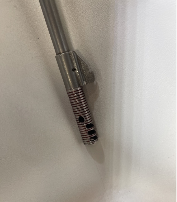

purchased a 196 that has a comp on it i want gone , its not budging and looks to have red lock tight between the FSB and comp that squeezed out when it was installed , it has a small hole underneath that looks to have a broken off set screw in it , either way threaded or not im dremeling it off this weekend since i can get it to budge with reasonable
force
First I'd get a penlight and see if you can see a set screw or something else. You can try putting small (and increasingly larger) allen or flat screwdrivers in to see if anything fits to loosen what may be in there. If you determine there is a screw in there, but can't get it out, I would drill it out, you'll only hurt a few of the barrel threads. I would then put the barrel in a padded vise and heat the compensator with either a heat gun or a butane torch to melt the (Loctite ?) and grab the compensator with a large pair of vise grips see if it moves at all.
looked at it with the magnifier app on my phone , definitely what ever type of head the screw had on it its been broken off , i will try drilling it before the dremel
drilled the set screw remnant , scored the compensator a few times , touched some heat , got it to turn , realized it was not threaded and put a punch through the holes of the comp and gave it a few wacks and it popped right off , just ordered a 1/2 x 28 RH die and thread starter , only had the setup for AK , so will thread it Wednesday

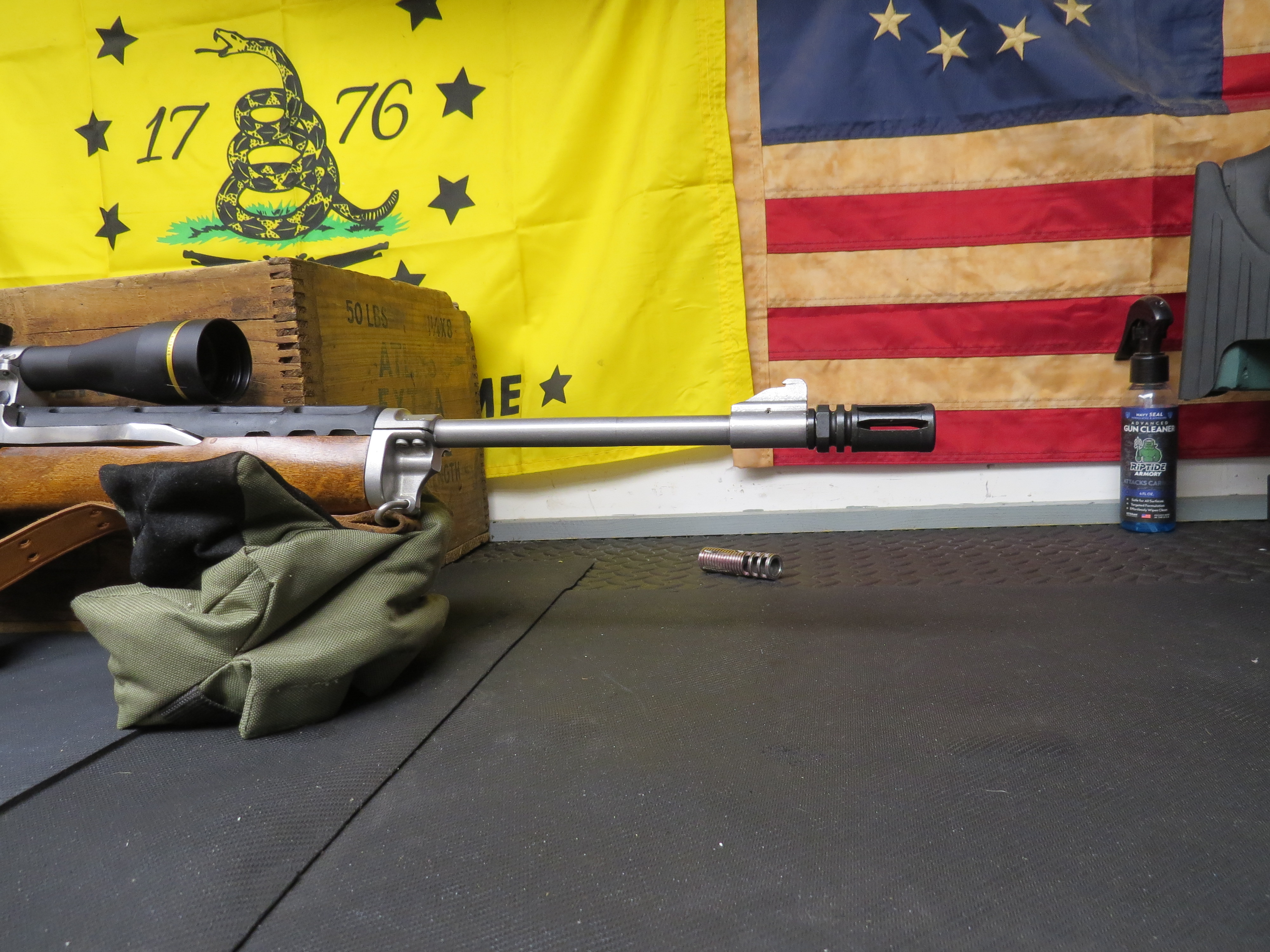

well i was going to get the m14 muzzle device and the m1a rear sight , but they were sold out of the muzzle device so i said screw it and reverting back to the original plan ,just thread the muzzle and factory flip rear

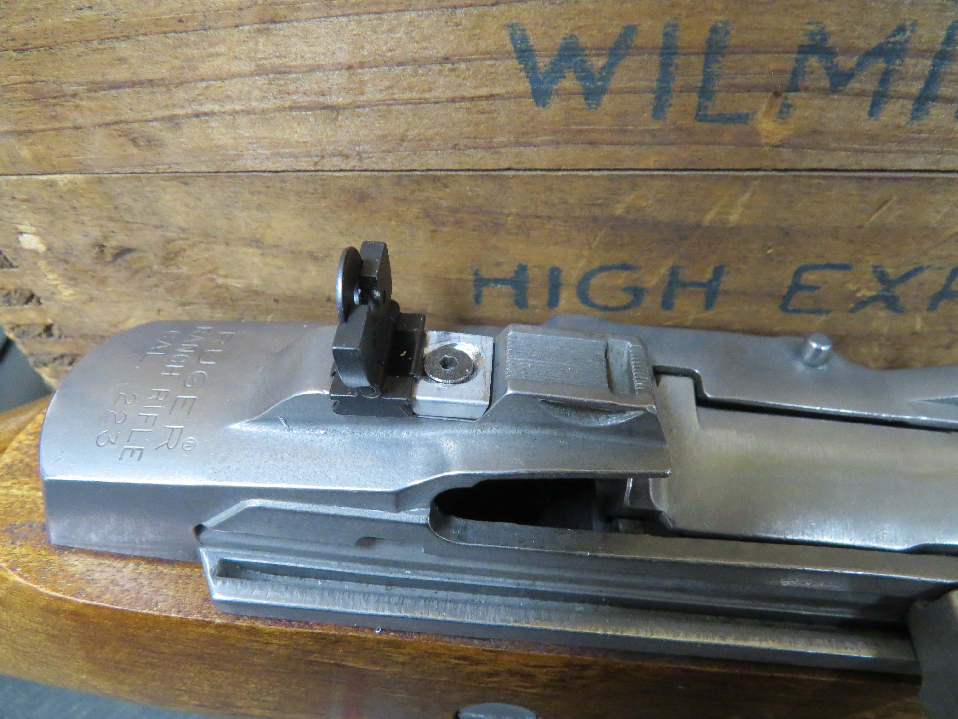

project is coming along nicely , the rear sight was missing , arrived today , evidently there is a piece called windage lock plate thats missing , the screw was there , it has to be the flip down so it will not interfere with the scope so not interested in tech sights , these will be backup

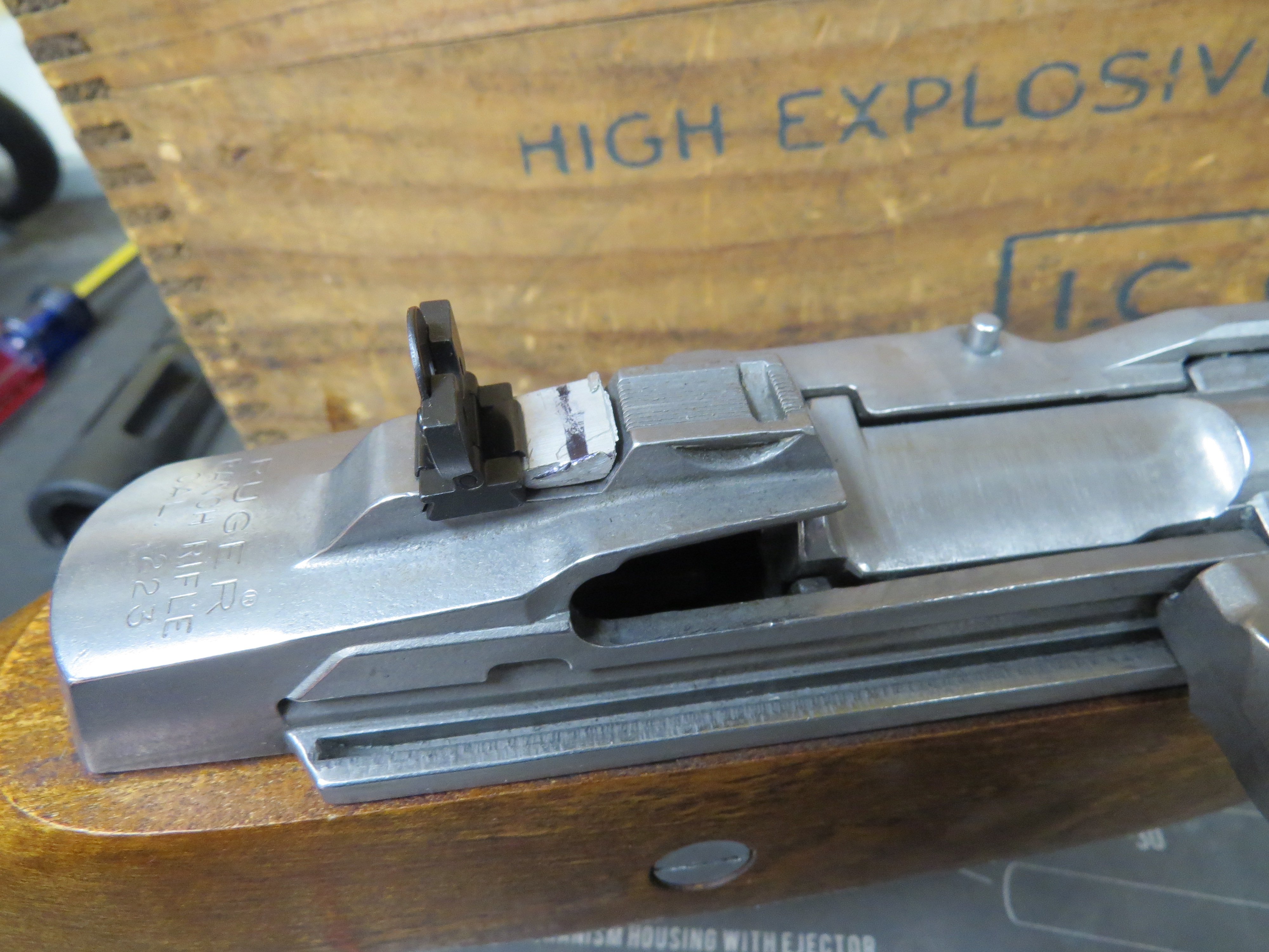

cant find that windage plate anywhere , scoured the net , so looks like i will have to fabricate one

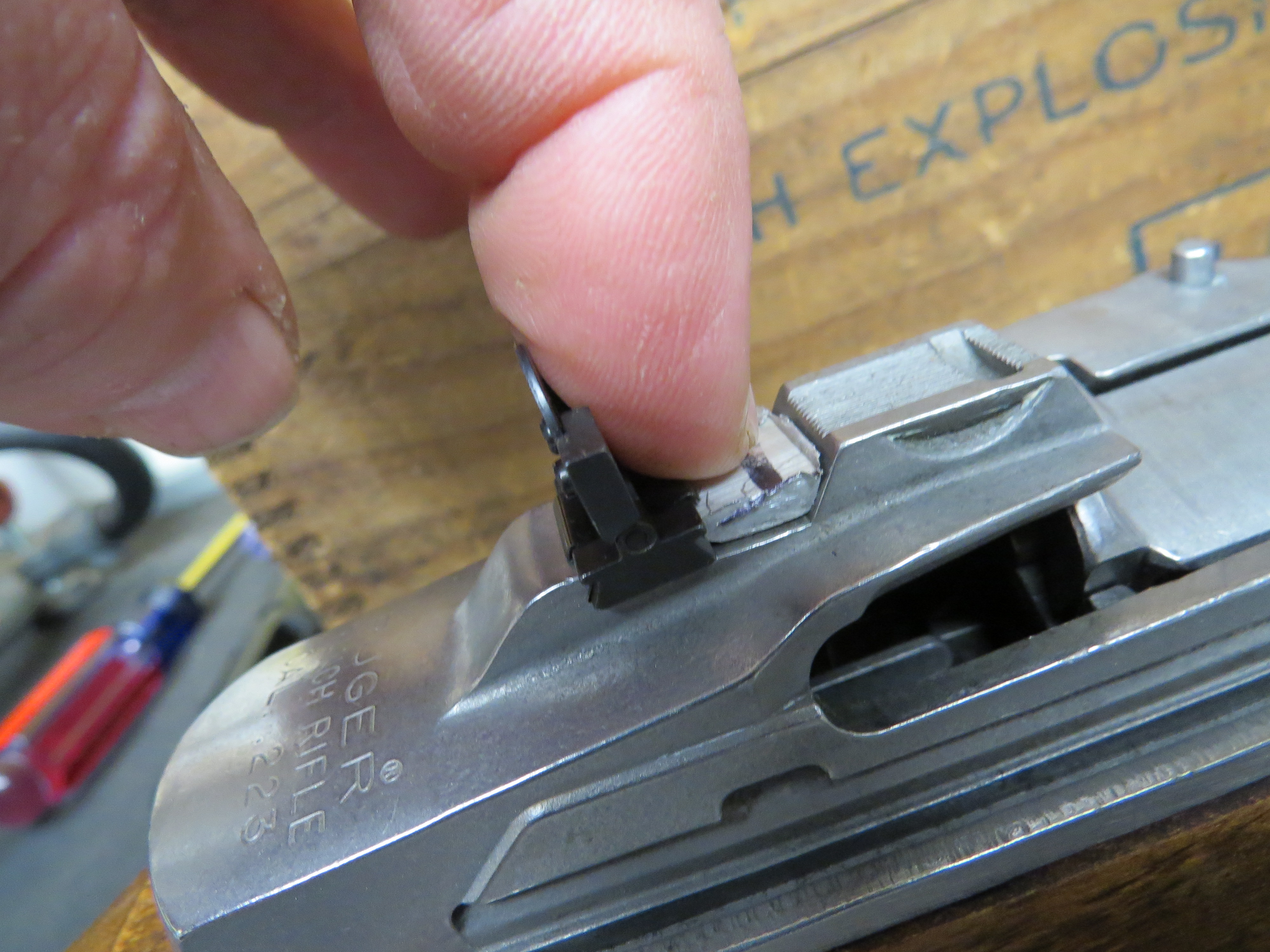

have the rough fit , need to clean the edges , drill the hole , countersink the hole, and finish will probably be paint , it actually seats just right , it was hard to hold everything together correctly with one finger , operate the camera and get a decent photo , once the screw cinches it the sight will not move and the locking block seats flush
has it clamped hard , cleaned up around the screw head with JB Weld , once it cures i will back the screw out , clean it up and spray black

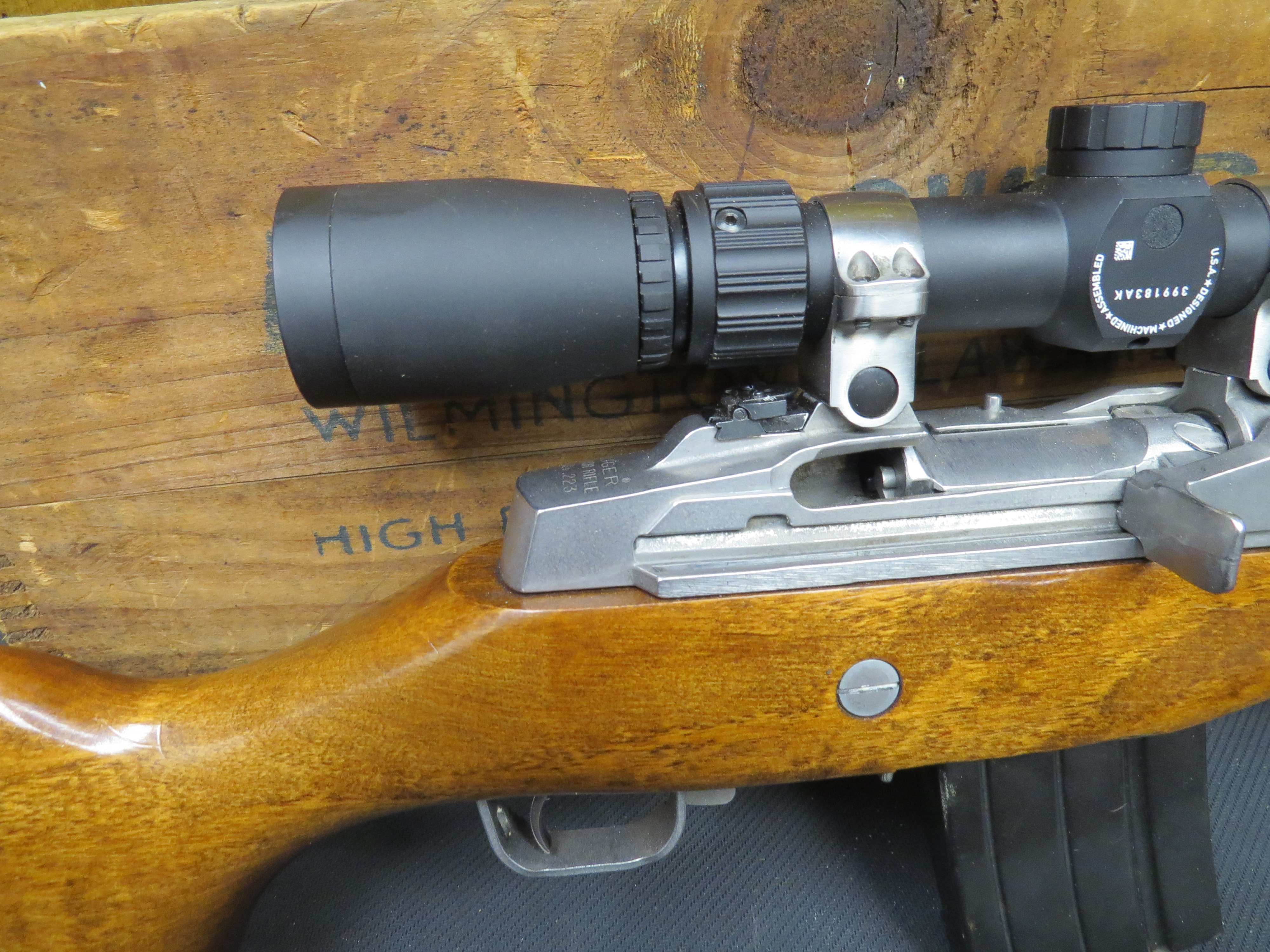

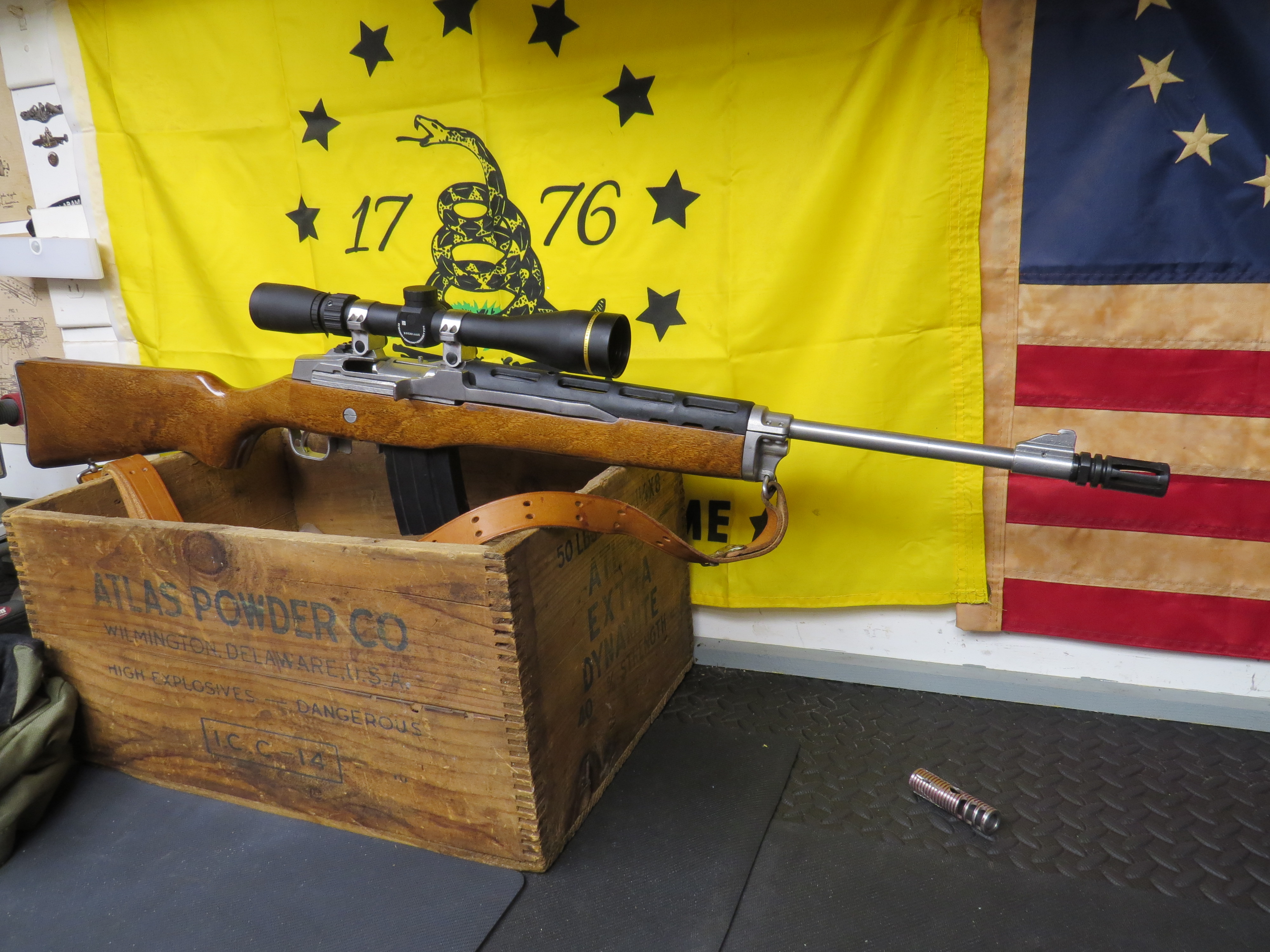

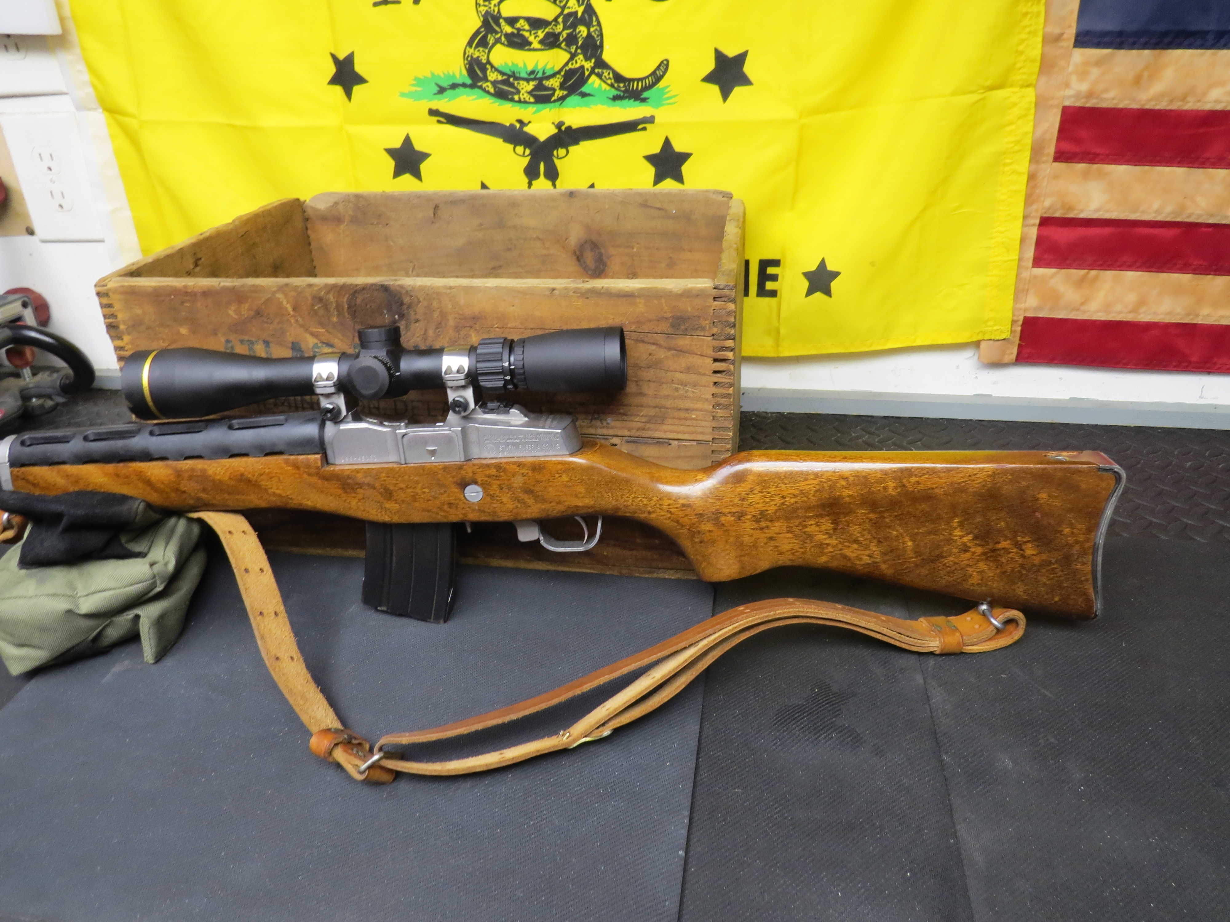

i have a Leupold VX roughly installed , still need the flash suppressor , should have next week , once thats in hand i will thread the barrel , bought a Choat handguard , when i went to remove it the clip pulled off and was still stuck to the barrel , bad mash on the rivit , emailed them and they replace free of charge , Choate is amazing

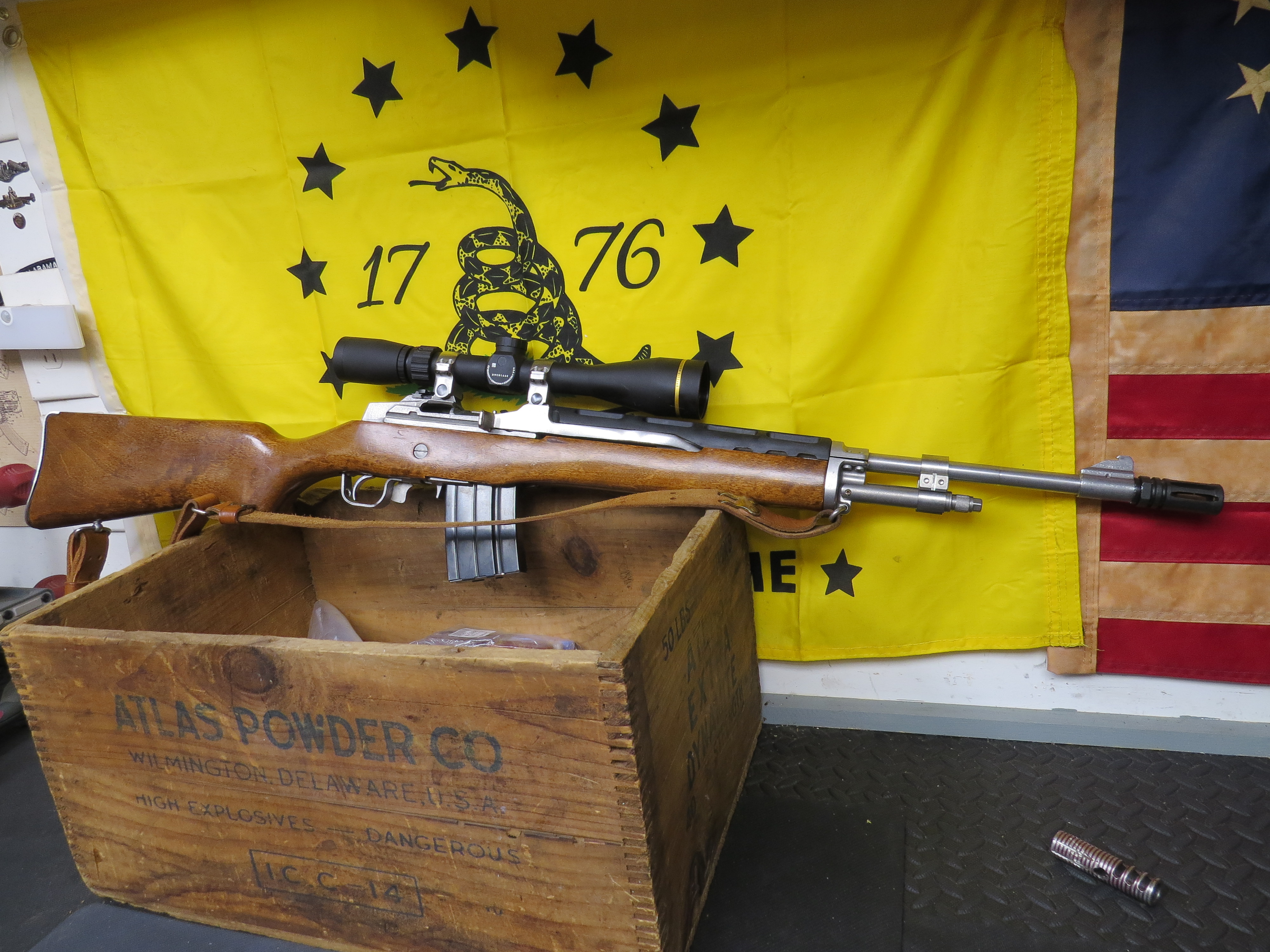

so im close to having it finished , thinking about a stabilizer

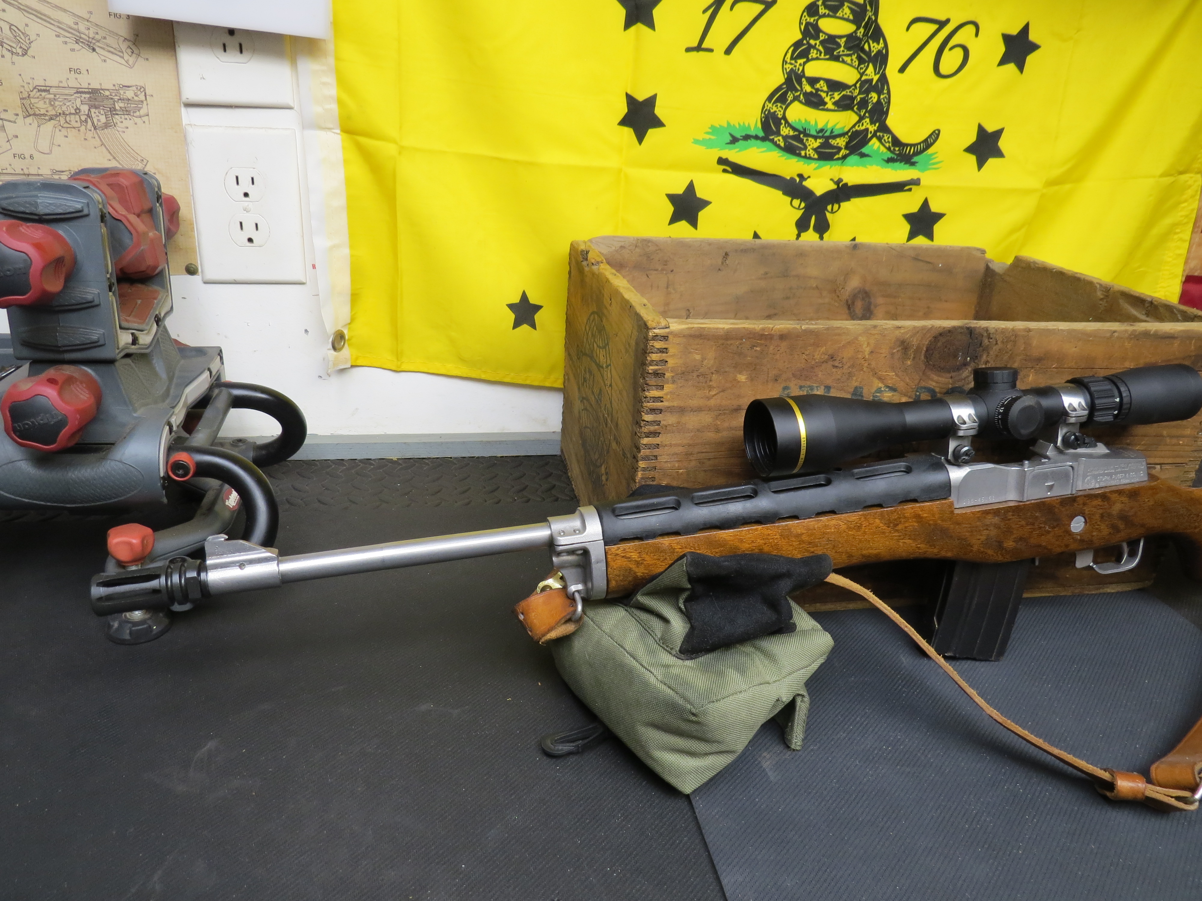

before and after , strut should be here by saturday , went with a Bravo Company extended bird cage threaded the barrel i think it was thursday , went with some black to contrast some of the stainless suppose to warm up this week so maybe the 4 inches of ice will go away and i can set the shooting bench up and sight it in
