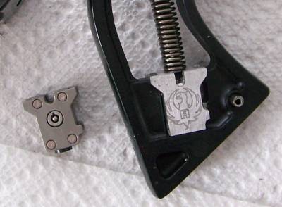

My 2015 production Single-six did not have the internal lock. I have one question of those that do have the lock, do you think it has affected the action?
1. They do not affect the action.
2. The locks were eliminated in 2012.

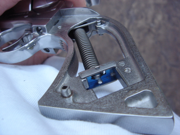

3. They are easy to eliminate by replacing them with a mainspring retaining plate from the Bearcat (the standard plate is too short):
Shown in the Bearcat:
4. Or make one:

Or do like my son did for me with a cnc machine back when... Hasn't failed yet on a several of my revolvers. Easiest of course is just to buy the bearcat plate. Probably could even 3D print one now...
    17.8 KB
I just have never owned one with the lock and I didn't know if the shorter spring would change the stacking or feel of the hammer spring, if that makes sense?
