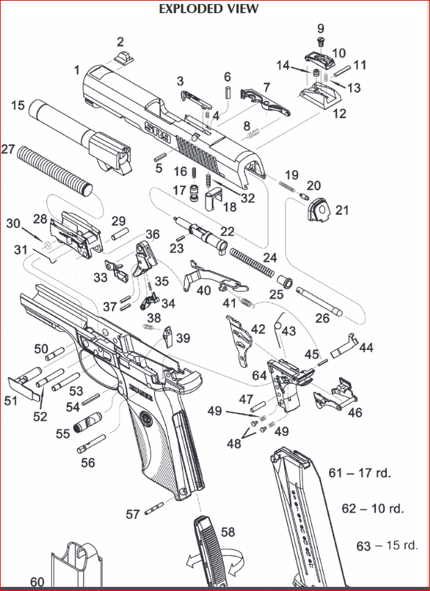

SR9-Part 40
From Taurus website-Here shows the trigger bar after take down. Notice the Author mentions just cleaning a polishing. (Taurus GX4)
