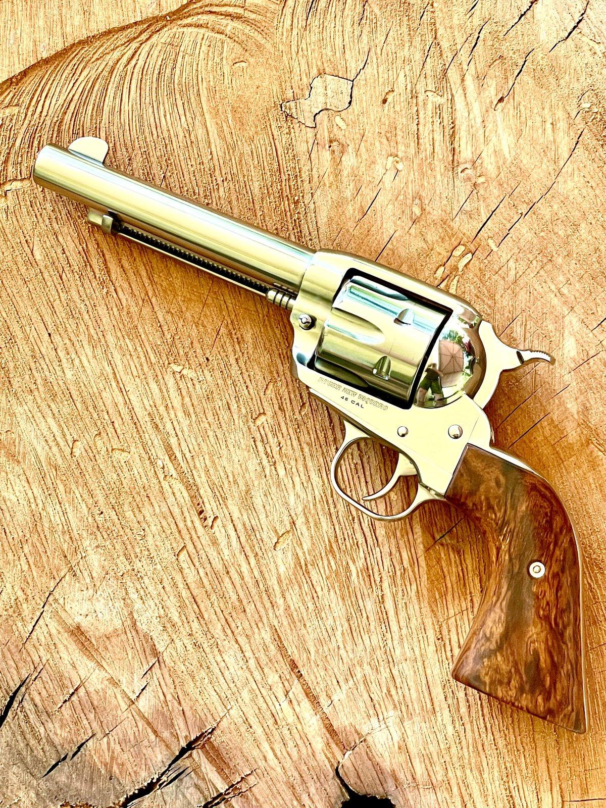

Super Hunter on New Vaquero.

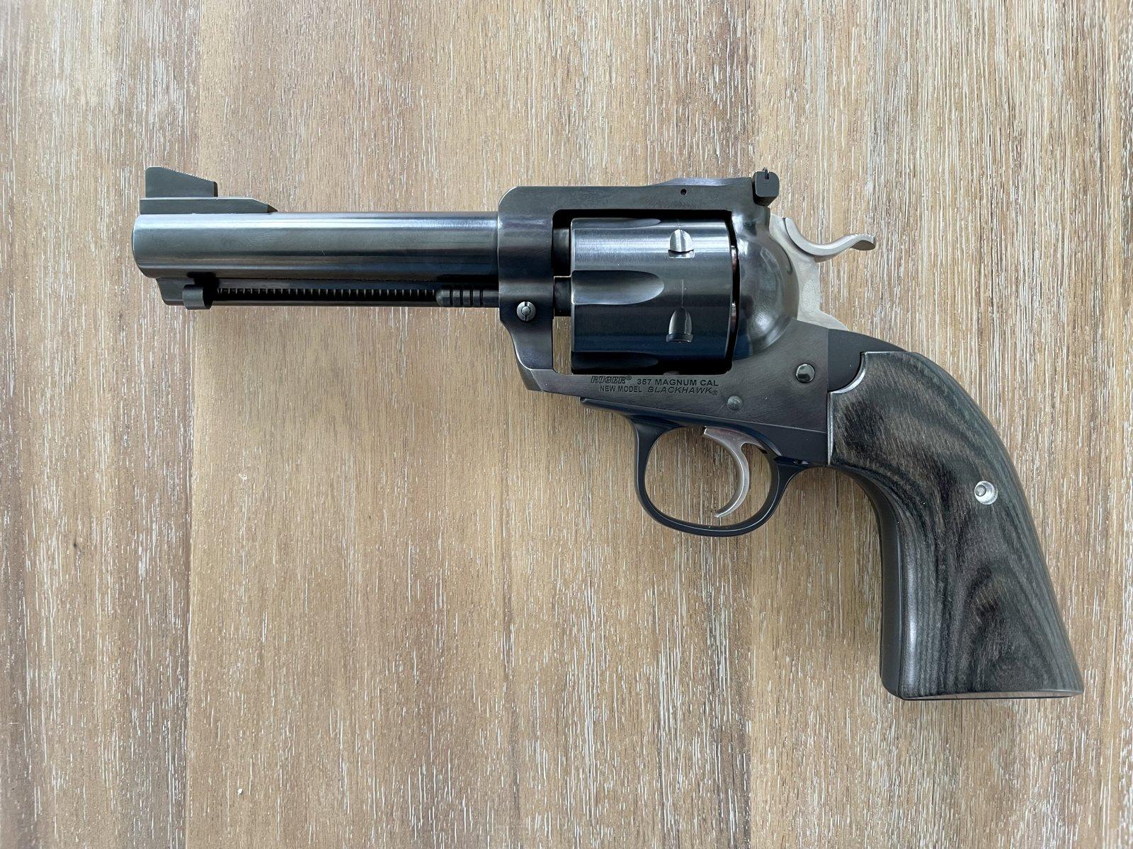

Bisley on Blackhawk, just to illustrate fit by hammer.

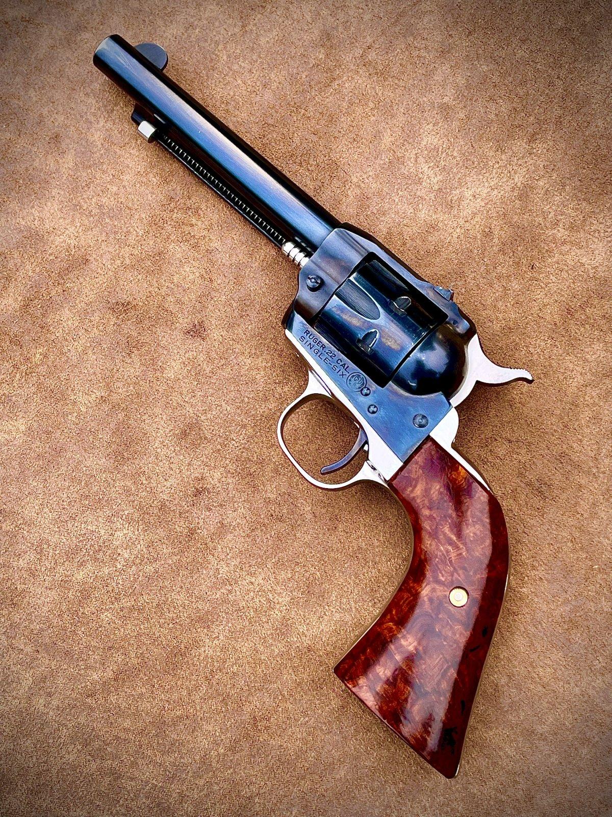

Super Hunter on OM Single Six.
